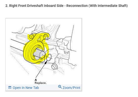

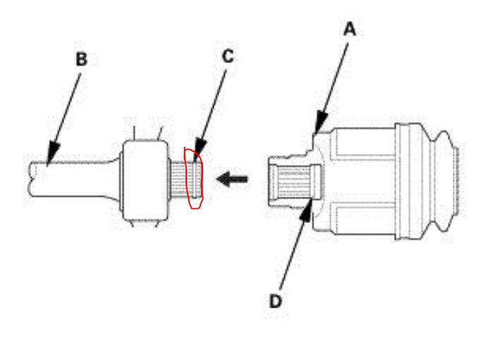

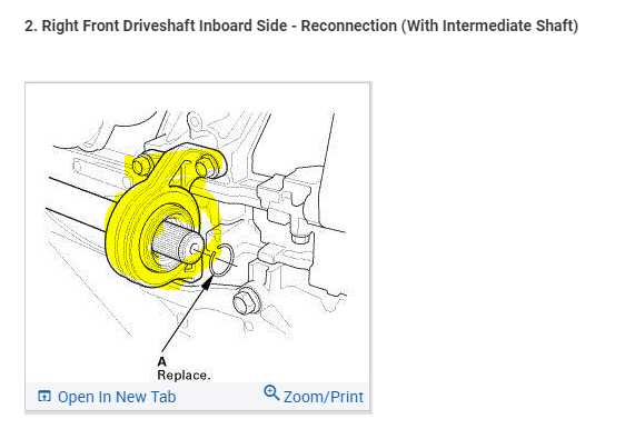

If the problem just started after the CV joint was replaced, I suspect something was assembled incorrectly.
When you indicate a CV joint, was only the joint replaced or was the axle/CV joints replaced (half shaft)?
As far as the right side, there is an intermediate shaft bearing that may not be properly tightened, put together, or you may have gotten a faulty joint. Actually, there is a possibility the locking clip between the intermediate shaft and CV joint may not be locked into place.
Are there any sounds associated?
I attached a pic of the intermediate shaft bearing. Make sure it is tight. Also, inspect where the two join and see if there is any evidence of it being loose.
