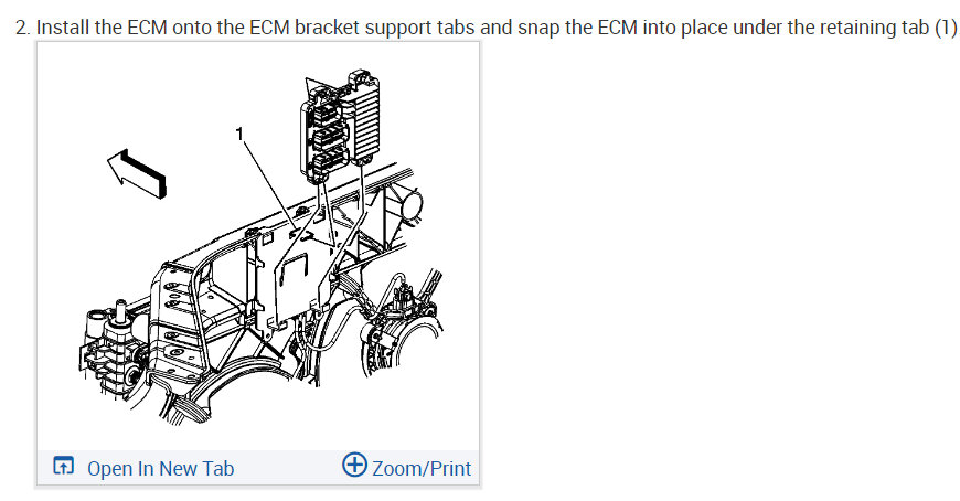

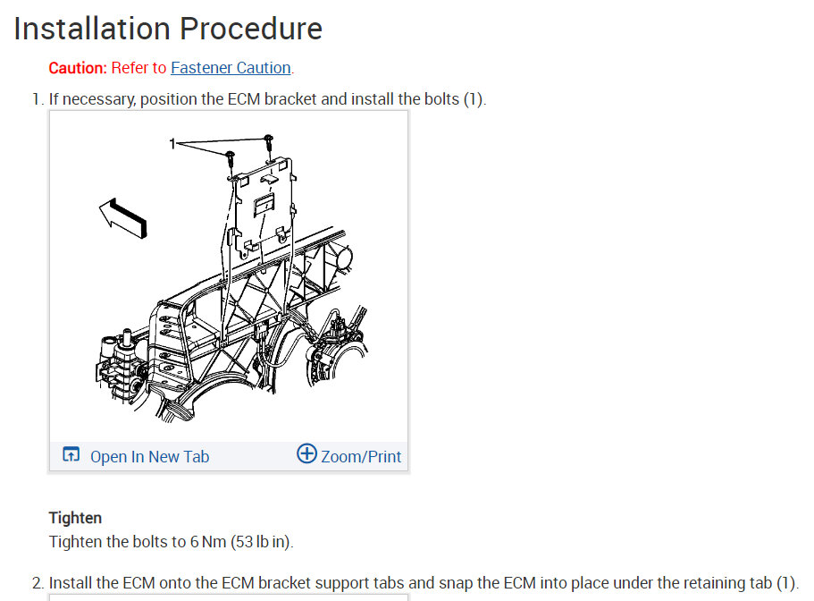

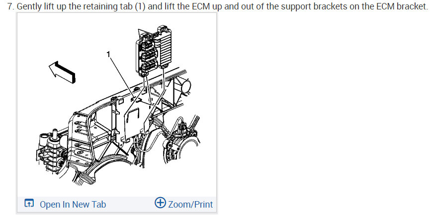

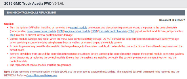

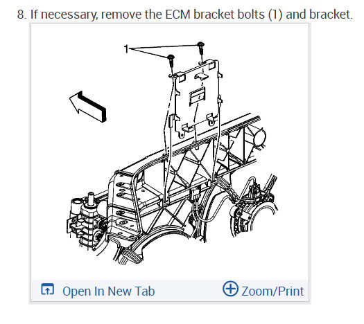

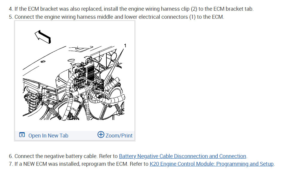

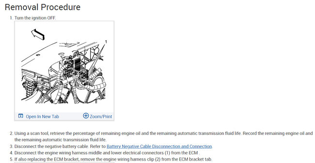

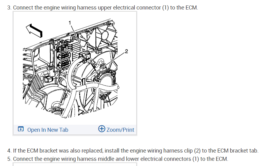

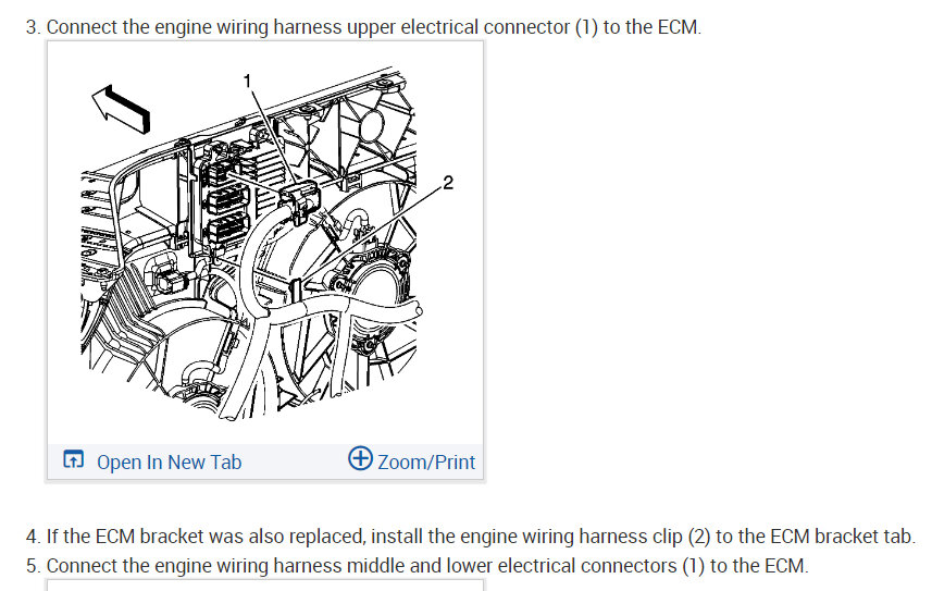

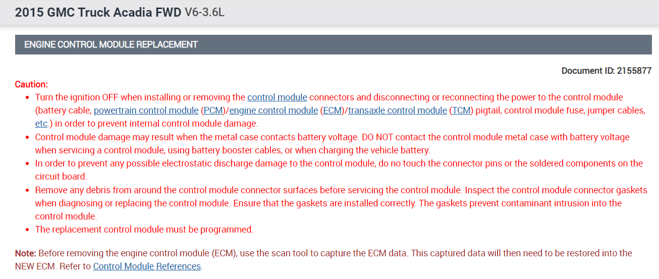

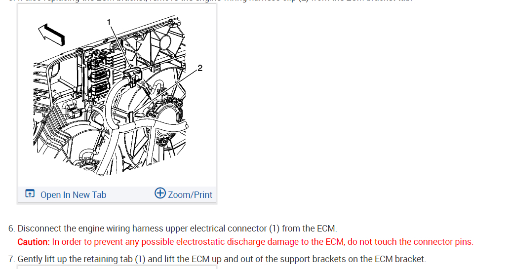

https://www.2carpros.com/articles/how-to-replace-an-automotive-engine-computer-pcm-ecm-ecu-a-comprehensive-step-by-step-guide
Here is how to change the PCM out in case you need it, you can get a preprogrammed unit by searching Google or Ebay. Check out the images (below). Please upload pictures or videos of the problem so we can see what's going on.
