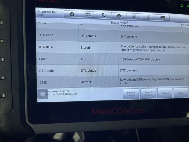

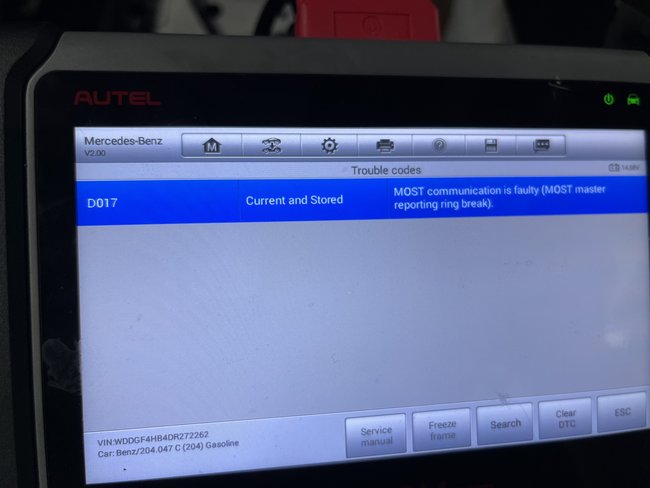

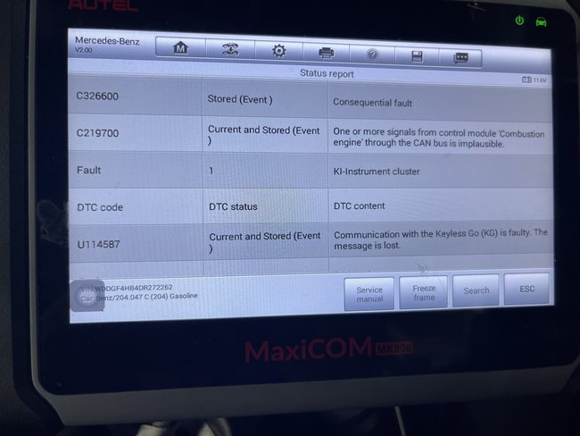

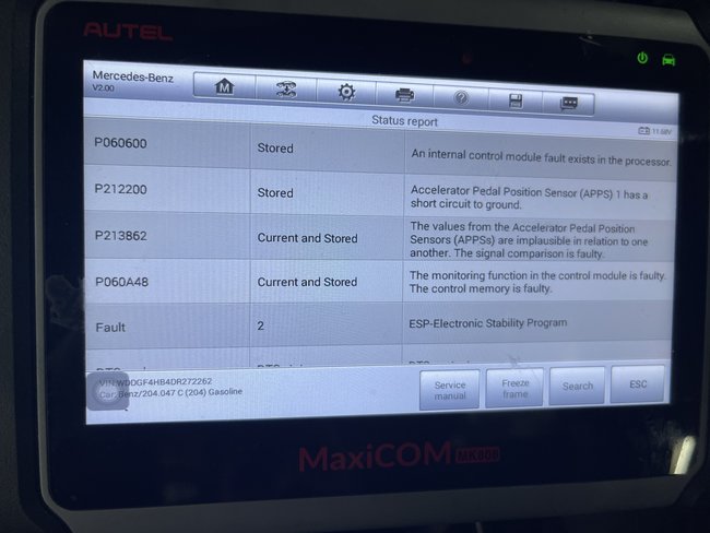

Sunroof inoperable, same for driver side set, traction light on, no throttle response
DIVIDES
  • 898 POSTS

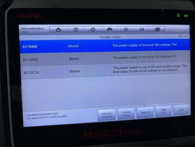

This is after I started it and turned it off.
Monday, May 16th, 2022 AT 3:51 PM
KEN L
  • MASTER CERTIFIED MECHANIC
  • 48,363 POSTS
Yep, this shows a bunch of electrical problems. It looks like the wiring harness could be bad or one of the SAM modules is still having an issue. You might want to try and leave the battery disconnected overnight to see if that does anything.
Tuesday, May 17th, 2022 AT 9:50 AM
DIVIDES
  • 898 POSTS
Okay. All the wires look good, none are torn or showing corrosion, but I will get an electrical cleaner and spray them all and see.
Tuesday, May 17th, 2022 AT 9:51 AM
DIVIDES
  • 898 POSTS
Replaced the gas pedal and sprayed all wire connectors and breakers under the carpet with electric cleaner. Started with no check engine light or traction. Throttle now solved. Most codes are gone. Deleted most and most were gone. Seat, sunroof, power tilt and radio sound still inoperable. First pic was from SAM module, deleted them and they gone. I think the battery was low.

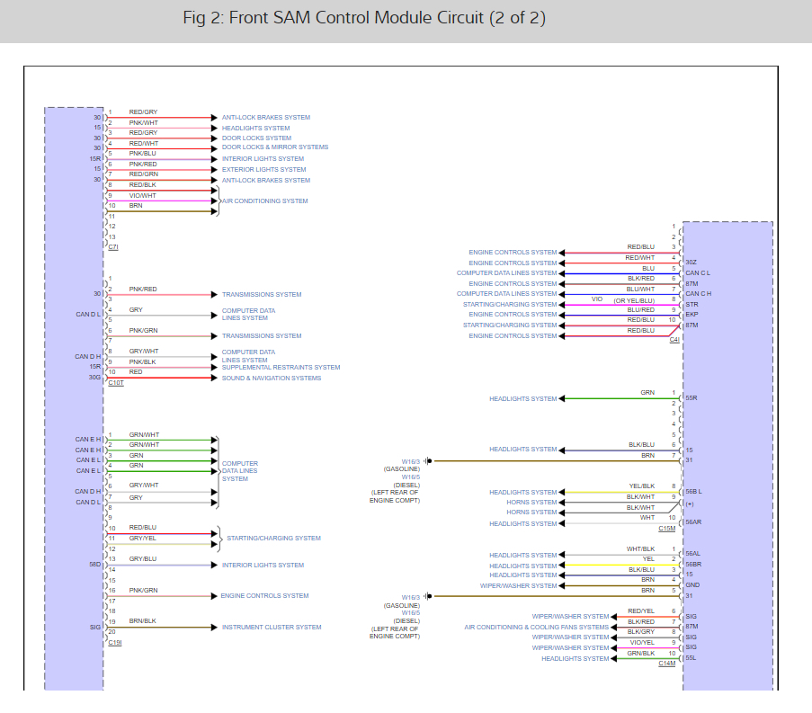

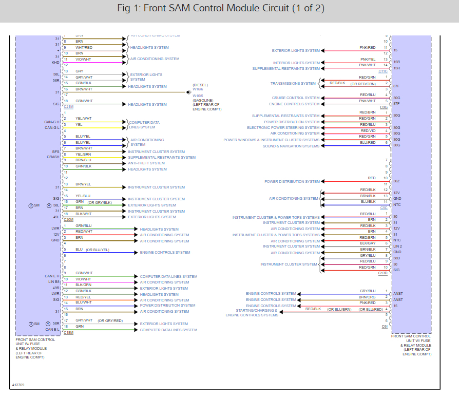

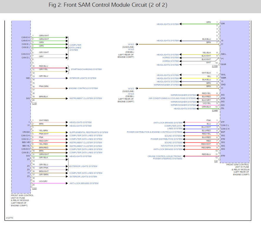

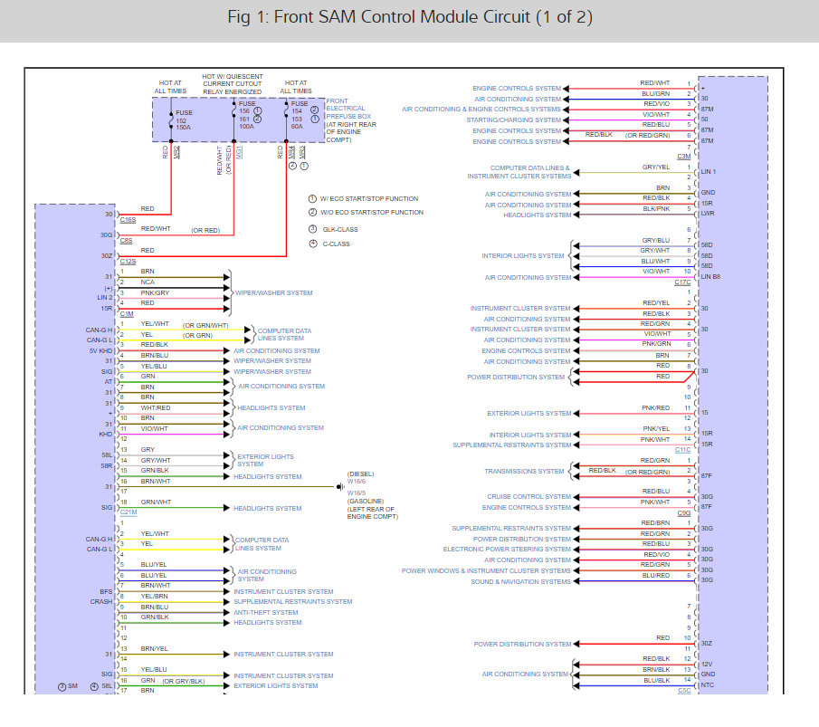

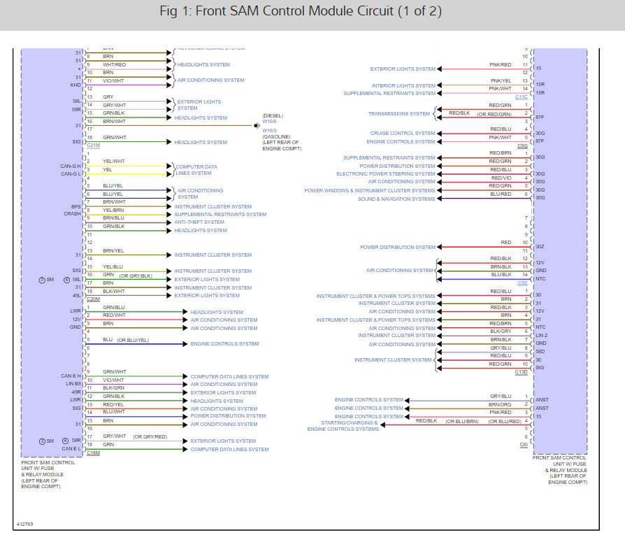

Can you send me the wiring diagram to the front SAM module? I need to find a way to connect this big red wire where it doesn't come loose as the connector was so difficult to remove it broke the plastic connector around it, so I can now connect it but an sure at any point it will come loose. I can't find the plastic connector sold alone so I will need to find a way or replace that wire, just need to know where it goes
Thursday, May 19th, 2022 AT 9:21 AM
DIVIDES
  • 898 POSTS
Also, where the fiber optics equipment so I can try to bypass it using the bypass tool?
Thursday, May 19th, 2022 AT 9:32 AM
KEN L
  • 48,363 POSTS
Here are the front SAM module wiring diagrams and a guide to help you do some checking:

The roof motor replaced, and sunroof now works. Is there any way you can find out for me the location of the modules like the telephone module, radio module, amplifier so I can try to bypass them and see if one is causing the sound issue.
Tuesday, May 24th, 2022 AT 11:27 AM
KEN L
  • 48,363 POSTS
Not that I know of.
Friday, May 27th, 2022 AT 2:10 PM
DIVIDES
  • 898 POSTS
Sound fixed. Underneath the passenger floor by firewall on bottom behind the metal plate is a connector, bypassed it and all is good now. Only thing left is the power driver seat and power tilt.
