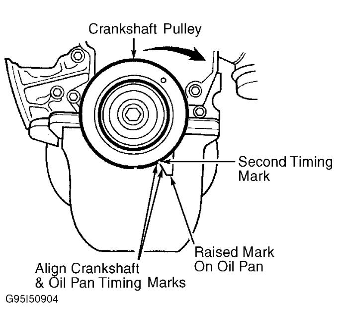

Had to replace the water pump and to do that timing belt had to be removed and the camshaft gears turned on me and don't know where I need to set the marks at on the camshaft gears I know # 1 cylinder should be at TDC but not the camshaft gears .

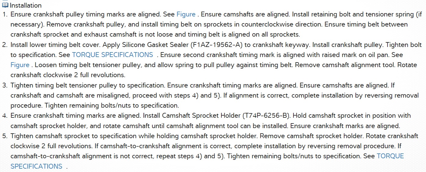

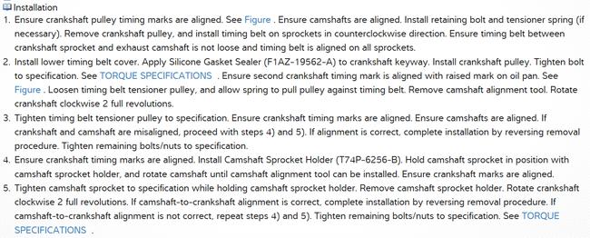

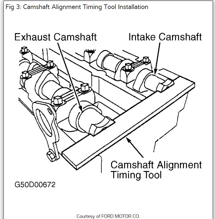

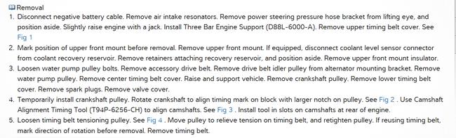

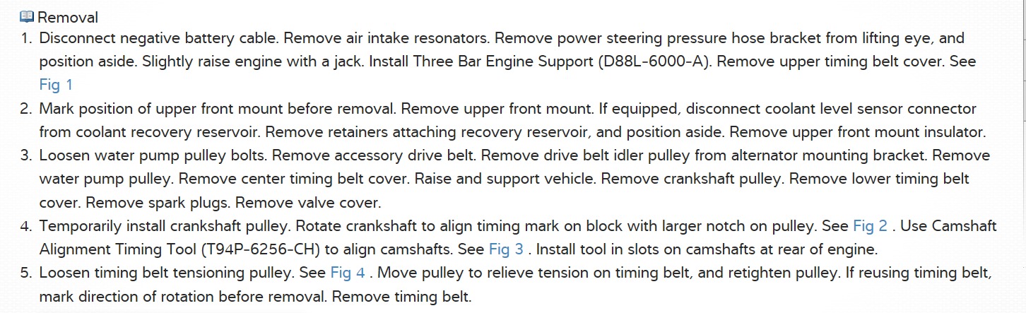

see pics, you can damage the valves by moving cams or crank.

Thank you very helpful but is there any way to set it by hand

nope unless you line up back of cam with a straight edge.

So once I take the valve cover off how do I go about setting the camshafts with the straight edge .

the pic pretty much shows how to do it. both of them have to line up like the pic.

Thank for all your help took the valve cover off set the cams by hand by looking at the pic put it all back together and it started THANK YOU AGAIN !
