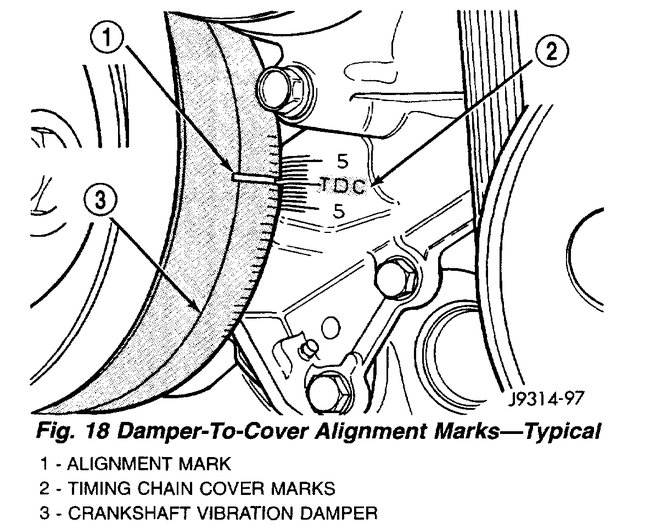

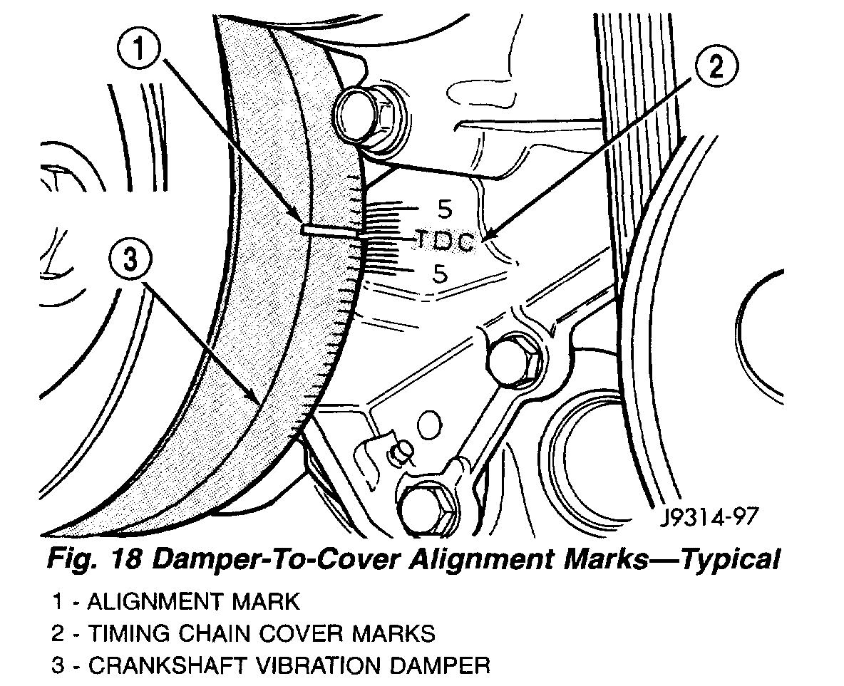

Fig.18 Damper-To-Cover Alignment Marks - Typical
Picture 1
7. Slowly rotate engine clockwise, as viewed from front, until indicating mark on crankshaft vibration damper is aligned to 0 degree (TDC) mark on timing chain cover.

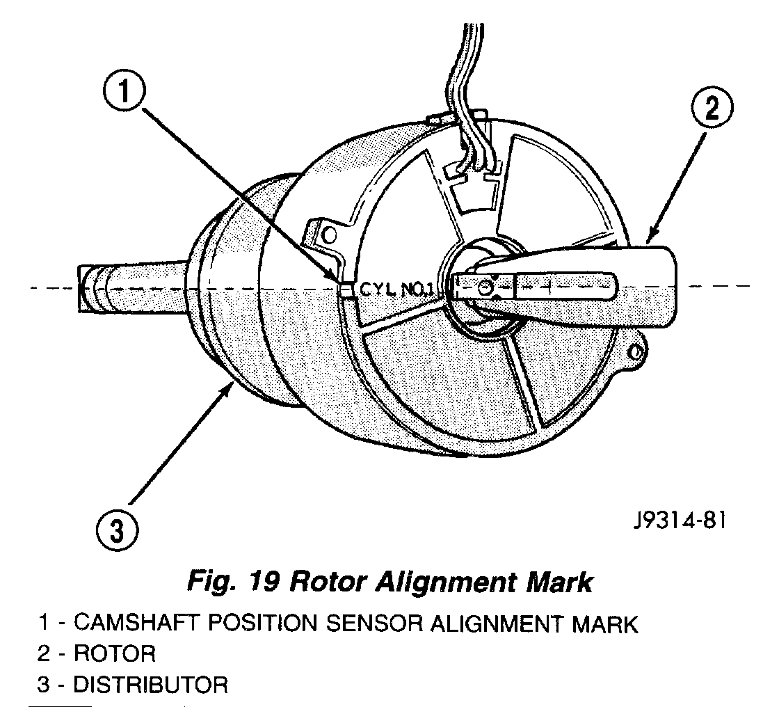

Fig.19 Rotor Alignment Mark
Picture 2
8. The distributor rotor should now be aligned to the CYL. NO.1 alignment mark (stamped) into the camshaft position sensor. If not, rotate the crankshaft through another complete 360 degree turn. Note the position of the number one cylinder spark plug cable (on the cap) in relation to rotor. Rotor should now be aligned to this position.

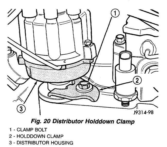

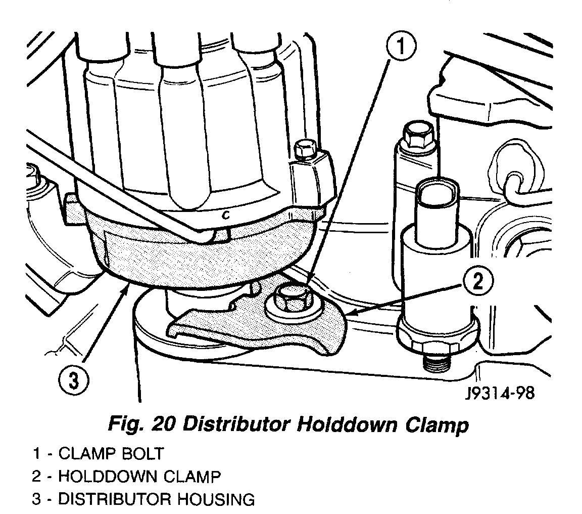

Fig.20 Distributor Holddown Clamp
Picture 3
11. Remove distributor holddown clamp bolt and clamp. Remove distributor from vehicle.

4. Position distributor into engine to its original position. Engage tongue of distributor shaft with slot in distributor oil pump drive gear. Position rotor to the number one spark plug cable position.
5. Install distributor holddown clamp and clamp bolt. Do not tighten bolt at this time.
6. Rotate the distributor housing until rotor is aligned to CYL. NO.1 alignment mark on the camshaft position sensor.
7. Tighten clamp holddown bolt to 22.5 Nm (200 in. lbs.) torque.
