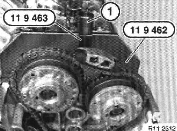

Setting crank to TDC to complete timing chain guides rails etc. replacement one vanos gear is loose went to rotate crank to set TDC and one cam on 1-4 didn't move set TDC on 5-8 and crank. when am I able to manually rotate cams on 1-4 freely without hitting or to time up with 5-8 compression stroke. do I rotate clockwise or counter?

I believe it rotates clockwise. Here are the directions for camshaft timing adjustment for both banks. The first is the left. The attached pictures correlate with the directions.

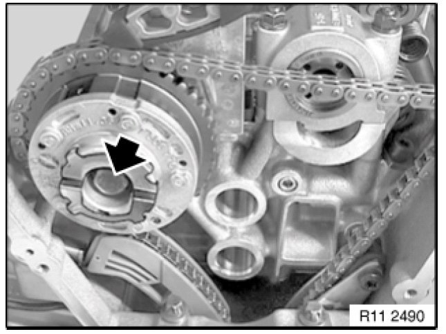

When slackening screws, grip camshafts at hexagon head.

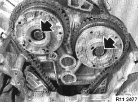

Slacken screws of exhaust and inlet adjustment unit.
pic 2

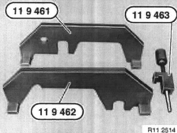

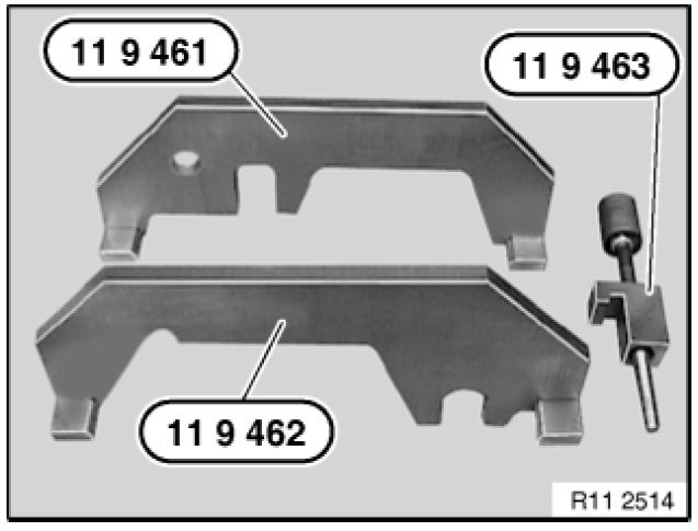

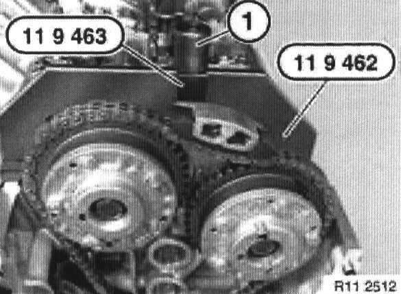

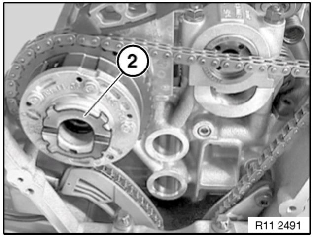

Get special tool kit 11 9 460 ready for securing camshafts.
Note:
Special tool 11 9 461 for securing inlet camshaft.
Special tool 11 9 462 for securing exhaust camshaft.
Special tool 11 9 463 (holder with screw).
pic 3

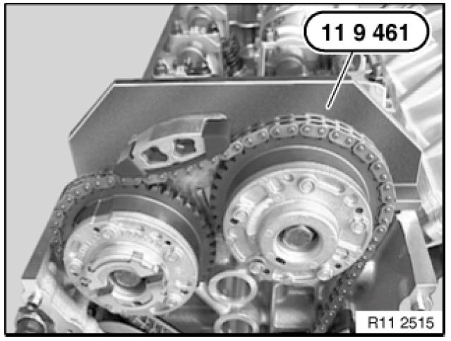

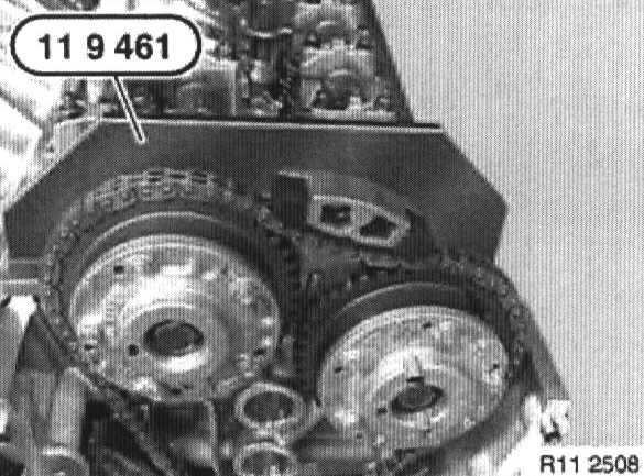

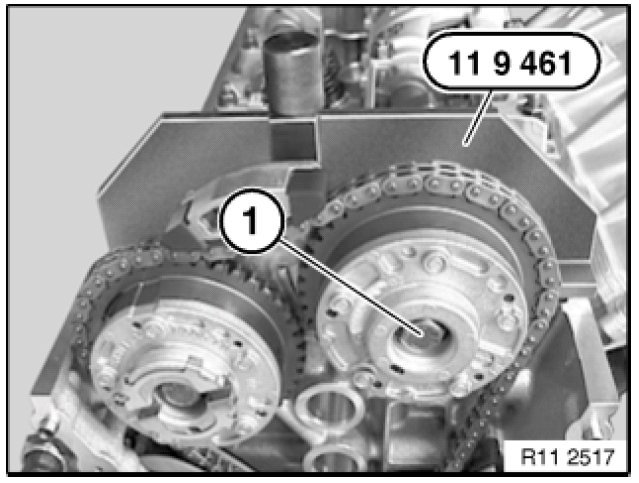

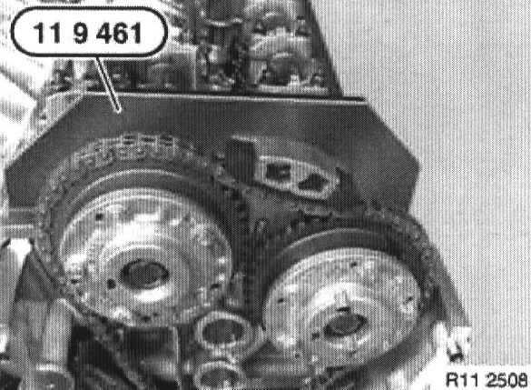

Place special tool 11 9 461 on inlet camshaft and align inlet camshaft so that special tool 11 9 461 rests without a gap on cylinder head.
pic 4

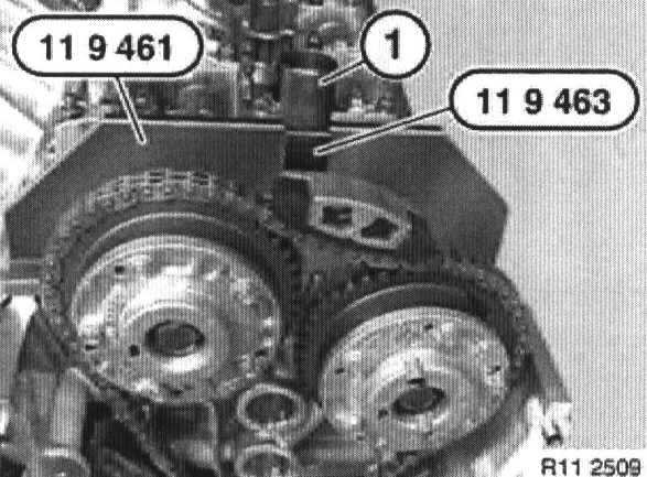

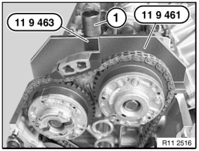

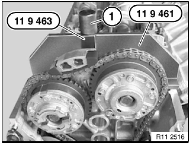

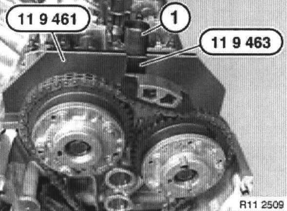

Fit special tool 11 9 463, secure screw (1) in thread for oil line and tighten down by hand.
pic 5
Note:
When tightening down screw (1), grip camshaft at hexagon head.

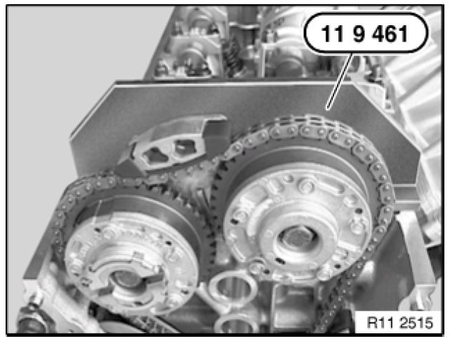

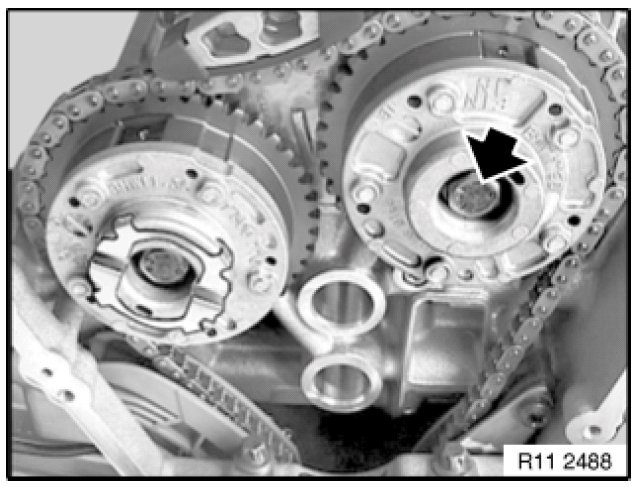

Tighten down screw (1) of inlet adjustment unit.
Adjustment unit to exhaust or inlet camshaft
M10 x 1 .................... 90 Nm
pic 6

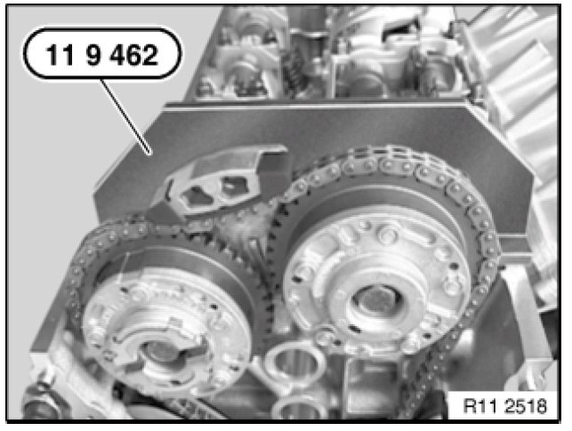

Release screw (1), remove special tools 11 9 463 and 11 9 461 from inlet camshaft.
pic 7

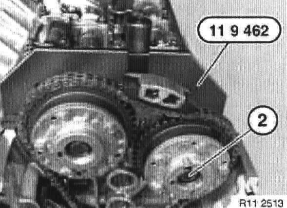

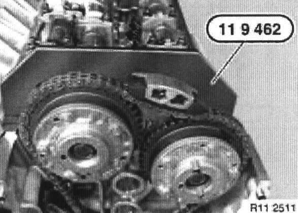

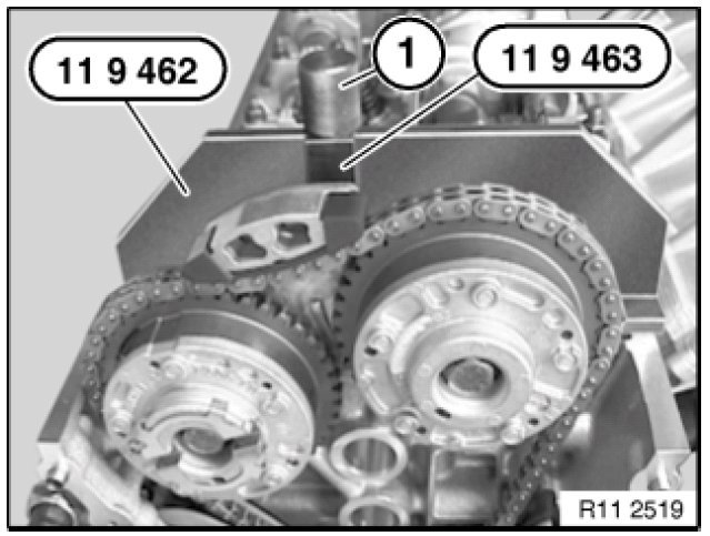

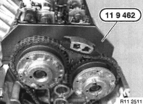

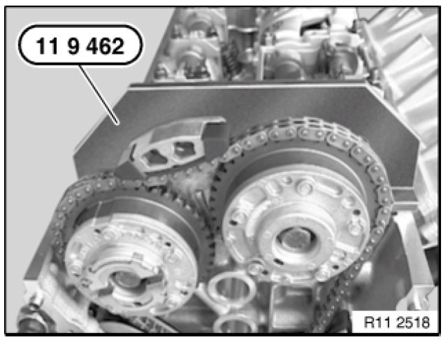

Place special tool 11 9 462 on exhaust camshaft and align exhaust camshaft so that special tool 11 9 462 rests without a gap on cylinder head.
pic 8

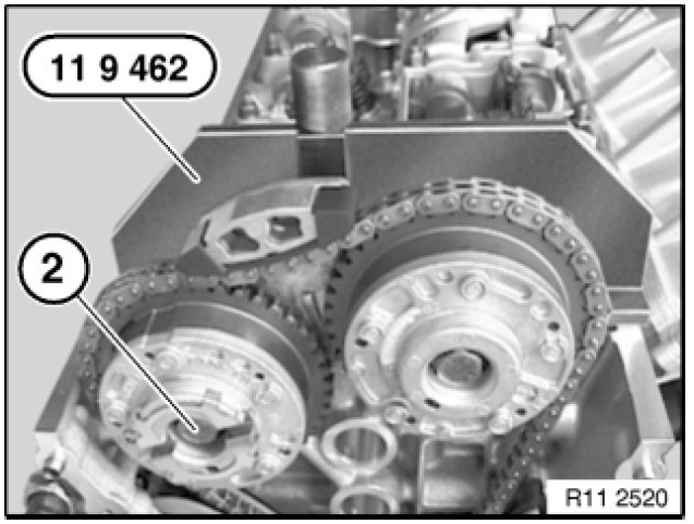

Fit special tool 11 9 463, secure screw (1 ) in thread for oil line and tighten down by hand.
pic 9
Note:
When tightening down screw (2), grip camshaft at hexagon head.
Tighten down screw (2) of exhaust adjustment unit.
pic 10
Release screw (1), remove special tools 11 9 463 and 11 9 462 from exhaust camshaft.

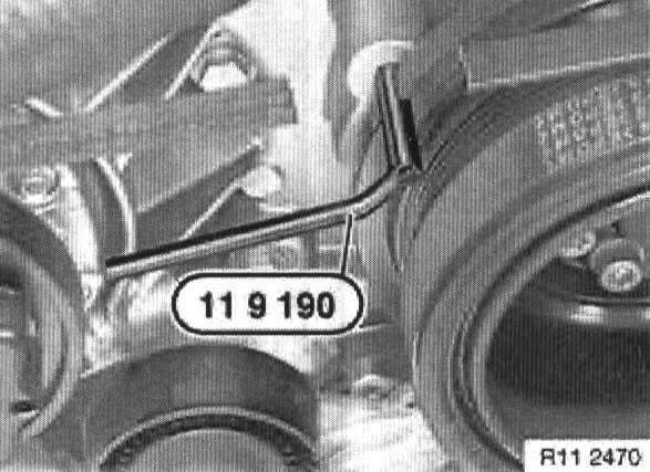

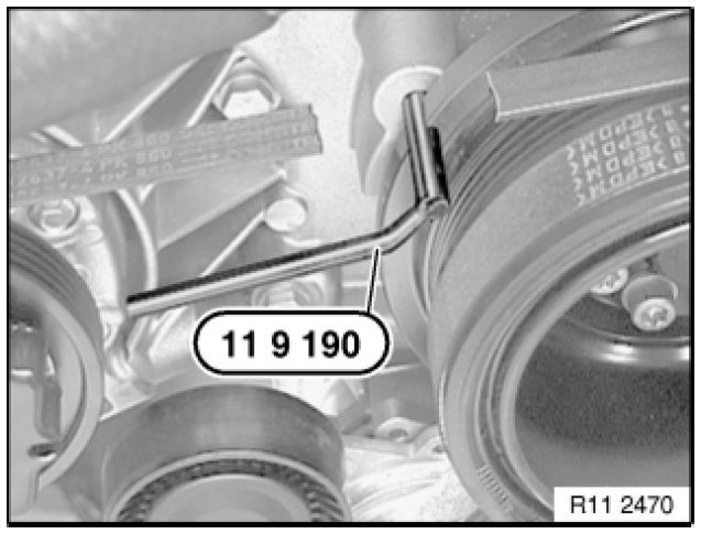

Remove special tool 11 9 190
Crank engine at central bolt twice in direction of rotation until engine returns to firing TDC position of 1st cylinder.
Secure vibration damper with special tool 11 9 190 in firing TDC position of 1st cylinder.
pic 12
Place special tool 11 9 461 on inlet camshaft and check timing.
Note:
The timing is correctly adjusted when special tool 11 9 461 rests flat on the cylinder head or protrudes by up to 0.5 mm to the exhaust side.
Remove special tool 11 9 461 from inlet camshaft.

Place special tool 11 9 462 on exhaust camshaft and check timing.
Note: The timing is correctly adjusted when special tool 11 9 462 rests flat on the cylinder head or protrudes by up to 0.5 mm to the exhaust side.
Remove all special tools.

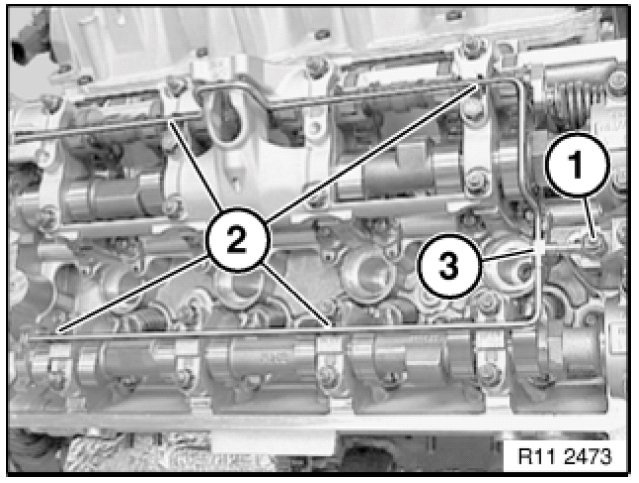

Right bank:
Installation:
Installation of inlet and exhaust adjustment units is described separately from removal.
pic 14

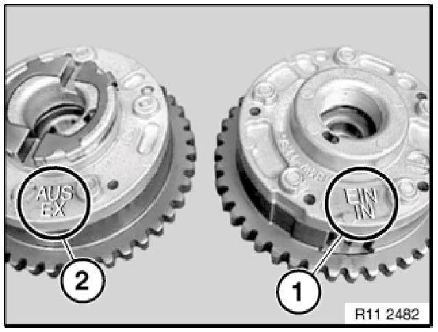

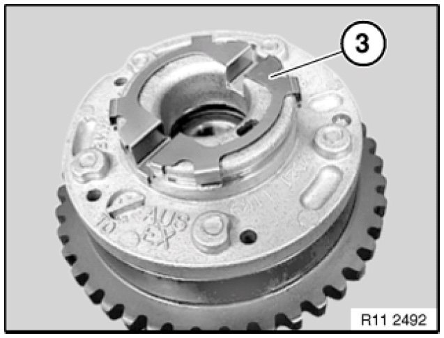

Important!
Danger of mix-up:
Inlet and exhaust adjustment units are different.
Mixing up the inlet and exhaust adjustment units will cause damage to the engine.
1. Inlet adjustment unit ( 1 ) is marked with EIN and IN.
2. Exhaust adjustment unit ( 2 ) is marked with AUS and EX.
pic 15
Note:
The exhaust adjustment unit on cylinder bank 1 to 4 has a metal clip ( 3 ) for driving the vacuum pump.
pic 16
Note:
Position of exhaust adjustment unit ( 2 ) to timing chain can be freely selected.

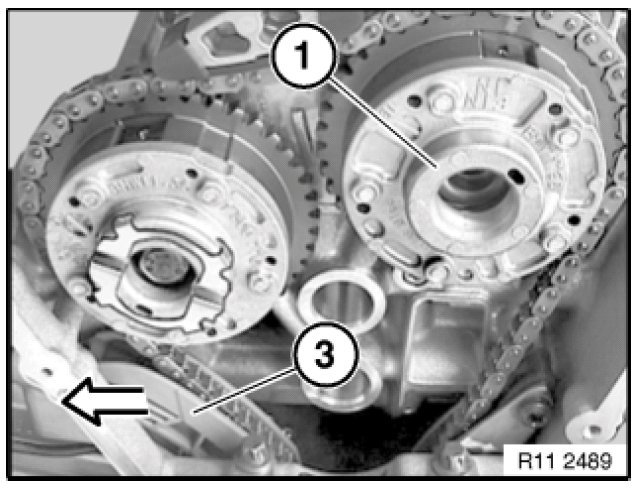

Pull timing chain up.
Feed exhaust adjustment unit ( 2 ) into timing chain and fit onto inlet camshaft.
pic 17
Replace screw.
Install screw on exhaust adjustment unit.
Tighten screw without play and then slacken off again by half a turn.
Note:
Position of inlet adjustment unit ( 1 ) to timing chain can be freely selected.
Feed inlet adjustment unit ( 1 ) into timing chain.
pic 18
Press tensioner rail ( 3 ) back and fit inlet adjustment unit ( 1 ) onto exhaust camshaft.

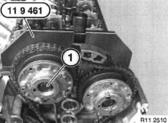

pic 22
Fit special tool 11 9 463, secure screw ( 1 ) in thread for oil line and tighten down by hand.
pic 23
pic 27
pic 28

Remove special tool 11 9 190.

Thank you for the very detailed reply will be more then helpful but the one thing I am trying to figure out at the moment 5-8 cams are of crank can be put to TDC, but is 180 degree of actual TDC as bank 1-4 needed the crank 180 deg to get to TDC. they were just of when I stopped turning the crank and then realized 5-8 didn’t move properly. so are way of TDC with the crank at TDC on or of a compression stroke can I rotate 5-8 cam as much as I need without interference or I need to make sure I am of compression stroke ? Or do I get my 1-4 at TDC and lock down then rotate cam to move 5-8? as the timing chain slipped of broken guides and won’t move one cam anyway as the vanos unit has a loose bolt.
