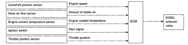

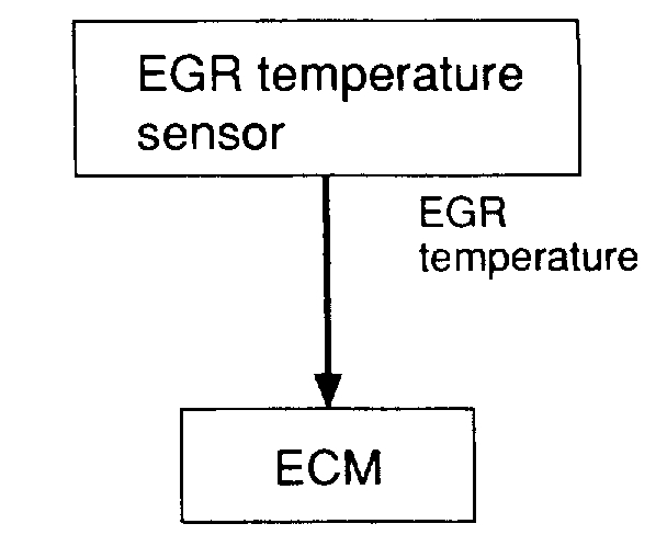

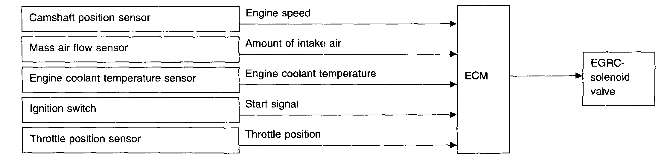

The auto shop read the code to be a P1402 and it indicated the EGR may be the problem. i replaced the EGR, the EGRC-BPT and checked all the vacuum hoses in the system, replacing one hose from the base of the EGRC-BPT. I checked the EGRC-solenoid with a battery and there was no sticking and it operated smoothly. i checked the resistance on the EGR temperature sensor and it is operating in the correct range. The SES light is still on and the car runs great, actually better since replacing the EGR valve. Any other suggestions to get this SES light to turn off? Thank you!.

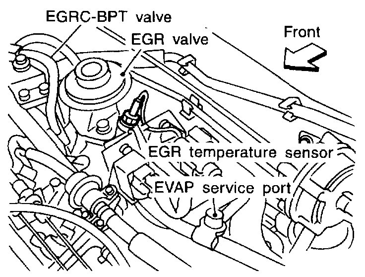

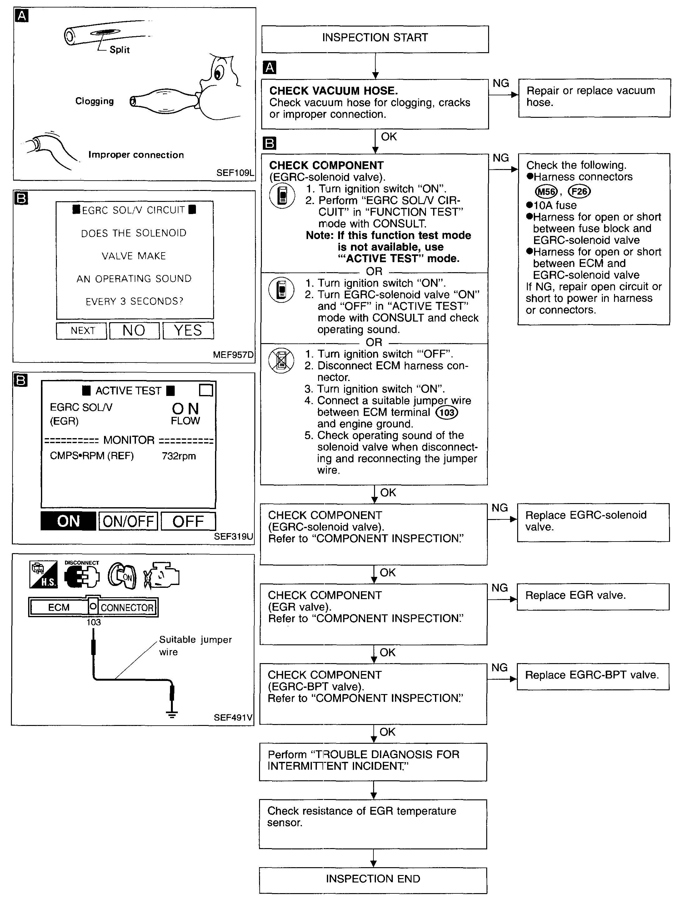

It seems you are very knowledgeable. I am going to provide a diagnostic flow chart to help determine where the issue is coming from. All attached pics correlate with the directions, but it does require a scan tool.
_____________________________________________-
1999 Nissan-Datsun Altima GLE L4-2.4L (KA24DE)
P1402
Vehicle ALL Diagnostic Trouble Codes ( DTC ) Testing and Inspection P Code Charts P1402
P1402
pic 1
pic 2

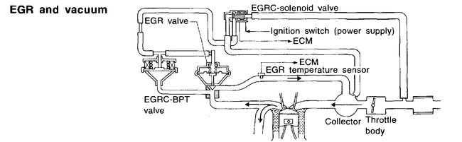

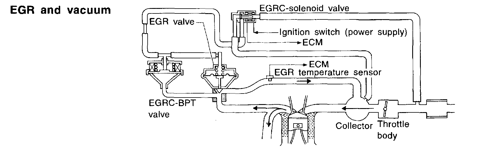

SYSTEM DESCRIPTION
This system cuts and controls vacuum applied to the EGR valve to suit engine operating conditions. This cut-and-control operation is accomplished through the ECM and the EGRC-solenoid valve. When the ECM detects any of the following conditions, it cuts the current for the solenoid valve. This causes the port vacuum to be discharged into the atmosphere. The EGR valve remains closed.
- Low engine coolant temperature
- Engine starting
- High-speed engine operation
- Engine idling
- Excessively high engine coolant temperature
- Mass air flow sensor malfunction
- Low ambient temperature

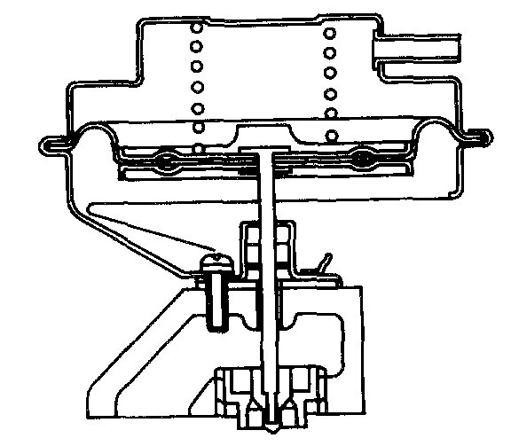

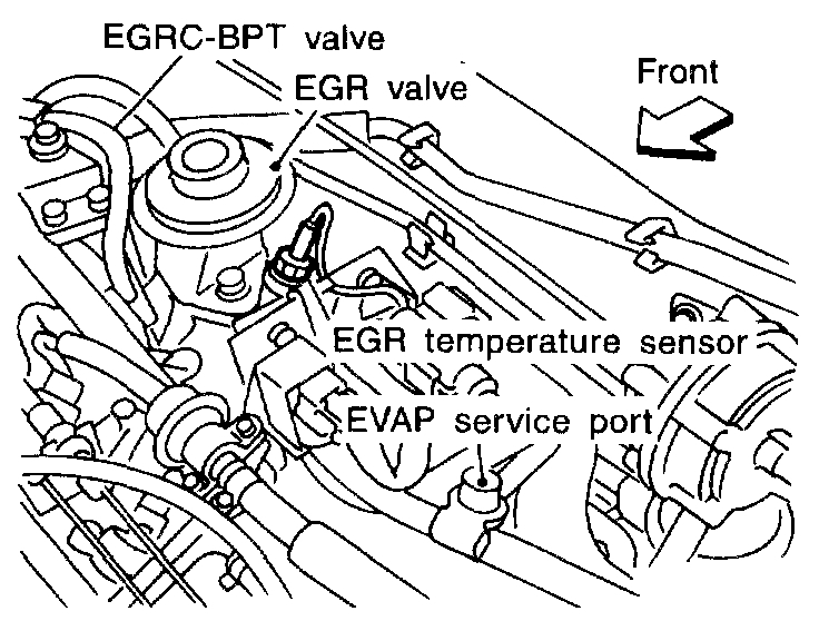

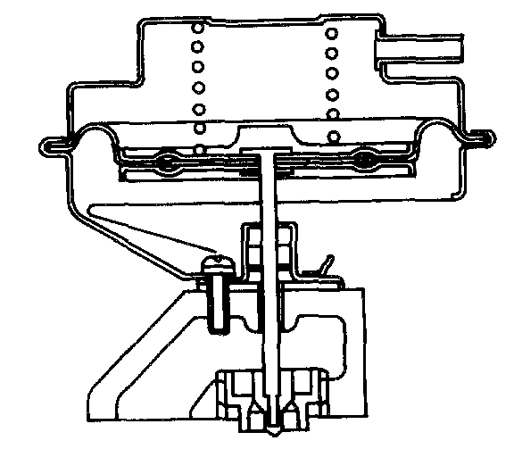

Exhaust gas recirculation (EGR) valve
The EGR valve controls the amount of exhaust gas routed to the intake manifold. Vacuum is applied to the EGR valve in response to throttle valve opening. The vacuum controls the movement of a taper valve connected to the vacuum diaphragm in the EGR valve.
pic 4

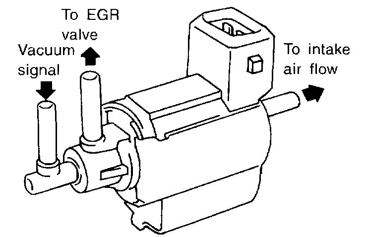

EGRC-solenoid valve
The EGRC-solenoid valve responds to signals from the ECM. When the ECM sends an ON (ground) signal, the coil in the solenoid valve is energized. The vacuum signal passes through the solenoid valve. The signal then reaches the EGR valve.
When the ECM sends an OFF signal, a plunger will then move to cut the vacuum signal from the intake manifold to the EGR valve.

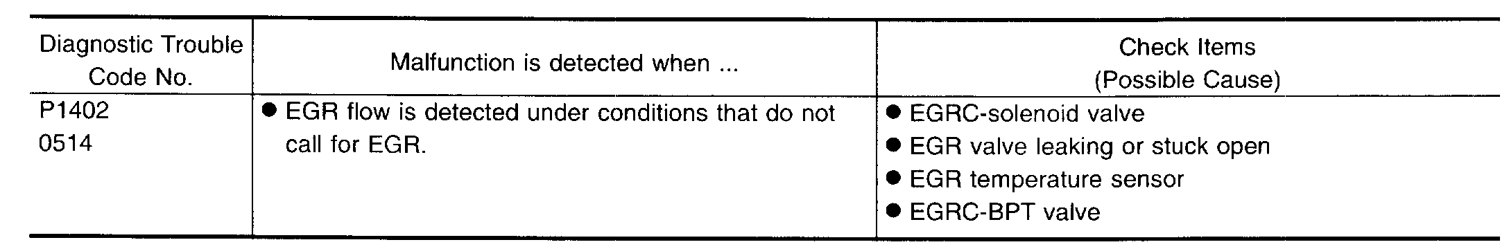

ON BOARD DIAGNOSIS LOGIC
If EGR temperature sensor detects EGR flow under the condition that does not call for EGR, a high-flow malfunction is diagnosed.
NOTE: Diagnosis for this DTC will end when engine coolant temperature is approx. 50-60 °C (120-140 °F). Ignition switch must be turned "ON" (engine running) with engine coolant temperature below 40 °C (104 °F) when starting DTC confirmation procedure.

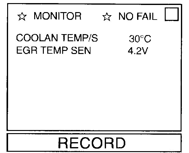

- Engine coolant temperature and EGR temperature must be verified in "DATA MONITOR" mode with CONSULT before starting DTC WORK SUPPORT test. If it is out of range below, the test cannot be conducted.
COOLAN TEMP/S: -10 to 40 °C (14 to 104 °F)
EGR TEMP SEN: Less than 4.8 V
If the values are out of the ranges indicated above, park the vehicle in a cool place and allow the engine temperature to stabilize. Do not attempt to reduce the coolant or EGR temperature with a fan or means other than ambient air. Doing so may produce an inaccurate diagnostic result.

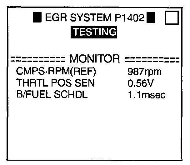

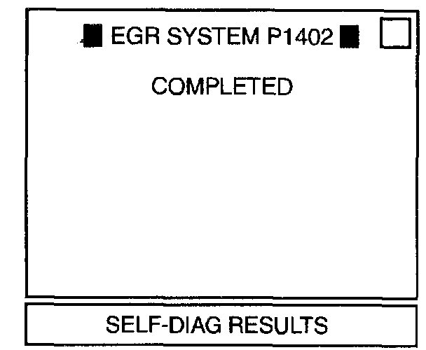

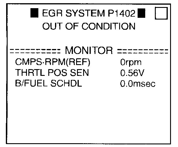

With Consult
1. Turn ignition switch OFF and wait at least 5 seconds. Then turn ignition switch "ON".
2. Select "EGR SYSTEM P1402" of "EGR SYSTEM" in "DTC WORK SUPPORT" mode with CONSULT.
3. Follow the instruction of CONSULT.
4. Start engine and let it idle until "TESTING" on CONSULT screen is turned to "COMPLETED". (It will take 70 seconds or more.)
If "TESTING" is not displayed after 5 minutes, turn ignition "OFF" and cool the engine coolant temperature to the range of -10 to 40 °C (14 to 104 °F). Retry from step 1).
5. Make sure that "OK" is displayed after touching "SELF-DIAG RESULTS". If "NG" is displayed, refer to "DIAGNOSTIC PROCEDURE".

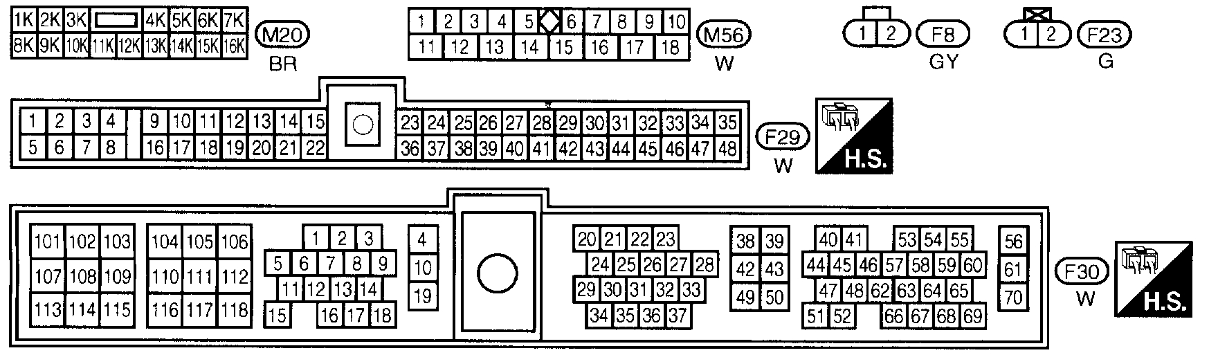

3. Check that voltage between ECM terminal (62) (EGR temperature) and ground is less than 4.8 V.

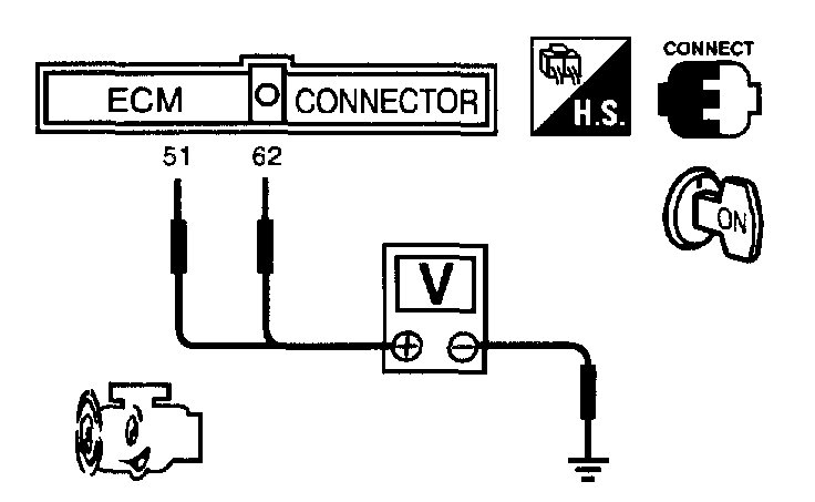

Without Scan Tools
1. Turn ignition switch "ON".
2. Check the following voltages.
ECM terminal (51) (engine coolant temperature) and ground: 2.7 - 4.4 V
ECM terminal (62) (EGR temperature) and ground: Less than 4.8 V

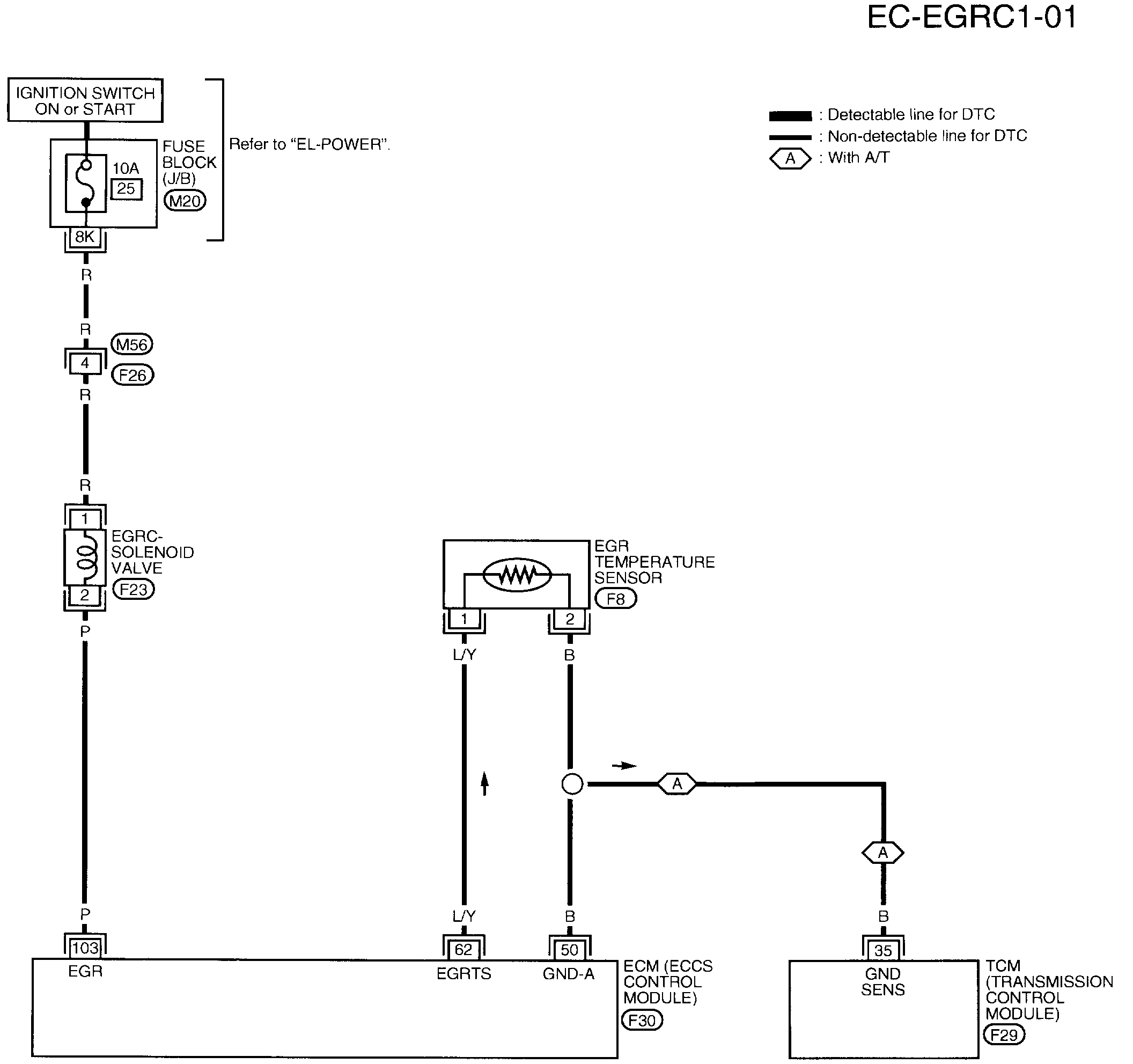

WIRING DIAGRAM

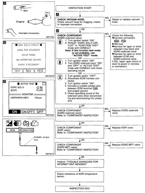

COMPONENT INSPECTION
pic 16

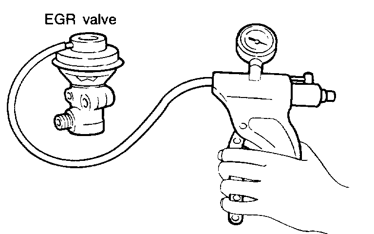

EGR VALVE
- Apply vacuum to EGR vacuum port with a hand vacuum pump.
EGR VALVE SPRING SHOULD LIFT
- Check for sticking
If NG, repair or replace EGR valve.
pic 17
pic 18

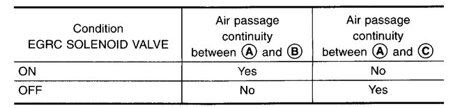

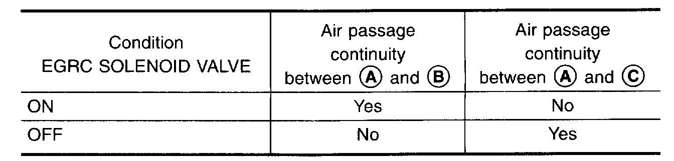

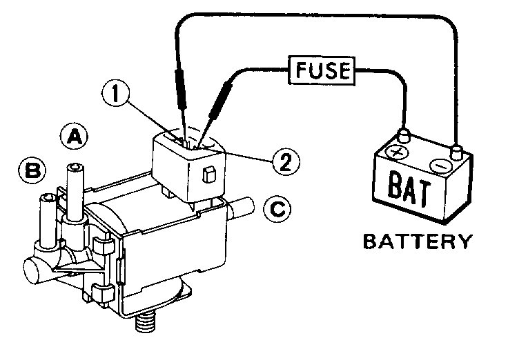

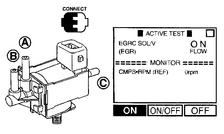

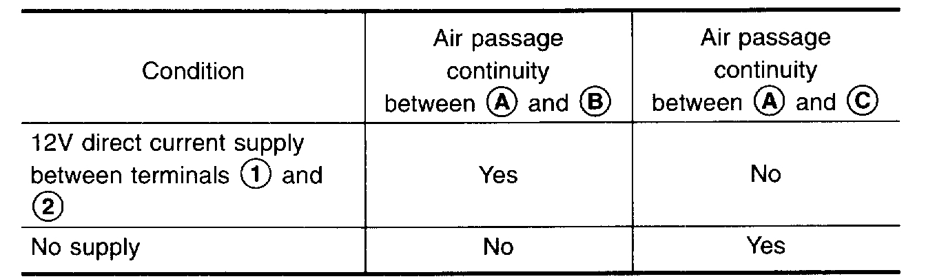

EGRC-SOLENOID VALVE
Check air passage continuity.
With Consult
Perform "EGRC SOLENOID VALVE" in "ACTIVE TEST" mode.
OR
pic 19
pic 20
Without Consult
If NG or operation takes more than 1 second, replace EGRC-solenoid valve.
pic 21
pic 22
pic 23

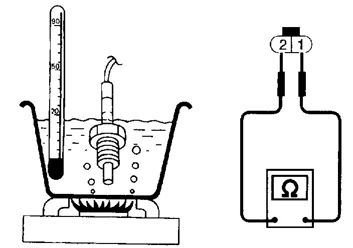

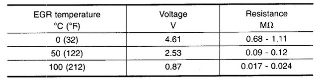

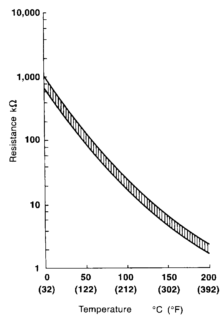

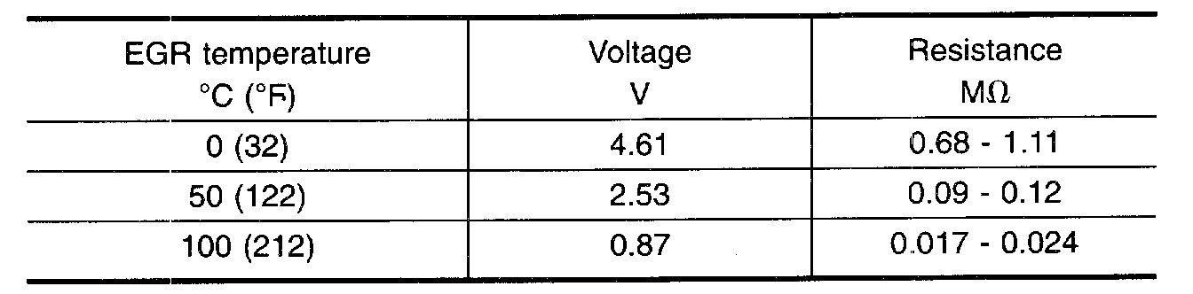

EGR TEMPERATURE SENSOR
Check resistance change and resistance value.
If NG, replace EGR temperature sensor.

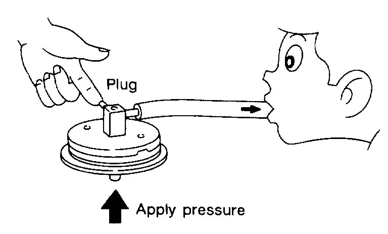

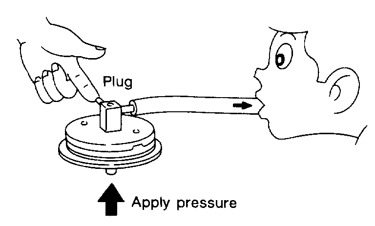

EGRC-BPT VALVE
1. Plug one of two ports of EGRC-BPT valve.
2. Vacuum from the other port and check for leakage while applying a pressure above 0.981 kPa (100 mmH2O, 3.94 inH2O) from under EGRC-BPT valve.
3. If a leakage is noted, replace the valve.
