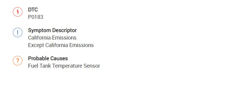

check engine light turned on with code P0183
2012 NISSAN ALTIMA
91,989 MILES • 2.5L • 4 CYL • 2WD • AUTOMATIC
NINAZ707

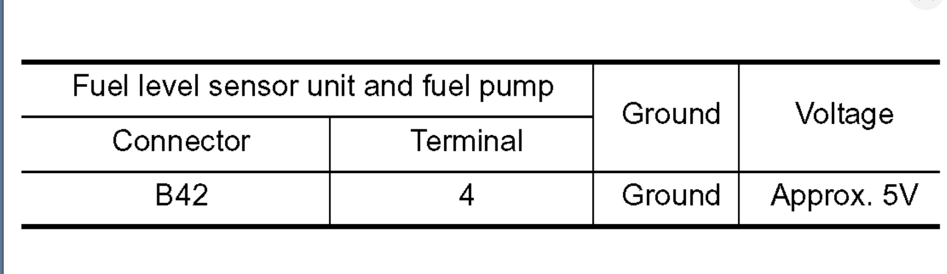

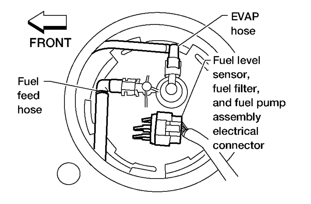

i have not noticed any problems just that my check engine came on . where i got my oil change checked the engine code and gave me this P0183 that's all. what should i do?
Jun 5, 2017 at 3:23 AM
Good evening,
The code is for the fuel tank temperature sensor. It is part of the fuel pump itself in the fuel tank.
I attached the flow chart for checking it and some pictures.

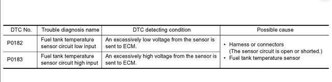

The fuel tank temperature sensor is used to detect the fuel temperature inside the fuel tank. The sensor modifies a voltage signal from the ECM. The modified signal returns to the ECM as the fuel temperature input. The sensor uses a thermistor which is sensitive to the change in temperature. The electrical resistance of the thermistor decreases as temperature increases.
DTC Logic
DTC DETECTION LOGIC
DTC CONFIRMATION PROCEDURE

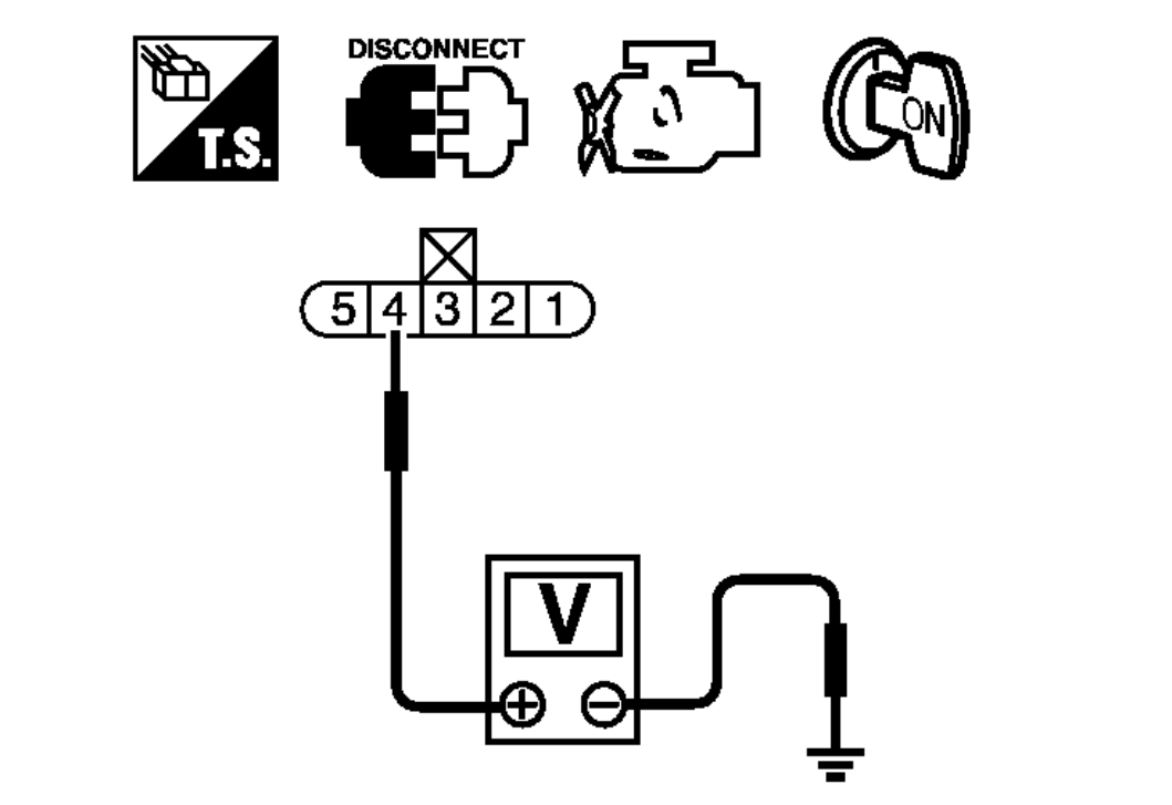

2. CHECK FUEL TANK TEMPERATURE SENSOR POWER SUPPLY CIRCUIT
1.Turn ignition switch OFF.
2.Disconnect "fuel level sensor unit and fuel pump" harness connector.
3.Turn ignition switch ON.
4.Check the voltage between "fuel level sensor unit and fuel pump" harness connector and ground.
Is the inspection result normal?
YES- GO TO 4.
NO- GO TO 3.

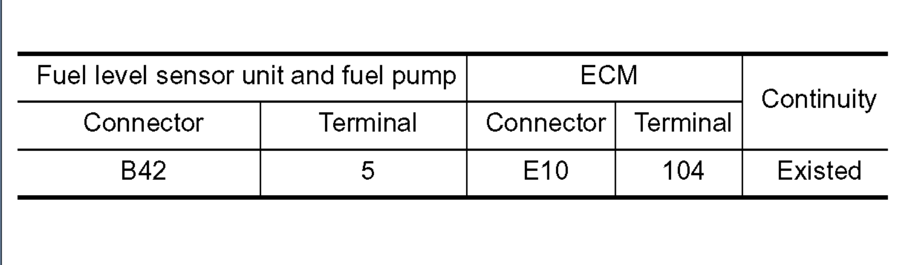

4. CHECK FUEL TANK TEMPERATURE SENSOR GROUND CIRCUIT FOR OPEN AND SHORT
2.Check the continuity between "fuel level sensor unit and fuel pump" harness connector and ECM harness connector.
3.Also check harness for short to ground and short to power.
YES- GO TO 6.
NO- GO TO 5.

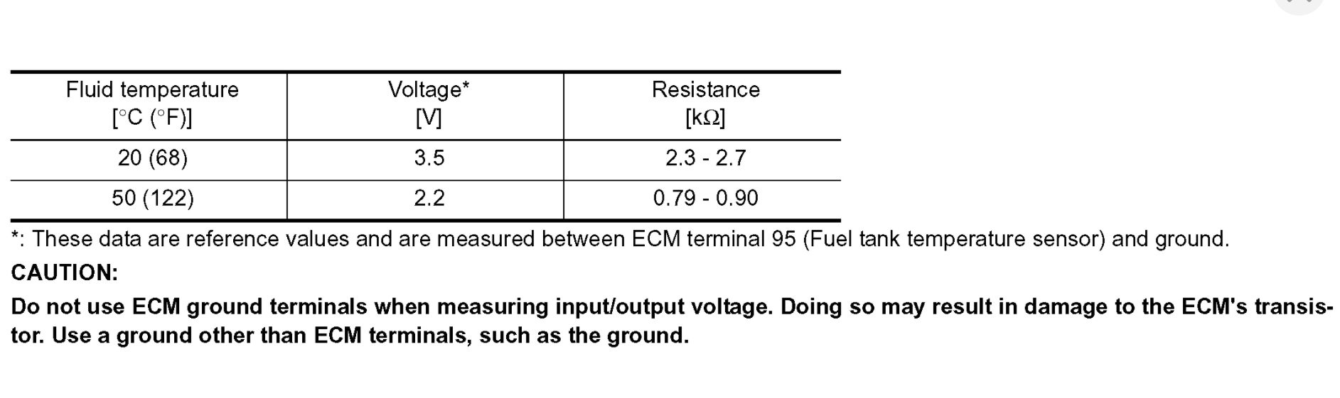

6. CHECK FUEL TANK TEMPERATURE SENSOR
Refer to "Component Inspection".
YES- GO TO 7.
NO- Replace "fuel level sensor unit and fuel pump". See: Fuel Pump > Removal and Replacement > Removal and Installation.
1. CHECK FUEL TANK TEMPERATURE SENSOR
3.Remove fuel level sensor unit. See: Fuel Pump > Removal and Replacement > Removal and Installation.
4.Check resistance between "fuel level sensor unit and fuel pump" terminals by heating with hot water as shown in the figure.
YES- INSPECTION END
NO- Replace "fuel level sensor unit and fuel pump". Refer to

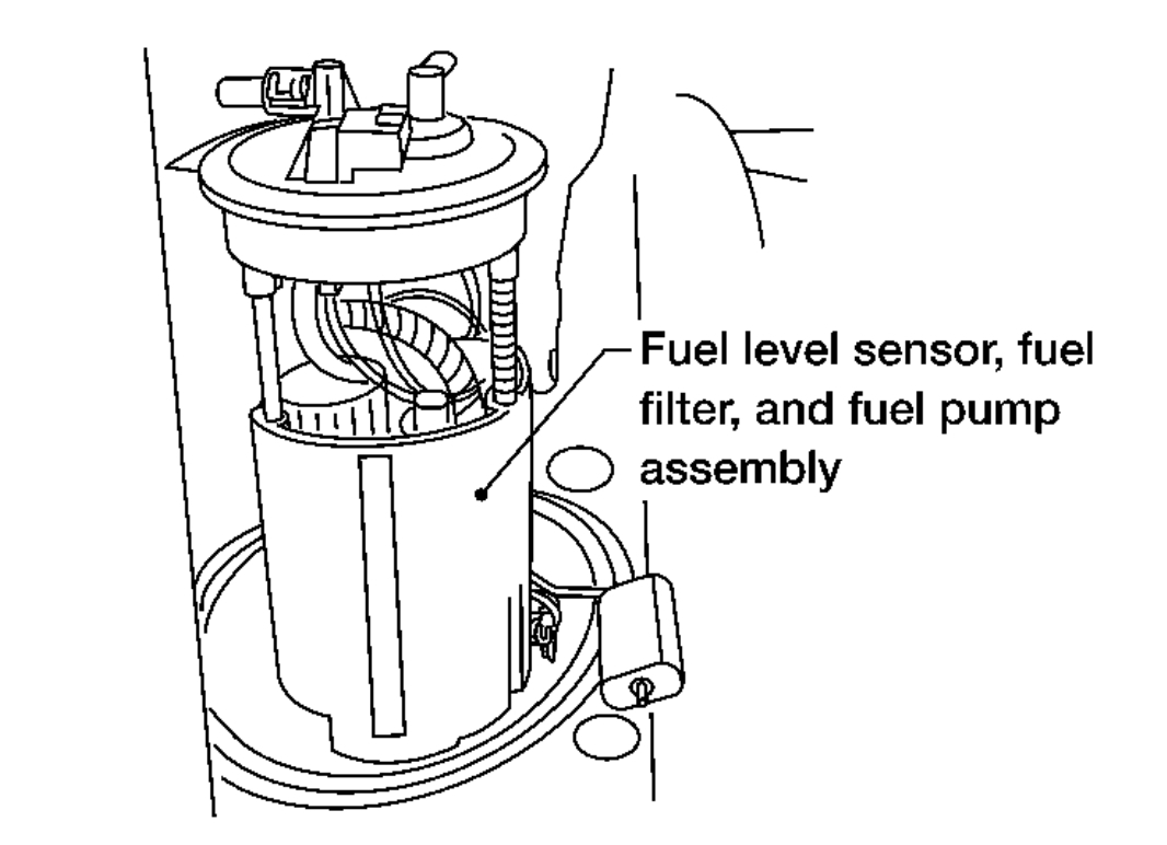

FUEL LEVEL SENSOR UNIT, FUEL FILTER AND FUEL PUMP ASSEMBLY

1.Unscrew the fuel filler cap to release the pressure inside the fuel tank.
2.Release the fuel pressure from the fuel lines. See: Fuel Pressure > Component Tests and General Diagnostics > Fuel Pressure (QR25DE For California), See: Fuel Pressure > Component Tests and General Diagnostics > Fuel Pressure (QR25DE Except For California), See: Fuel Pressure > Component Tests and General Diagnostics > Fuel Pressure (QR25DE for Mexico), See: Fuel Pressure > Component Tests and General Diagnostics > Fuel Pressure (VQ35DE).
3.Disconnect the battery negative terminal.

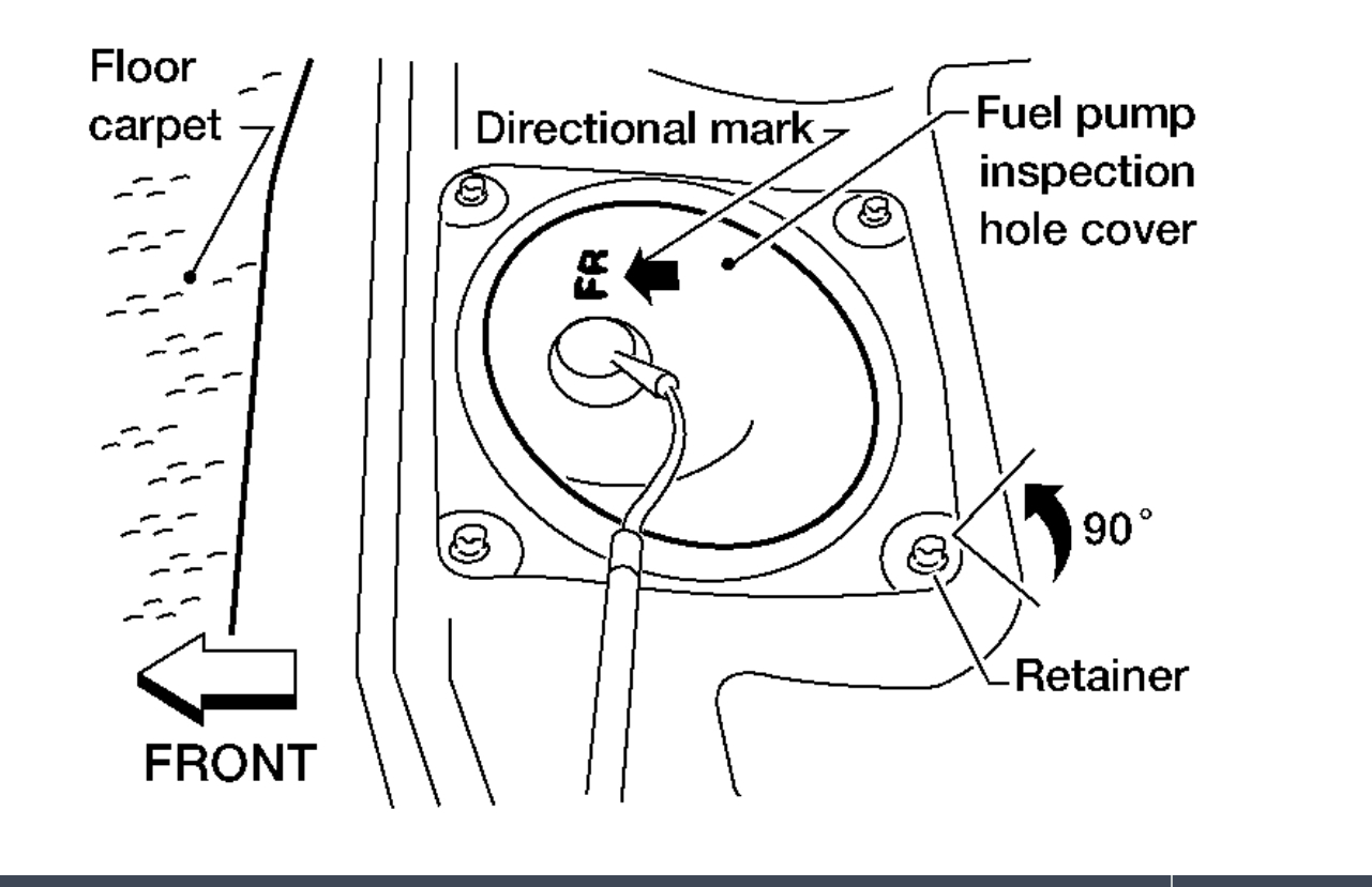

4.Remove the rear seat cushion. See: Seats > Removal and Replacement > Sedan for Sedan or See: Seats > Removal and Replacement > Coupe for Coupe.
5.Turn the four retainers 90 in a clockwise direction and remove the fuel pump inspection hole cover.
FL

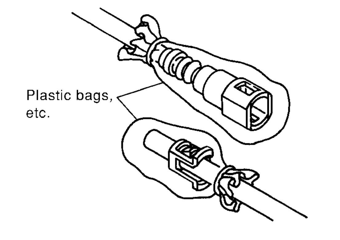

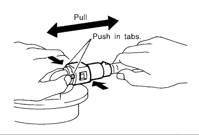

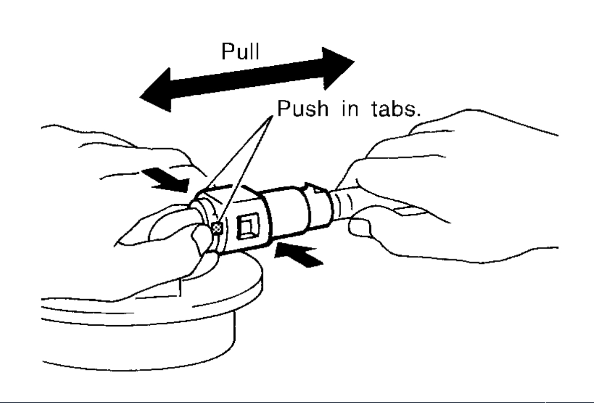

6.Disconnect the fuel level sensor, fuel filter, and fuel pump assembly electrical connector, EVAP hose quick connector, and the fuel feed hose quick connector from the fuel level sensor unit, fuel filter, and fuel pump assembly.
Remove the quick connector as follows:
Hold the sides of the connector, push in tabs and pull out the tube.
If the connector and the tube are stuck together, push and pull several times until they start to move. Then disconnect them by pulling.
CAUTION:
The tube can be removed when the tabs are completely depressed. Do not twist it more than necessary.
Do not use any tools to remove the quick connector.
Keep the resin tube away from heat. Be especially careful when welding near the tube.
Prevent acid liquid such as battery electrolyte, etc. from getting on the resin tube.
Do not bend or twist the tube during installation and removal.
Only when the tube is replaced, remove the remaining retainer on the tube or fuel level sensor, fuel filter, and fuel pump assembly.
When the tube or fuel level sensor, fuel filter, and fuel pump assembly is replaced, also replace the retainer with a new one (green colored retainer).
To keep the connecting portion clean and to avoid damage and foreign materials, cover them completely with plastic bags or something similar.

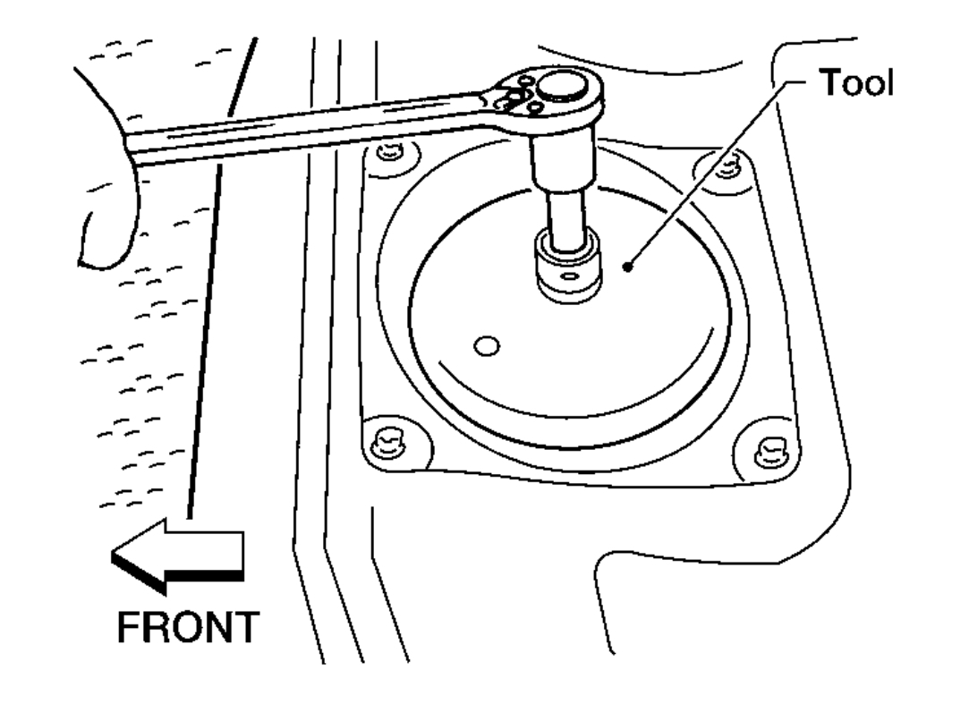

7.Remove the lock ring using a socket drive handle and Tool as shown.
Tool number: KV991J0090 (J-46214)
CAUTION:
Discard the lock ring if damaged or distorted.
8.Remove the fuel level sensor, fuel filter, and fuel pump assembly. Remove and discard the O-ring.
CAUTION:
Do not bend the float arm during removal.
Discard the O-ring. Do not reuse O-ring.
INSPECTION AFTER REMOVAL
Inspect the fuel level sensor, fuel filter, and fuel pump assembly for any defects and foreign materials. Replace as necessary.
