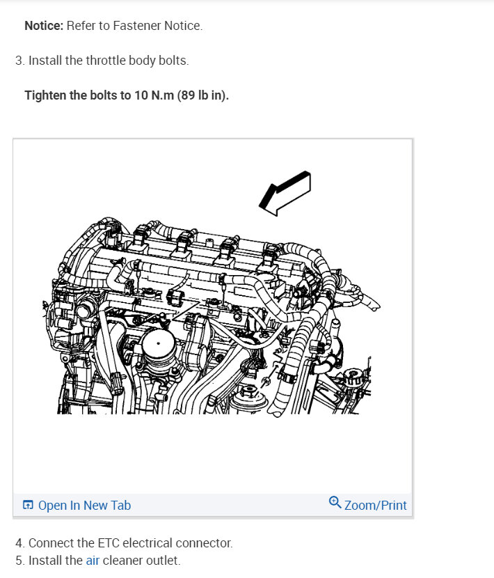

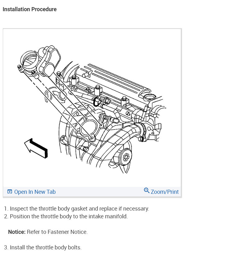

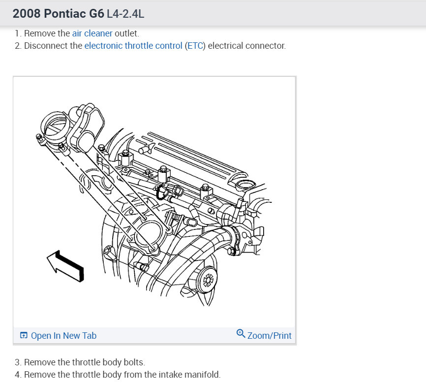

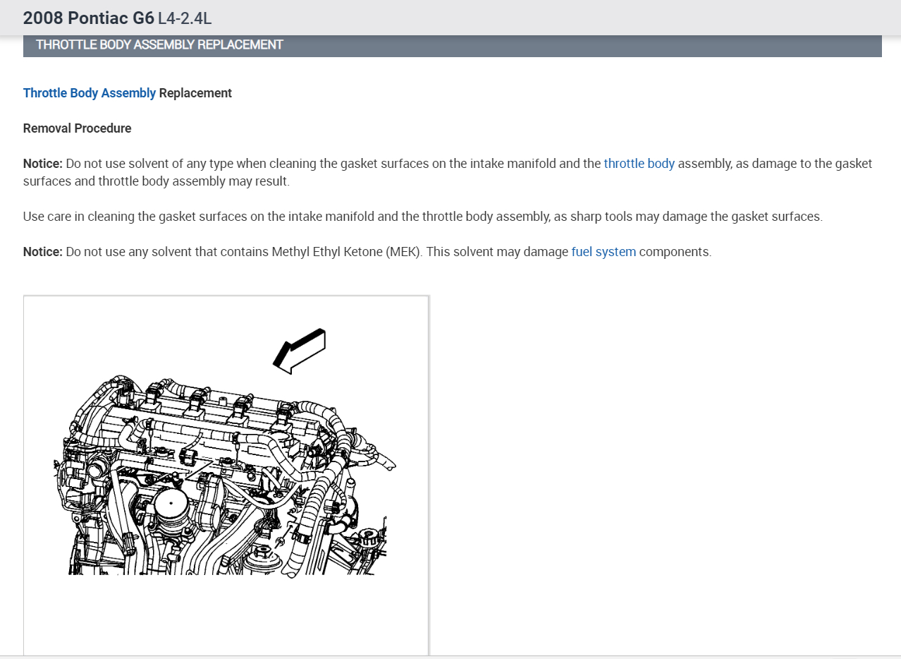

This is common for the car to go into limp mode when the throttle actuator needs to be serviced.
Here is a guide to help you with that:
This guide can help as well:
https://www.2carpros.com/articles/reduced-power-limp-mode
Check out the images below to show you how to do the job on your car. Let us know what happens and please upload pictures or videos of the problem.
