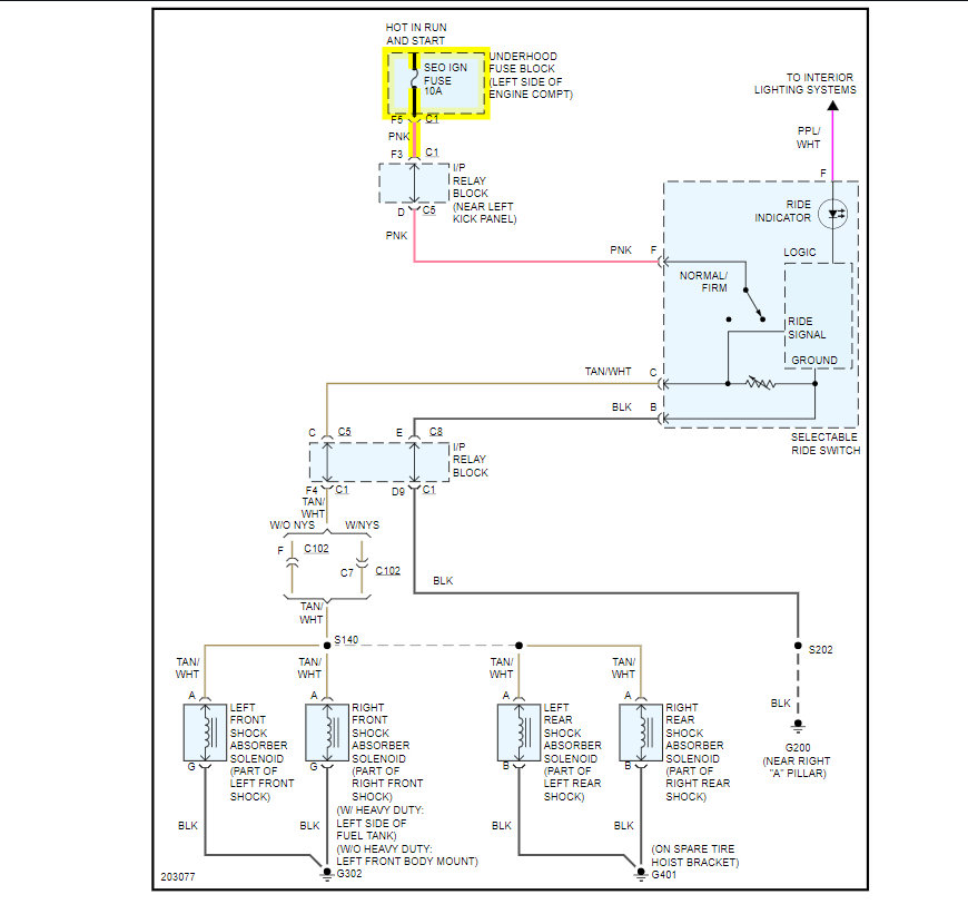

I recently bought the vehicle listed above a few months ago as a "winter beater". Today each time I start the vehicle the Service Ride Control message comes up on the dash. When I got home I plugged in my scanner and the only codes I got were for the rear aux climate control module which I know needs replaced. It's currently stuck on heat until I fix it and I'm okay with this at the moment seeing as the time of year.
I inspected the fuses and they all check fine. All of the lines and wires for the shocks and air compressor look good. The rear shocks do look to be newer than the front. What steps can I take to diagnose this warning without and trouble codes. Could the trouble codes for the rear climate control cause this message to show up or is the service ride control strictly related to the auto ride suspension?

Good morning,
I attached a wiring diagram of the ride system for you.
Make sure all the shocks have the electronics hooked up. Sometimes people eliminate the electronic shocks for standard shocks.
Check the fuse in the diagram for power on both sides. This is not a visual test, it is a power test.
Let me know the results.
