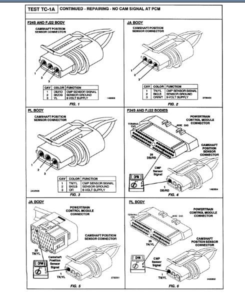

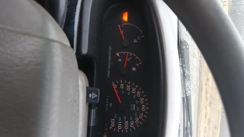

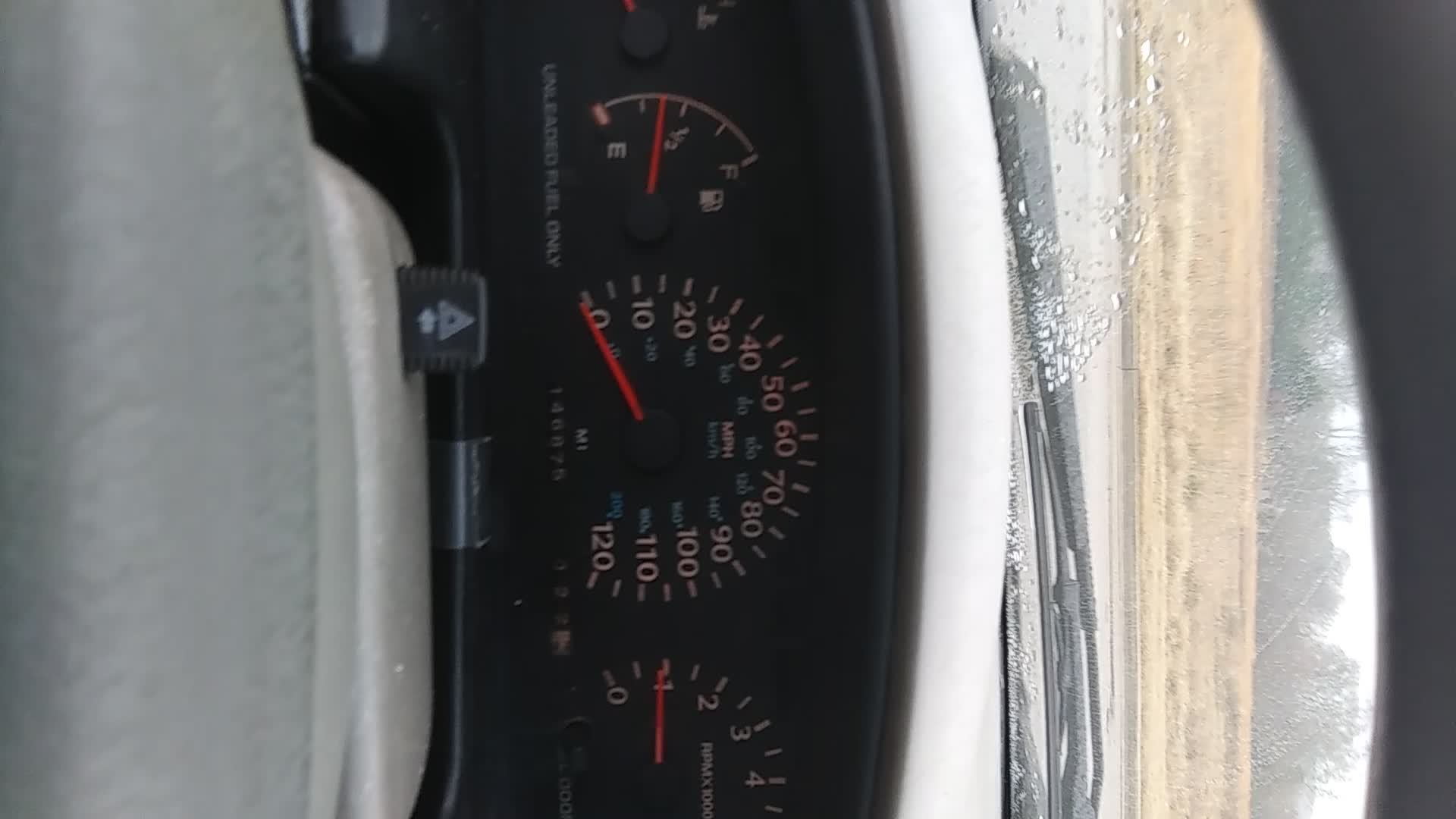

I have recently bought the car listed above 2.0 SOHC. I had a friend and a fella at local parts house put on computer.Both said timing belt skipped 1 tooth and the Idle Air Control Value. We reset the light but it come right back on.The car runs great, my opinion don't think it has skipped a tooth, just runs to good. So should i tear down and replace belt an tensioner? An get new IAC valve? or maybe clean mine? An I love 2CarPros been looking on here for about 3 years now to get advice. thanks and this my first question to post. Thanks for all the help.

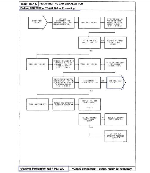

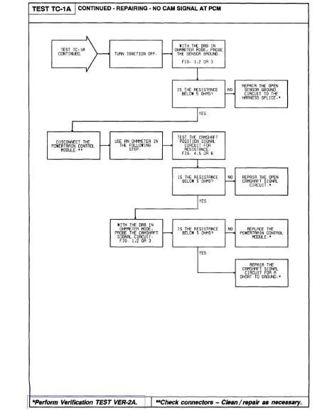

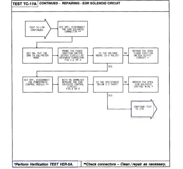

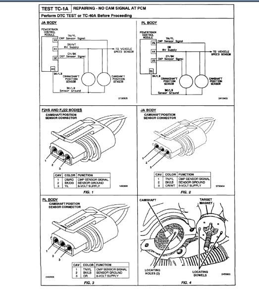

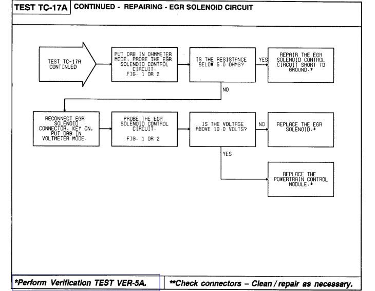

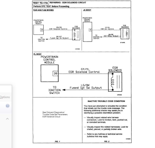

32,54.
Dec 1, 2019 at 12:22 AM

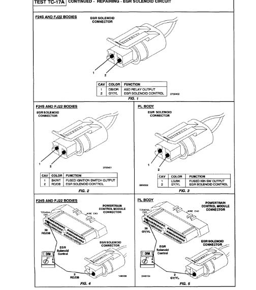

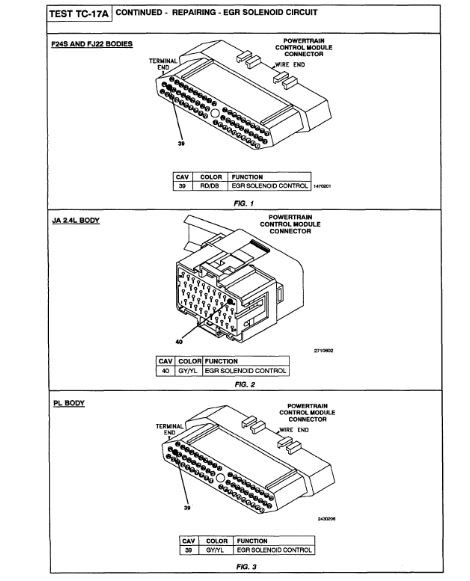

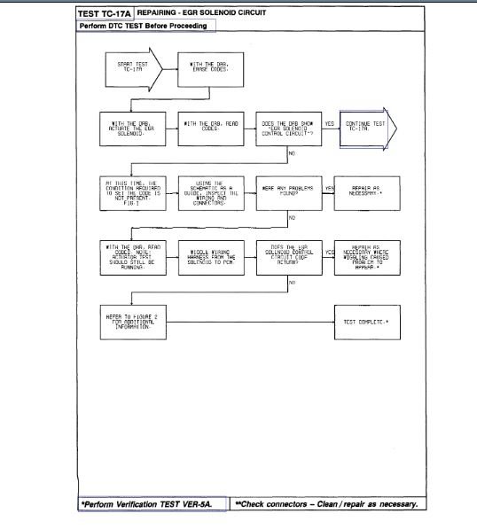

Okay, the 32 is for the EGR circuit. This may be a wiring issue.
The 54 is for cam sensor.
I attached the flow charts. Most of the time it is wiring that is the issues especially due to the age of the car.
Glad you did not listen to the parts guy.
Dec 1, 2019 at 12:46 AM

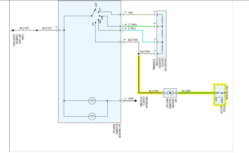

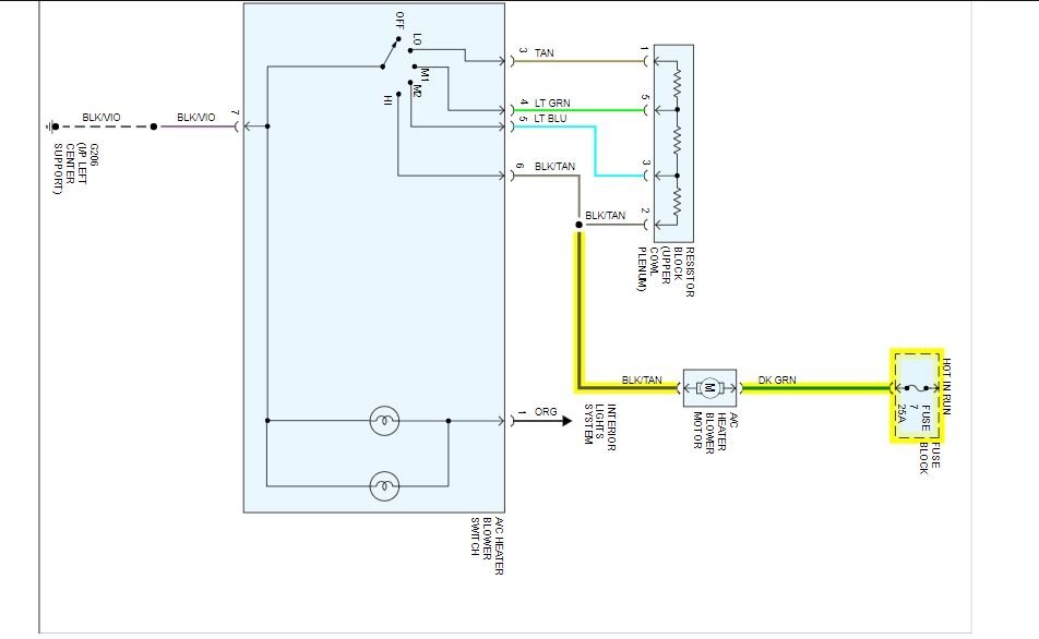

Thank you. it runs fine though.i recently had problem. it kept blowing fuel pump fuse. I read a few post on 2CarPros and believe it was ASD relay going bad?? I swapped fuel pump first,same thing.It would crank an idle. then 10 minutes or so blows fuse. After that an little more reading I swapped relays.I have not blown a fuse but no my blower motor won't come on??I check fuses any idea on the?? And again thank you I been needing you guys.
Dec 1, 2019 at 1:06 AM
The relay you removed and placed somewhere else may be the failure. Did you replace the relay with a new one?
Dec 1, 2019 at 1:14 AM
JOHN GLASS
  • 53 POSTS
I didn't,,but the one I pulled out is still out. Did I mention I got a 1997 neon as well? it was running and just quit.Then I bought the 1995.
Dec 1, 2019 at 1:39 AM
I attached a wiring diagram of the blower motor system. Check the fuse for power on both sides.
check for voltage to the motor .
Dec 1, 2019 at 1:55 AM
JOHN GLASS
  • 53 POSTS
bad contact in fuse panel. thank you

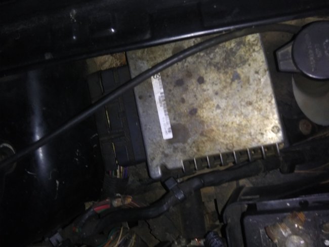

believe I got that straight. the connectors seemed loose inside connector. I been driving for about 20 minutes and when I shut it off I heard a humming sound that seemed to be coming from that box that is located on top of driver side fender.Does that mean computer trying to go bad??
Dec 4, 2019 at 10:49 AM
Can you post a picture of the box?
Dec 4, 2019 at 10:51 AM
JOHN GLASS
  • 53 POSTS
did you ever get my picture? I will send again.
Dec 4, 2019 at 8:12 PM
Unplug it after turning it off. If the noise stops, then yes, replace it.
Dec 4, 2019 at 10:54 PM
