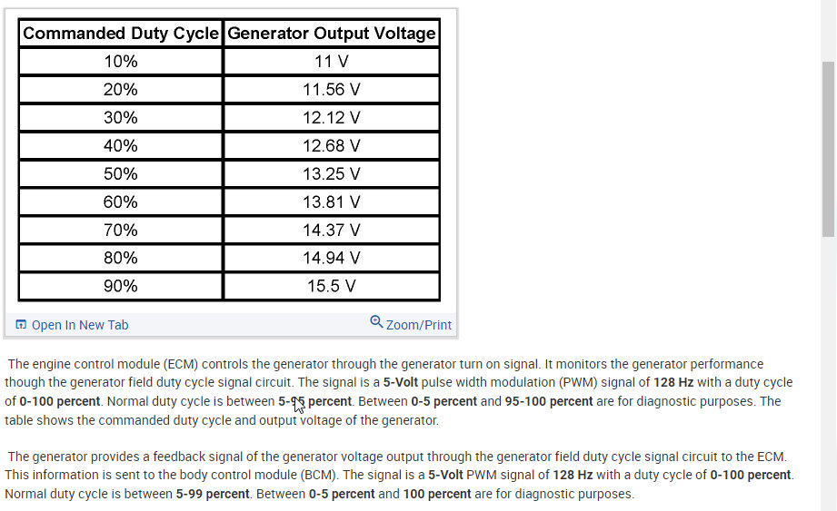

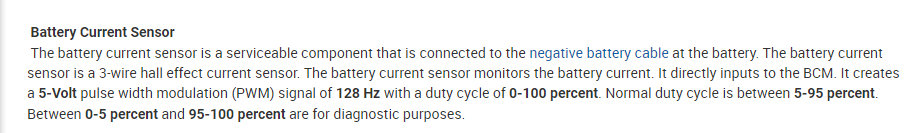

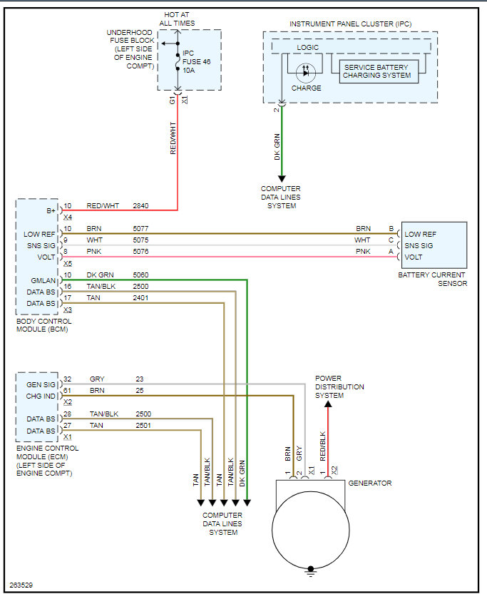

I suspect the battery current sensor is reading improperly which is forcing the charging system to run at a higher voltage and most likely it is damaging the field control in the alternator.
We are going to need to test this on a functioning alternator so unfortunately we are going to have to replace it again. Then we need to monitor the voltage across the battery at idle and see what the voltage is. Then raise the RPM's to 2,500 and see what the voltage is.
If you have a scan tool that would be great to monitor the overall state of charge of the system. Then monitor the duty cycle of the alternator and let me know if that matches the voltage. See the chart attached.

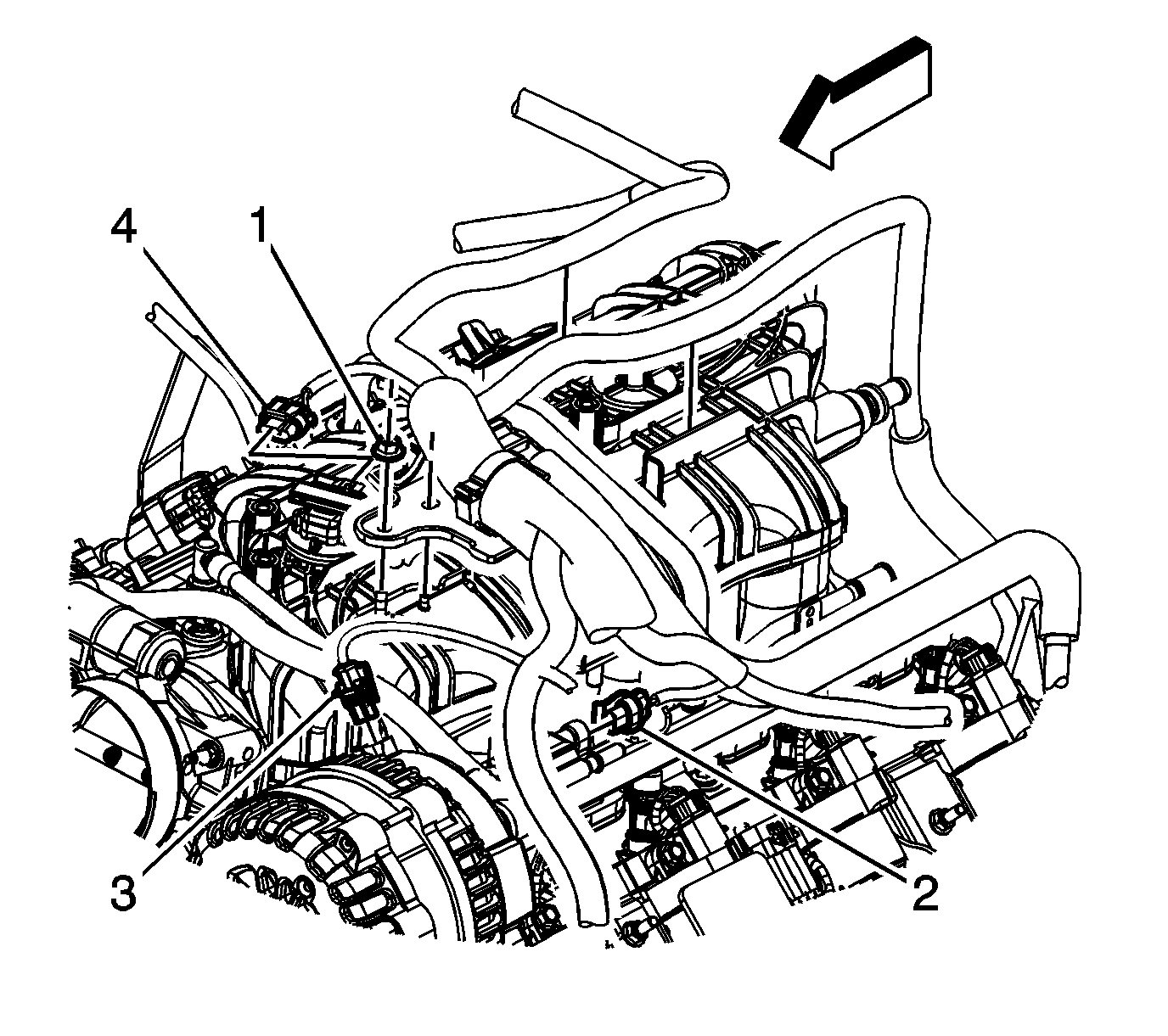

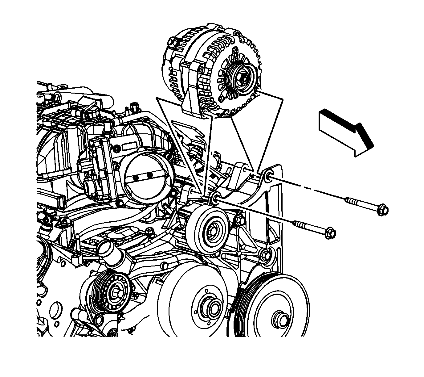

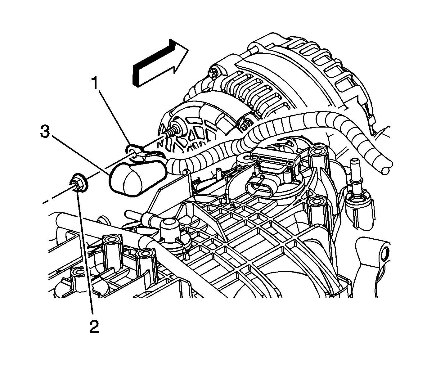

Since you had the alt installed by a mechanic, I will provide the directions so you can do it at home. The attached pics correlate with the directions.
______________________________
2007 Chevy Truck Tahoe 2WD V8-5.3L
Generator Replacement
Vehicle Starting and Charging Charging System Alternator Service and Repair Removal and Replacement Generator Replacement
GENERATOR REPLACEMENT
REMOVAL PROCEDURE
pic 1
1. Disconnect the negative battery cable.
2. Remove the intake manifold sight shield.
3. Remove the accessory drive belt.
4. Disconnect the engine harness electrical connector (3) from the generator.
pic 2
5. Reposition the generator battery jumper cable boot (3).
6. Remove the generator battery jumper cable nut (2) from the generator.
7. Remove the generator battery jumper cable terminal (1) from the generator stud.
pic 3
8. Remove the generator bolts.
9. Remove the generator.
INSTALLATION PROCEDURE
pic 4
1. Install the generator.
2. NOTE: Refer to Fastener Notice.
Install the generator bolts.
Tighten the bolts to 55 N.m (41 lb ft).
pic 5
3. Install the generator battery jumper cable terminal (1) to the generator stud.
4. Install the generator battery jumper cable nut (2) to the generator.
Tighten the nut to 9 N.m (80 lb in).
5. Position the generator battery jumper cable boot (3).
pic 6
6. Connect the engine harness electrical connector (3) to the generator.
7. Install the accessory drive belt.
8. Install the intake manifold sight shield.
9. Connect the negative battery cable.

Okay, took alternator off and had it exchanged at AutoZone. They could not test it due to not having the right adapter for a Tahoe. I got the new alternator put on. I put a new negative terminal on the negative wire to the battery. At the front of the motor on the right side, directly below the air intake housing there is a bolt screwed into the block. The Neg wire from the battery connects to it along with a 12 awg black/white and 18 awg gray or black "not sure" wire. The ring terminal crimped on the 12 awg and 18 awg did not look very good so i cut it off, restriped wires and crimped a new ring terminal on it. Started the Tahoe and we are charging! Have my code reader hooked up monitoring voltage and it staying at 14.5 to 14.6 volts. I have headlights off. Cab lights off and A/C off. One thing i noticed when checking voltage at the alternator is when the compressors for the shocks turn on to level out the vehicle it causes the alternator to jump up to 14.9 to 15.1 volts. The shock compressors usually does not turn on very often. Just when you initially start the vehicle to level it out.
Oct 29, 2020 at 4:43 PM
That is great. Also, that is normal for the voltage to jump up when those kick on. The PCM will do what is called duty cycle the alternator. What that means is when the load/demand is higher it will pump up the output so that it is sure to be able to carry the additional load.
