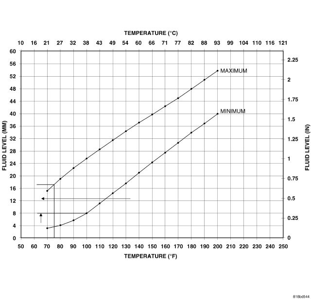

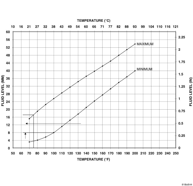

The only issue on my 2013 is there is no plug on top of the transmission for access.
Aug 13, 2018 at 11:54 PM
STEVE W.
  • 15,351 POSTS
Check way down on the front side for a very short tube with a cap on it. It is not easy to see where it is hidden. On the 2014 Journey we have (same drive-train) it is all black and tucked into a notch where you cannot see it.
Aug 14, 2018 at 12:14 AM
KGETZ
  • 104 POSTS
Is it one of those setups where you can fill it until fluid leaks out then you know it is full? Like a 4x4 vehicle.
Aug 14, 2018 at 12:33 AM
STEVE W.
  • 15,351 POSTS
If you are talking about the Caravan and Journey, both are filled and checked through the capped tube.
Aug 14, 2018 at 2:22 AM
KGETZ
  • 104 POSTS
If I were to get to the cap, how can I tell if it is full or needs filled?
Aug 14, 2018 at 1:21 PM
STEVE W.
  • 15,351 POSTS
That video shows how to make a dip stick to check it. To do it by the book you need to know the current transmission temperature, some have that as a visible item in the DIC under vehicle information. Otherwise just check it cold and look at the chart. It uses ATF+4.
