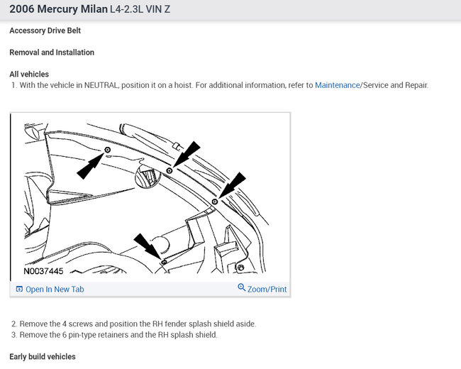

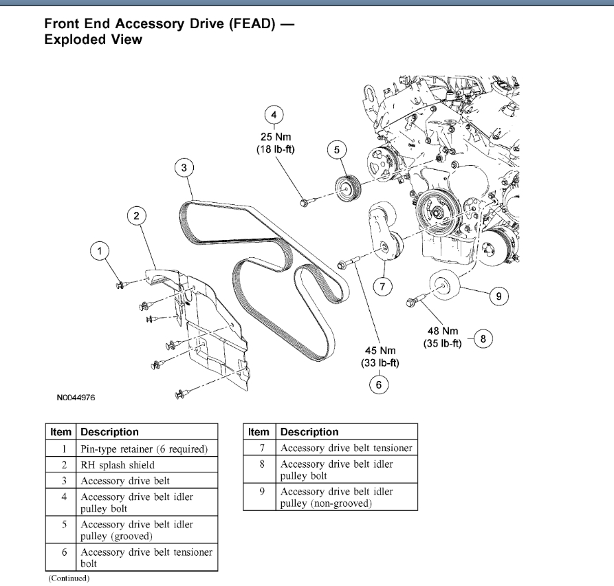

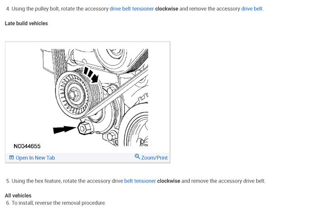

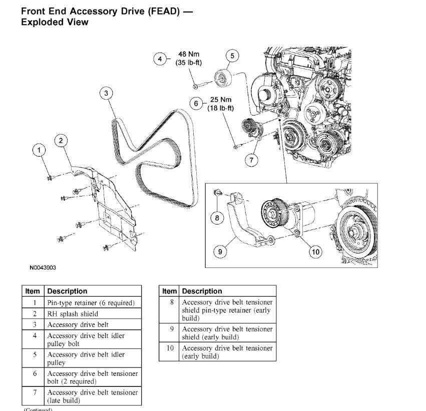

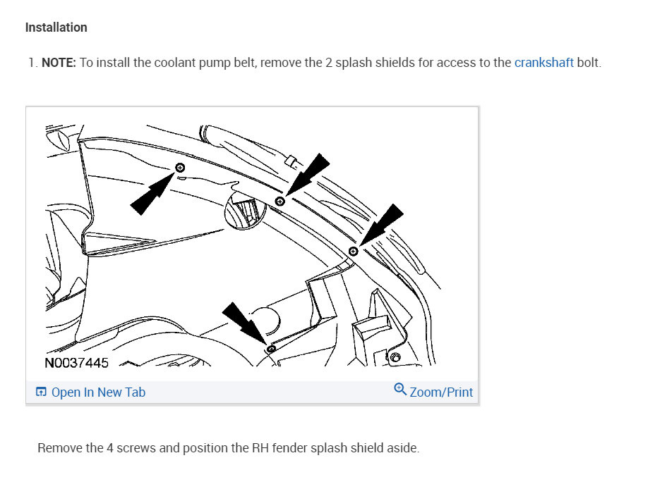

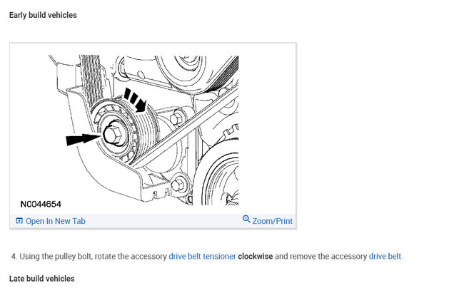

Belt fell off during a long drive. Need the diagram to replace and any instructions necessary. I can't seem to find info on this car.
Oct 3, 2022 at 5:01 AM
  • 55,721 POSTS
There are two different engines (4 and 6 cylinder), so I got them both for you. here is a generic guide to help walk you through the steps with instructions for your car in the images below:
Check out the images (below). Please let us know if you need anything else to get the problem fixed.
