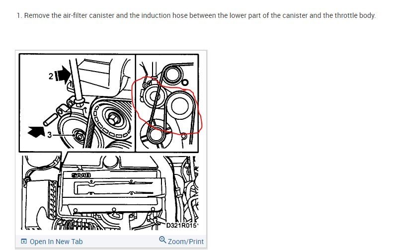

I need to gauge where an oil leak or other fluid leak is coming from. I was stranded because what was thought of to be a broken serpentine belt was actually a belt that slid off. I'm told possible culprits are the idler pulley (?), Crankcase or valve cover gasket. I'm familiar with the VCG job, but clueless to the others and my skill level at performing them.

You need to pressure wash the front of the motor and then monitor the fluid leak to determine if it is either coolant or oil.
https://www.2carpros.com/articles/engine-is-leaking-oil
You can go to a car wash and do it yourself. Get it good and clean and then monitor it every day

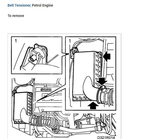

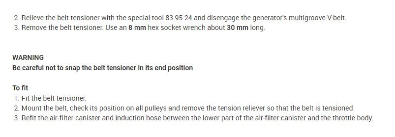

I attached the procedure for you for replacing the tensioner. The belt comes off when the tensioner is worn out and does not retain the tension.
https://www.2carpros.com/articles/serpentine-belt-tensioner-replacement
Roy.

You need to replace the tensioner and the belt. That will stop the nise.

Yes. I would do that. That is the original issue. I am surprised the shop did not do this for you.
We always replace the tensioner and the belt together when there is an issue of noise and falling off.
