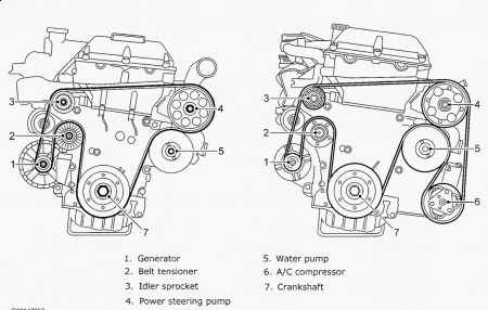

I need the serpentine belt routing diagram for this 99 Saab 9-3 w/ 2.0L turbo w/AC
