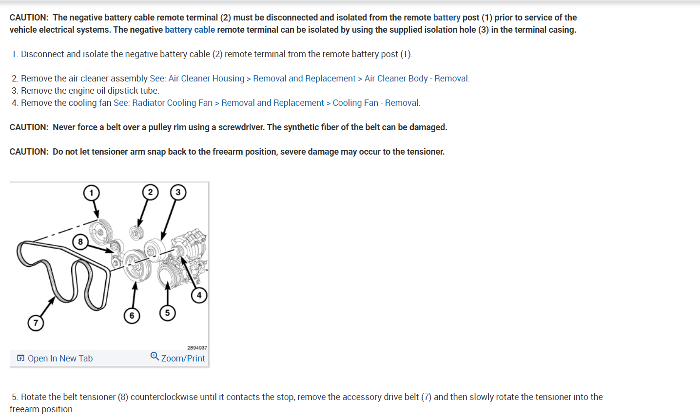

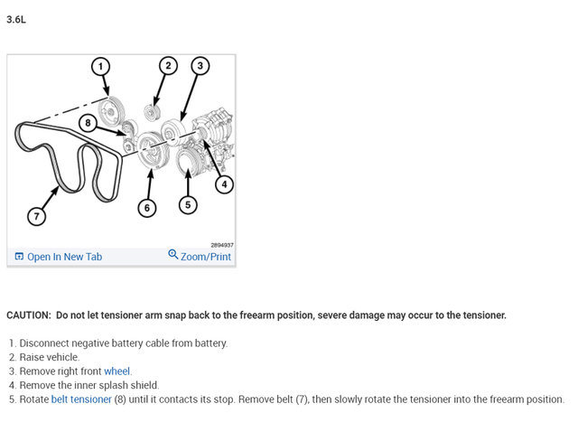

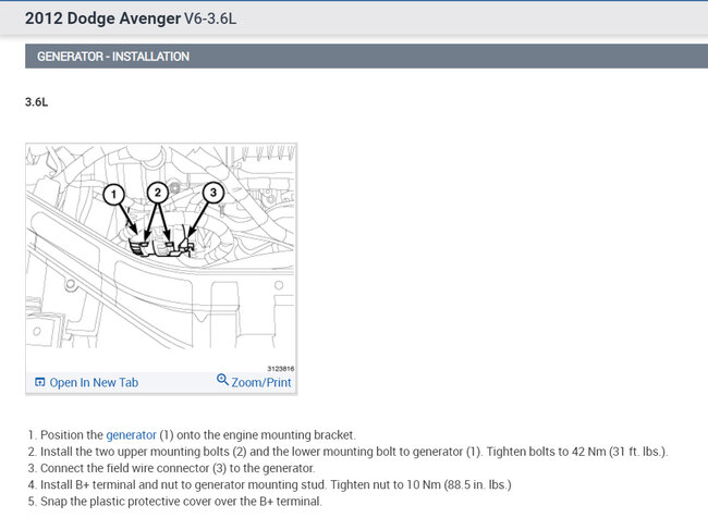

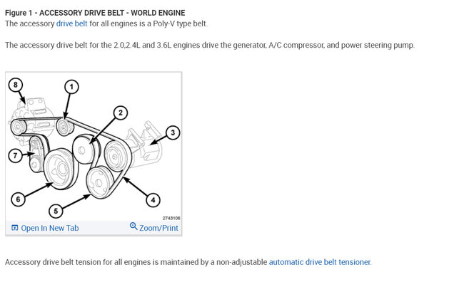

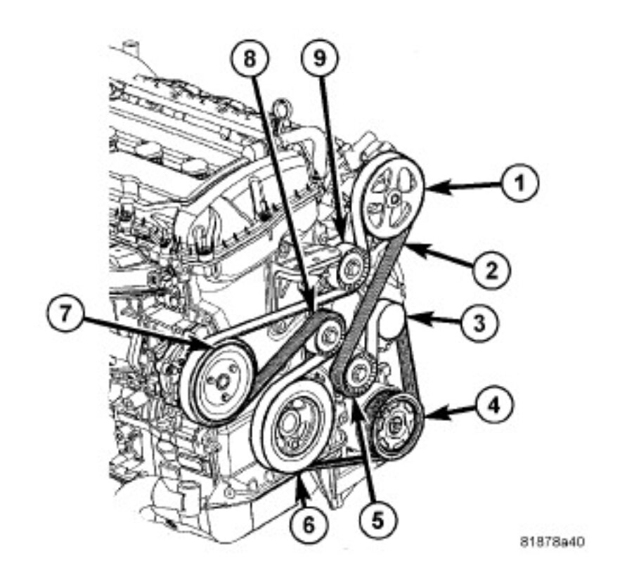

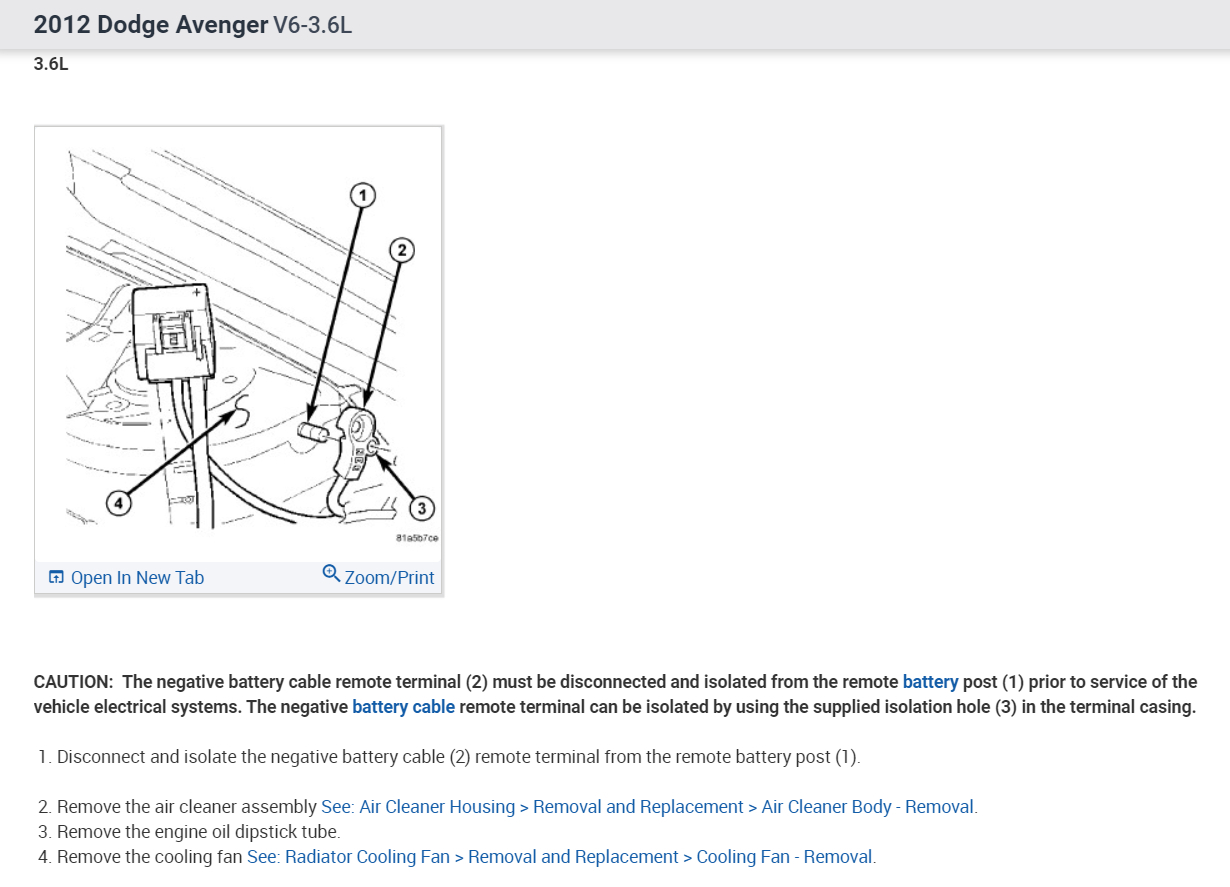

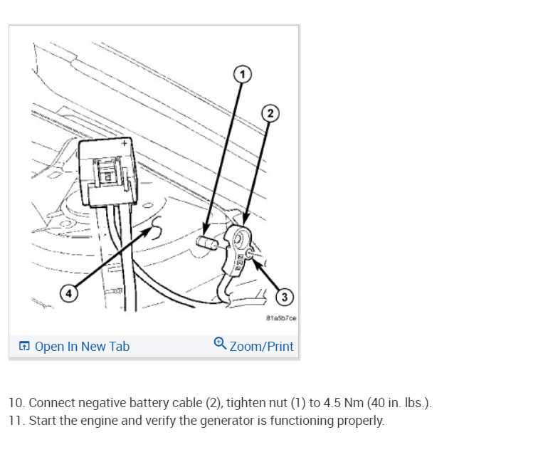

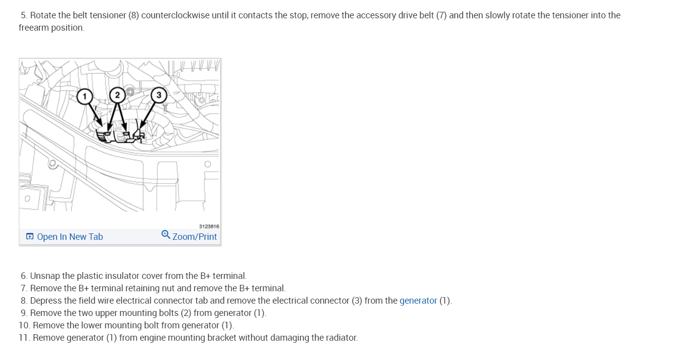

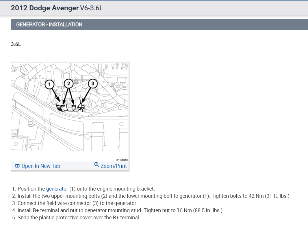

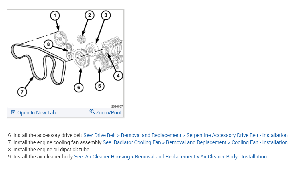

So my boyfriend changed my serpentine belt about a month ago and I wanted to make sure it was put on right because now my alternator won't charge the battery and it's a brand new alternator .. my car dies out but the ABS light and brake light and the little lightning bolt as well I just wanted to double check the serpentine belt to see if that's the issue thank you
Jan 4, 2023 at 11:00 AM
  • 55,433 POSTS
Sure, here are the serpentine belt diagrams so you can make sure the installation is correct. I have included all belt diagrams. Check out the images (below). Let us know what happens and please upload pictures or videos of the problem. You could have a defective alternator here is how to change it out as well
