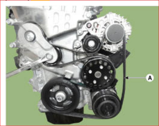

Need diagram.

Hello, I'm Danny.
Although you didn't specify if your car is a 1.4, 1.6, or 2.0 liter engine below I've attached a diagram for a 1.4 liter. Here is a tutorial showing how to remove and replace:
If this doesn't look familiar get back to me with your correct engine size.Hope this helps and thanks for using 2CarPros.

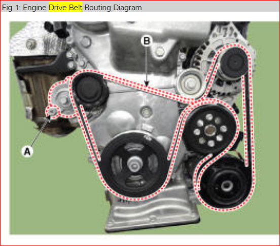

It's 2.0.

Hello again,
Here is a picture for the 2.0L.
Hope this helps and thanks again for using 2CarPros.

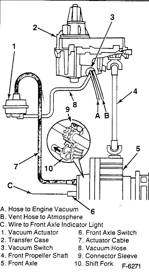

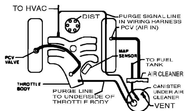

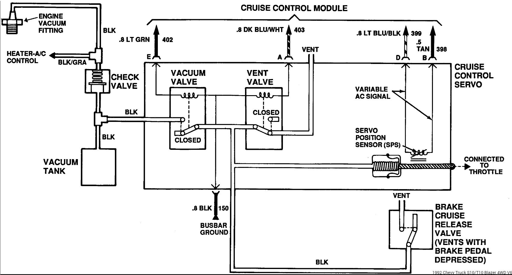

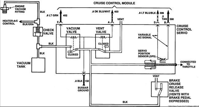

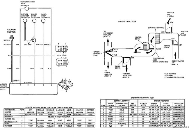

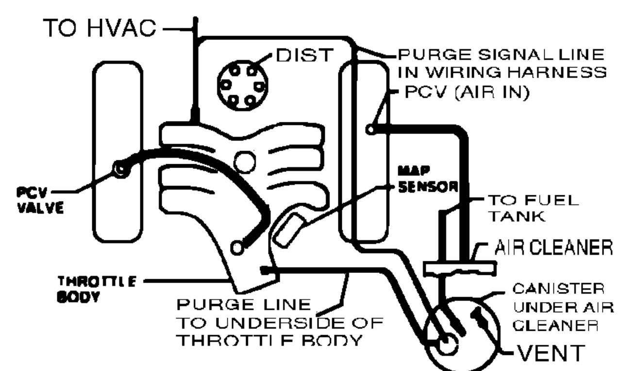

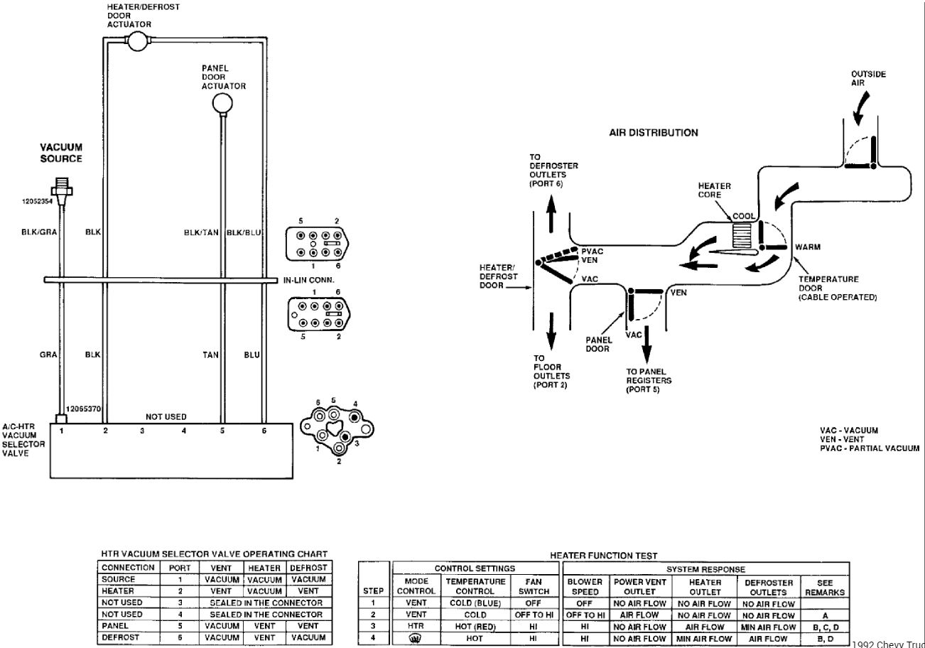

Need a vacuum diagram for a 92 s 10 blazer 4 4.3 vortec. I need to go to work. I don't have time to go to the store. Can anyone help?

Just found your question, Please use this link to ask this as a new question for a new vehicle:
Attached are the diagrams for a 4.3, but if you need more help please use a new question. Thank you.
