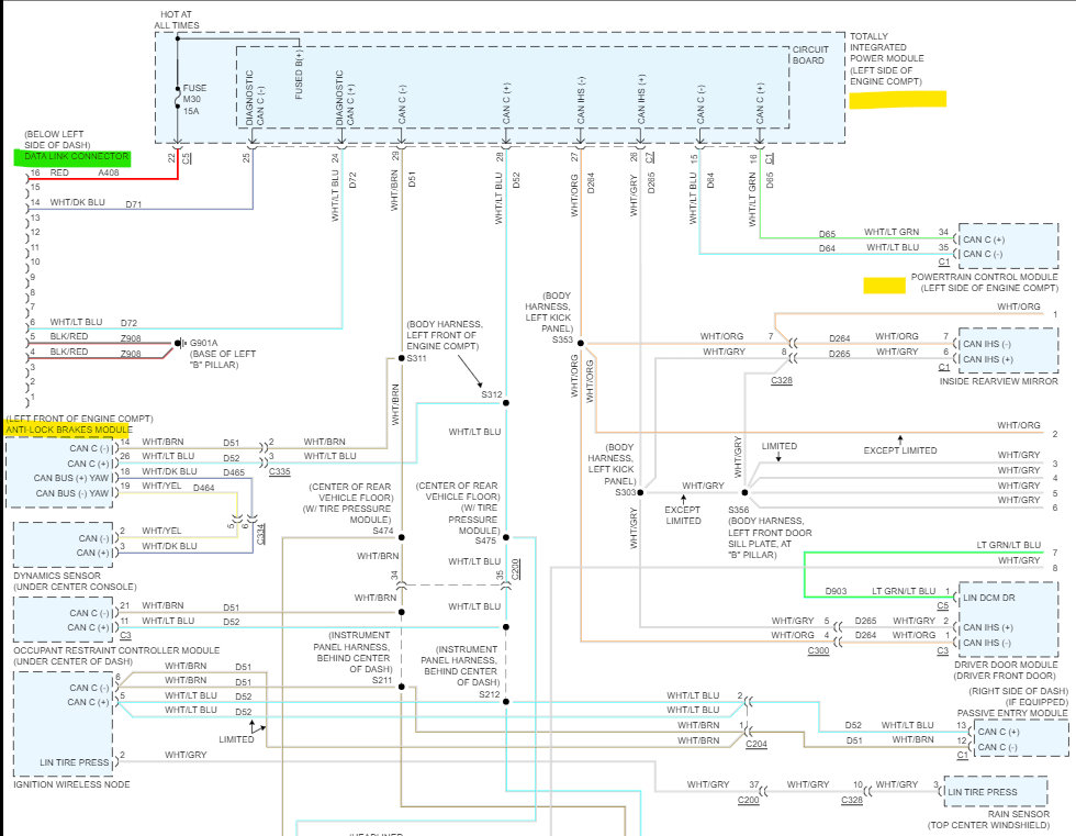

The component near the driver side tire I think you're meaning, that is the Totally Integrated Power Module, Its basically the Body Control Module, but it powers up everything. And they have a lot of problems and always have. They are on a Network with the Engine Control Module.

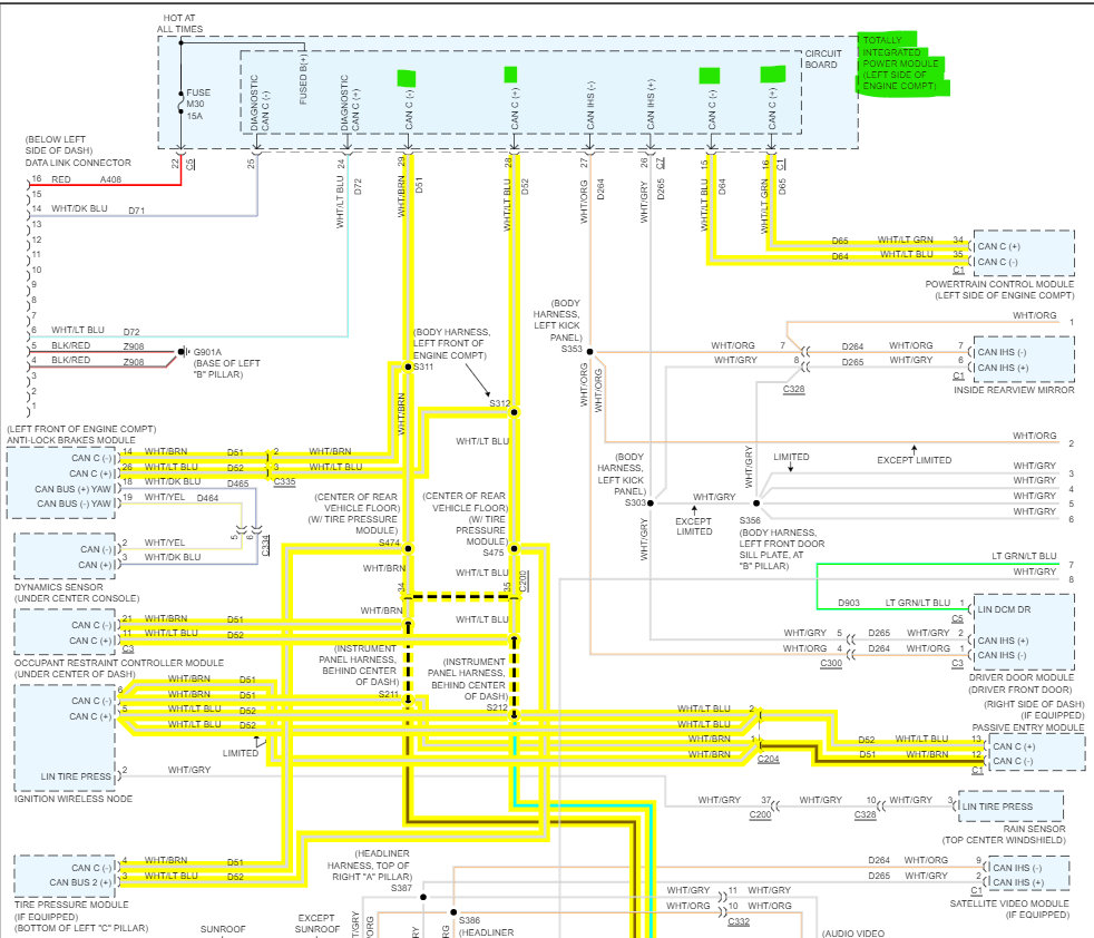

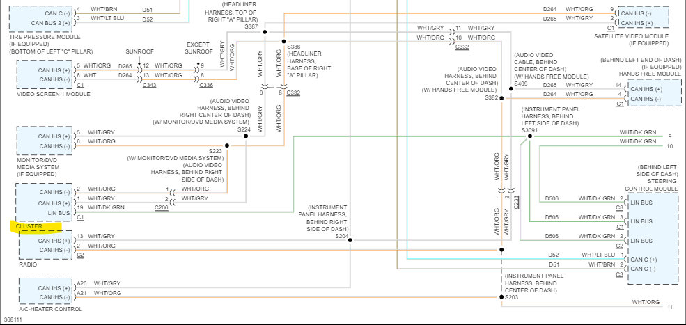

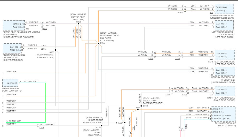

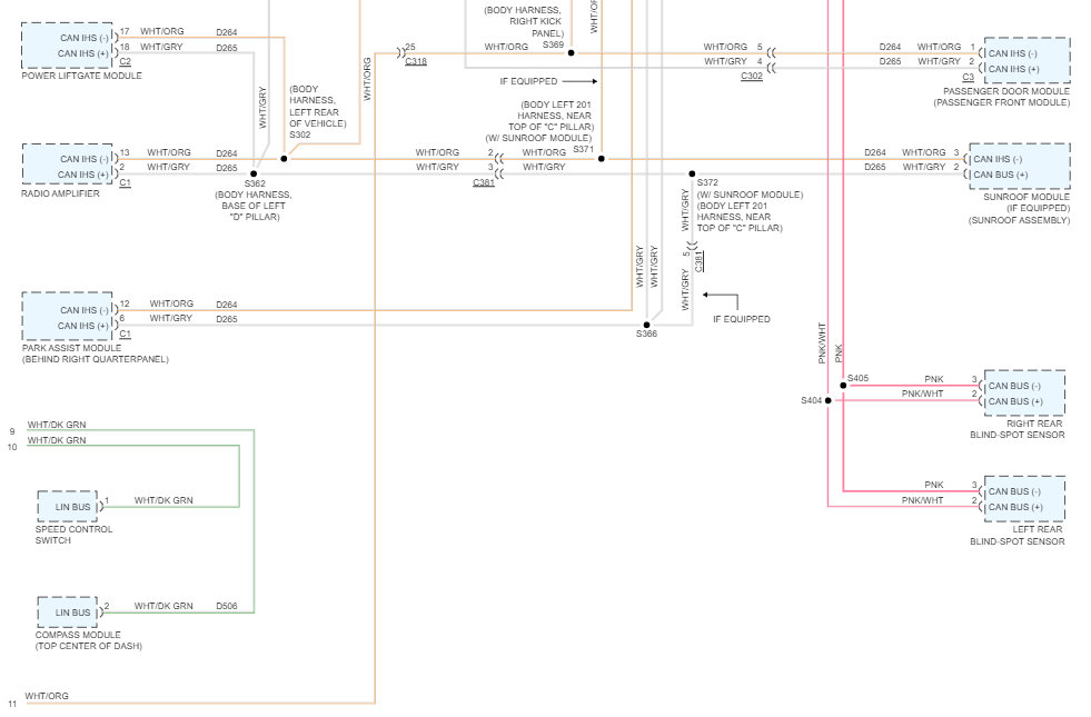

Just to give you an idea of the Computer network in your vehicle. Pages 1 and 2 is the Totally Integrated Power Module (TIPM) and the Engine (Powertrain Control Module). Every Blue box on pages 1 to 4 is an Electronic Control Module in the Vehicle. Page 5 shows you more in depth what the TIPM does. If you notice on the top right is the Powertrain Control Module. Those 2 (in yellow) wires are the Network wires that run into the TIPM. From there all the other modules in the vehicle are connected to it. So, if there is a problem with the TIPM, all the data has to go through it to get to the Powertrain Control Module (ECM). It's very complex.
The ECM is near the TIPM, they are both on the driver side engine compartment,
