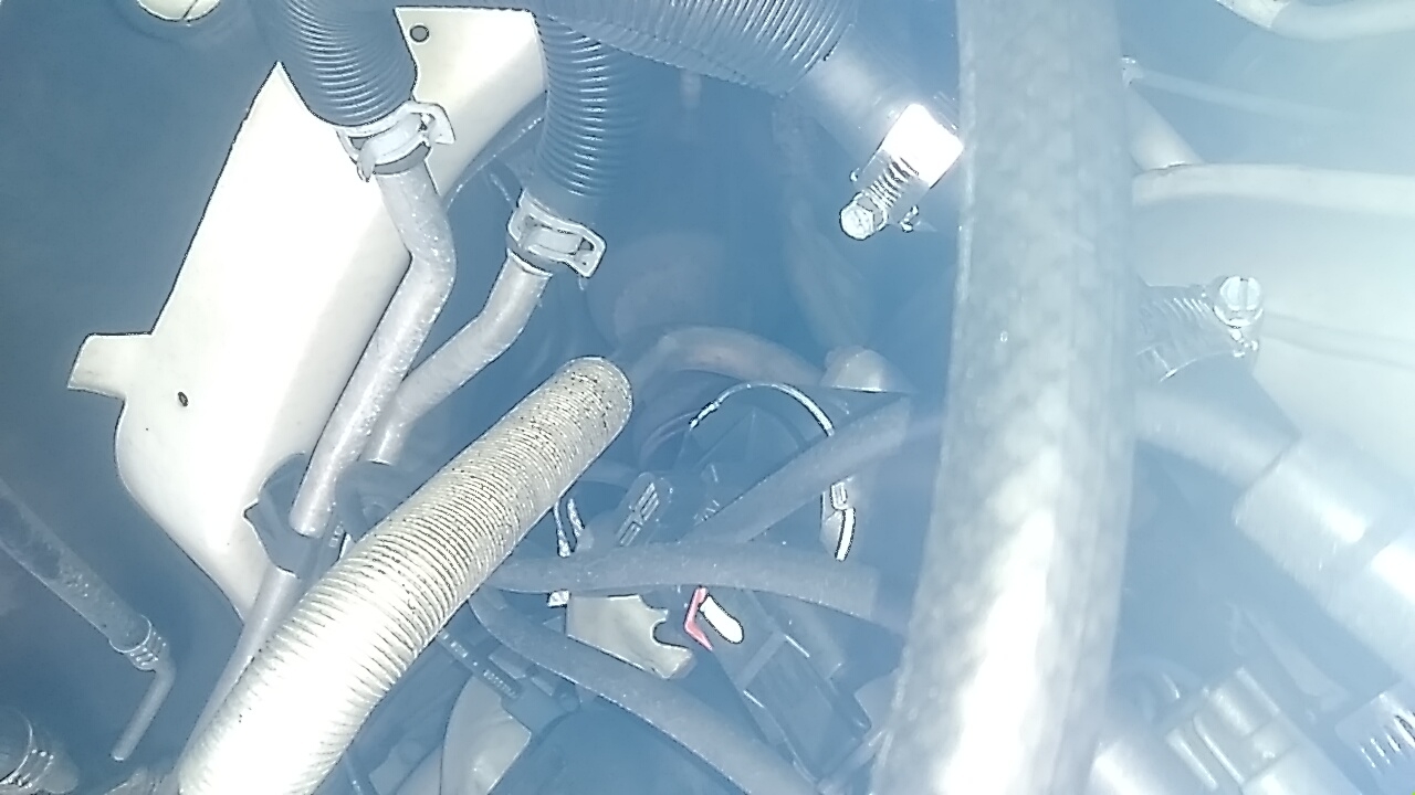

They antifreeze hose blow on both y rubber hoses,and water pump leaking, mobile mechanic broke bolt, radiator was leaking at top,side hose near radiator silver cap repair new radiator,small hose have try to make it work that's only why to tell you.

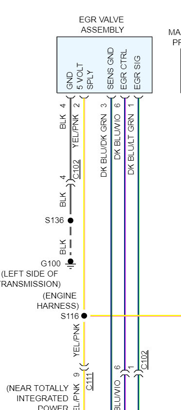

The P0403 is an EGR "circuit" code, which means there is a wiring issue to the EGR valve. Since you already replaced the valve and gasket, there must be a wiring issue. But I don't think a non-functioning EGR valve will cause the issues you are having. The P1404 is an EGR valve closed code.
With all these issues and you have already replaced the spark plug and wires twice, the crankshaft position sensor and the EGR valve and you're still having stalling/running problems then there is something else going on here.
There might be a problem in the wiring harness and that's why you're getting so many different codes like this.

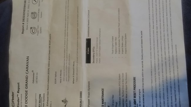

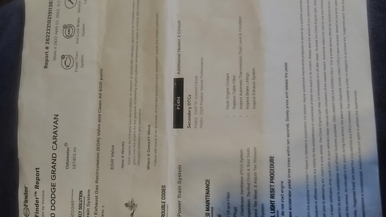

April 12,2022,187403 fix finder report auto zone p1404 I don't know but send image , secondary DTCs po403 EGR "A" control circuit,po404 EGR position sensor performance.

Any code that has "Circuit" in it is usually a wiring issue or the engine computer detecting some sort of voltage issue. So, if there is a wiring issue to the EGR valve and the valve is not being activated, that's what is causing the 2nd code P0404. Below is a picture of the EGR valve and where it is. The wiring to the valve will need to be checked, since it's a new valve, the tubing to the EGR valve may be clogged up with carbon build up, or it has a wiring issue, and it is not able to be commanded on.

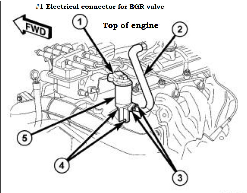

Below is a video of a 2005 Dodge Caravan but it has the same EGR valve that yours does. He is showing how to test these valves.
https://www.youtube.com/watch?v=Ty29y3R8fZI
May 26, 2022 at 5:50 AM
WAYVAN
  • 22 POSTS

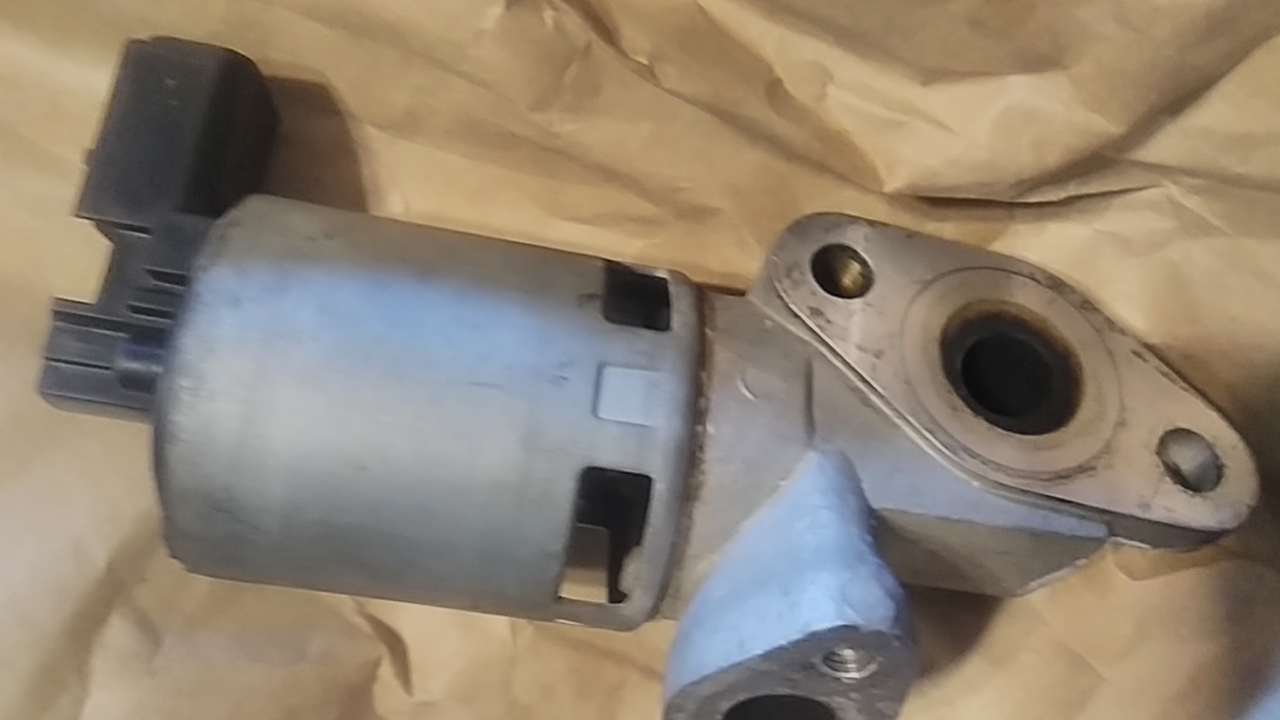

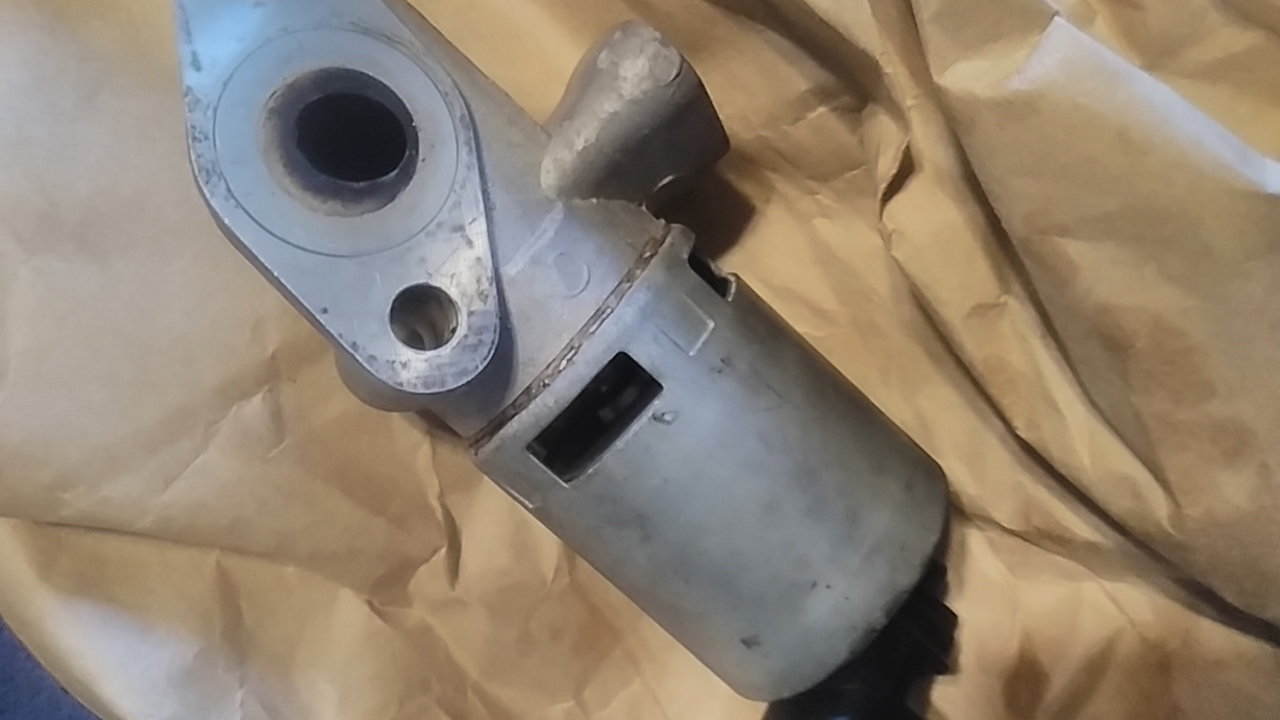

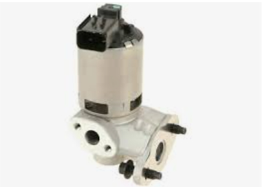

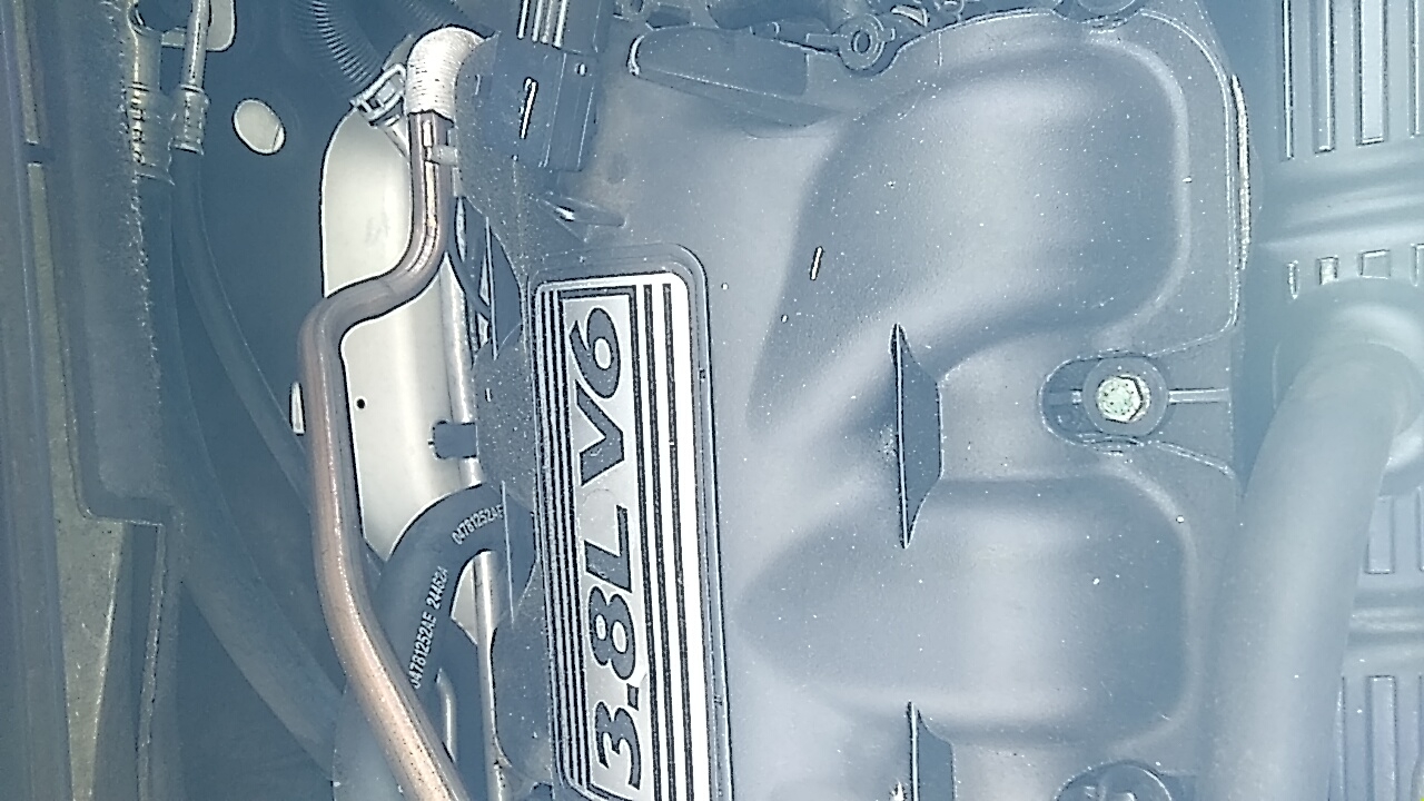

Hey, I replace that it black stuff on it, this is old one.
May 26, 2022 at 6:47 AM
WAYVAN
  • 22 POSTS
l not good at making good photos.
May 26, 2022 at 6:50 AM
WAYVAN
  • 22 POSTS
So what do think is next too check?
May 26, 2022 at 6:51 AM
WAYVAN
  • 22 POSTS

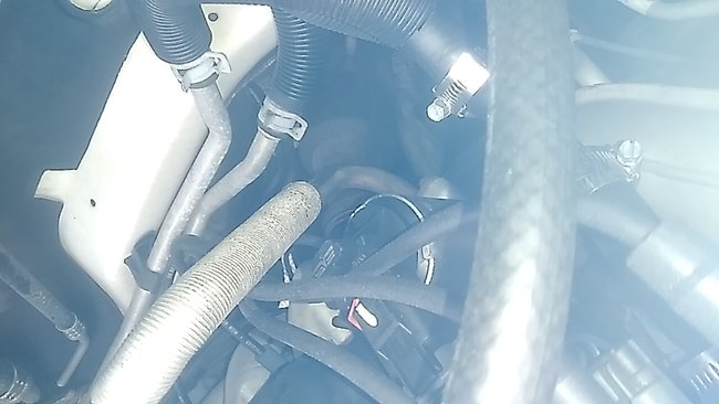

I looked at video but that vehicle was near the oil but on my vehicle it's near battery on driver's side is it possible that there more one.
May 26, 2022 at 7:10 AM
AL514
  • 5,639 POSTS
It's in a different spot in the video but it is the same type of valve. The valve needs to be checked for certain voltages. Do you have a multimeter to check the voltage readings at the harness plug for the EGR valve?

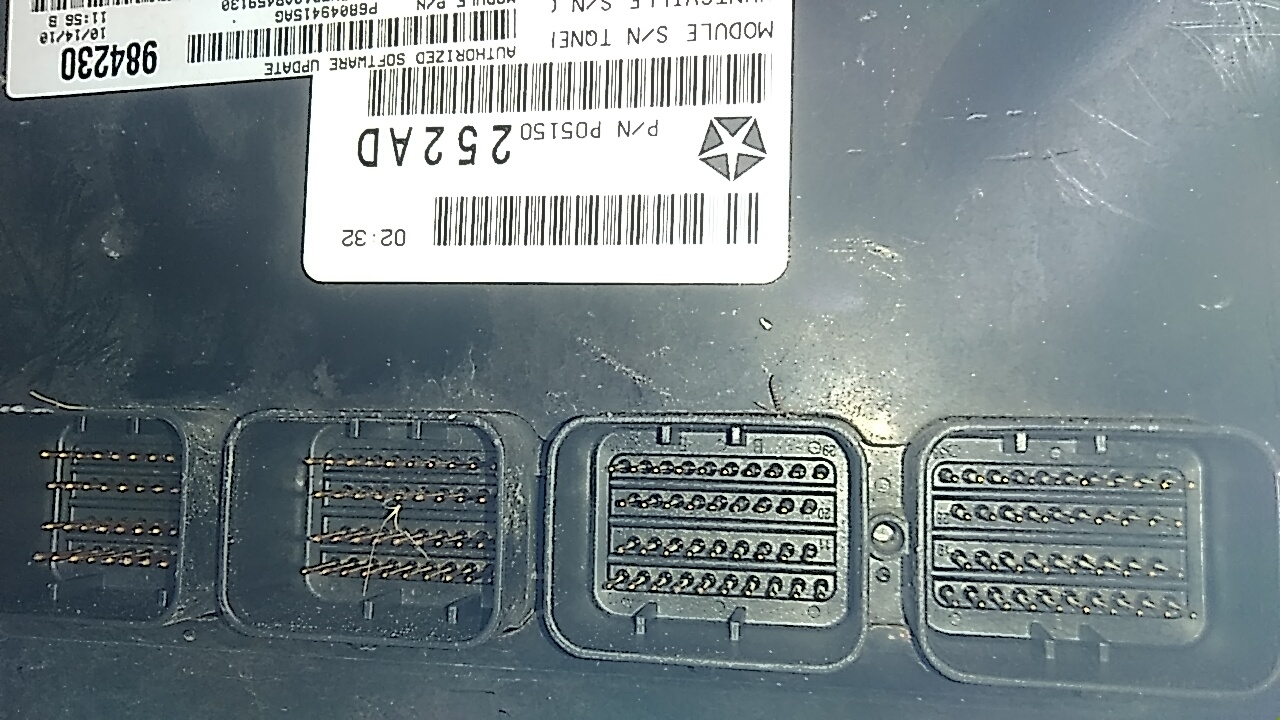

That is the old PCM engine computer, crankshaft position sensor Sept 29, 2021, and I am looking for a water pump mechanic to remove, replace yet I am still looking. Thank you!

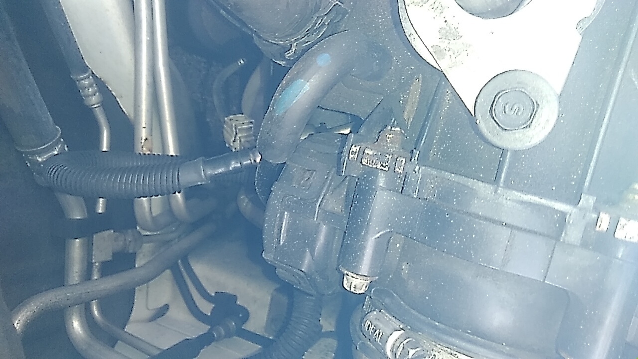

Okay, I can see the water pump bolts onto the Timing Chain Cover. The water pump is probably leaking because of the missing bolt. I'm not sure why he can't drill out the broken bolt and re-tap the whole with new threads and get a little bigger bolt to put in there. That's what I would do. $700.00 is a lot for a timing cover, all due to one broken bolt? That's going to be $2,000.00 for a water pump. What were they going to do for the $1,300.00?

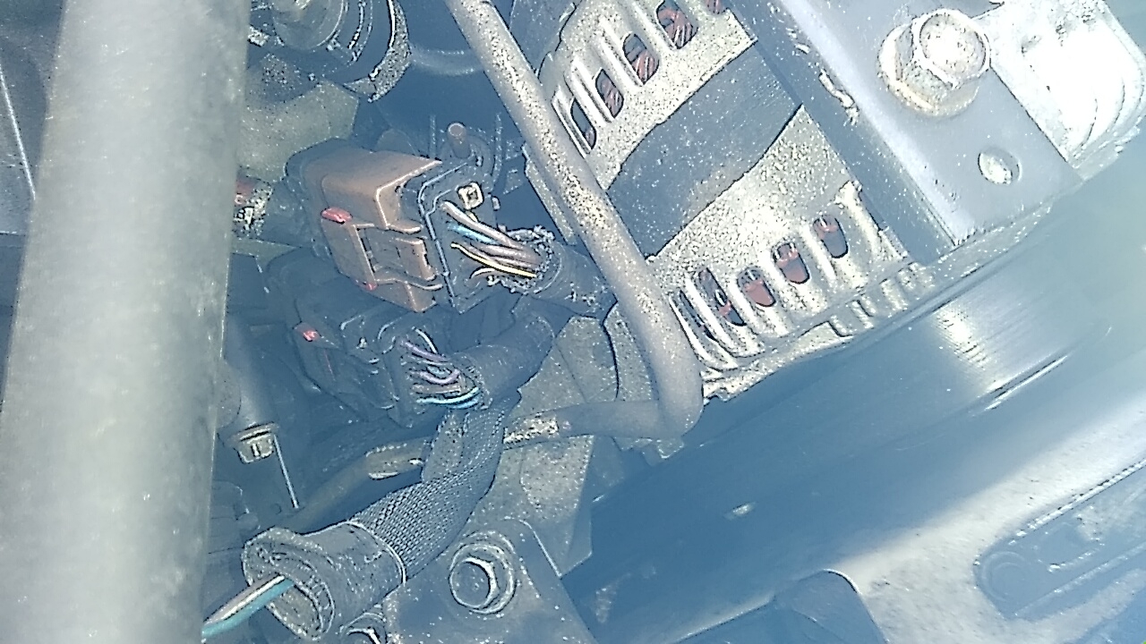

So, I checked connected onboard computer, found faults, ignition circuit, EGR circuit and coolant temperature sensor, connect C102 severe corrosion and thermal damage. replacing harness then retest. My question is, should I stay with or go to the Dodge dealership? because this sounds serious their price $2,904.80 labor $675.00 have two weeks for ordering, the dealership have to make appointment I week out. Thank you!

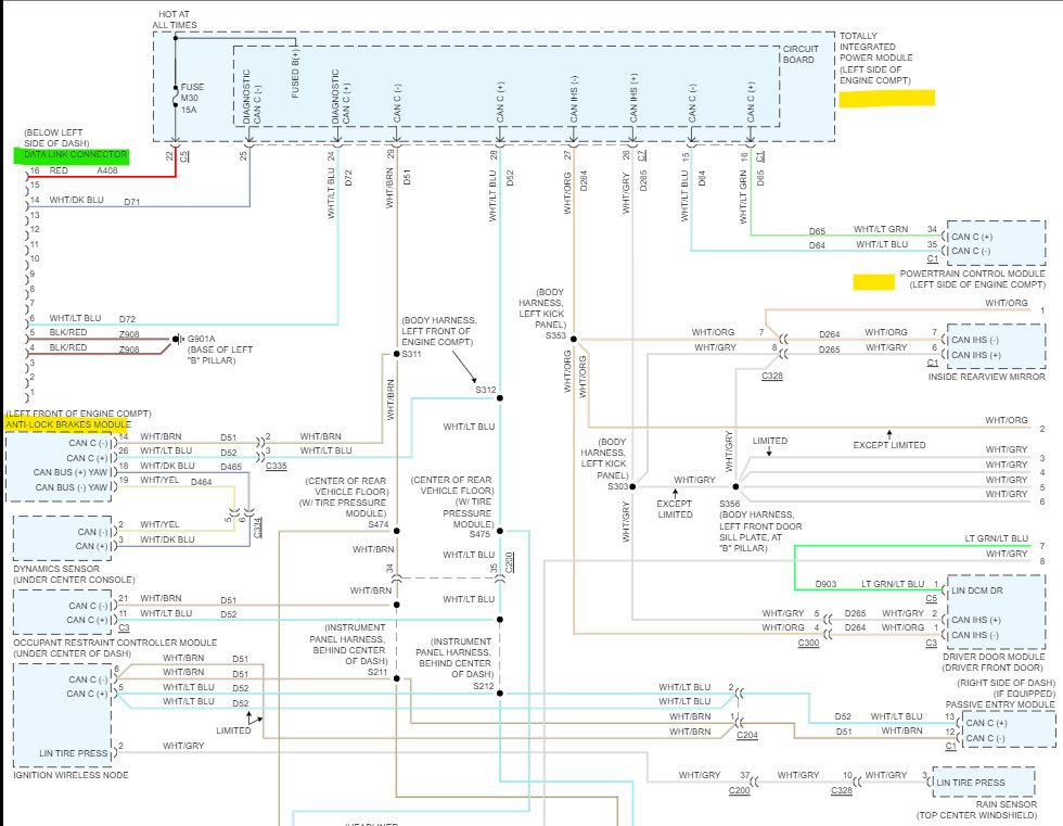

C102 is a 10-pin connector and what they call thermal damage is a melted connector. It looks like they intend on replacing the entire engine wiring harness because they probably can't find the high resistance area that caused the connector to melt. The dealership is not going to give you a payment plan like you mentioned earlier. The price will be the same or higher because labor at dealerships is usually higher. Most likely a bad Ground or Power feed is causing the heat that melted the connector.
The Totally Integrated Power Module which is usually on the driver side in the engine compartment powers almost everything in this vehicle. It would help if you checked the back of all the Fuse panels in the vehicle for any water intrusion. Including the Fuse panels inside the vehicle as well.
One thing you can tell the mechanic to do, is if there was a melted connector, they should use a thermal camera to look for hot spots in the vehicle. It is a very effective way to find other bad connectors/ connections that would cause an ECM connector to melt. It is a new way of diagnosing issues like this. It will speed up the whole process.

The component near the driver side tire I think you're meaning, that is the Totally Integrated Power Module, Its basically the Body Control Module, but it powers up everything. And they have a lot of problems and always have. They are on a Network with the Engine Control Module.

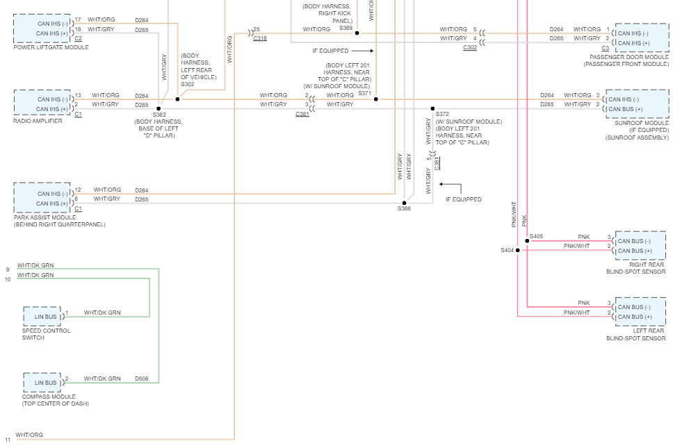

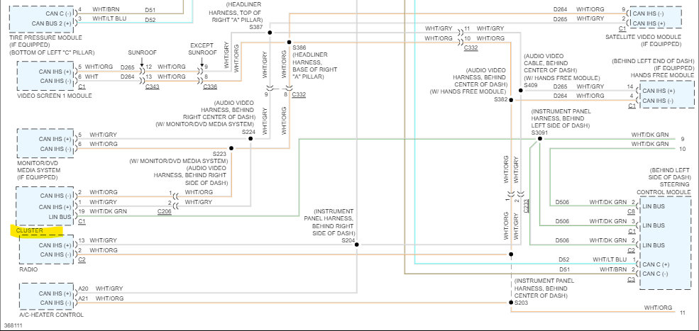

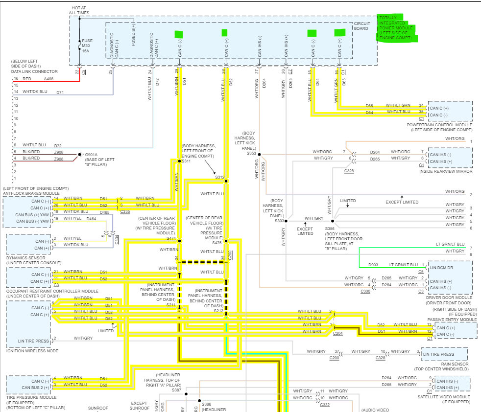

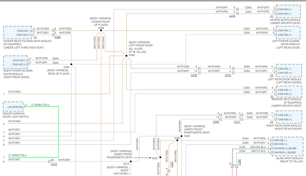

Just to give you an idea of the Computer network in your vehicle. Pages 1 and 2 is the Totally Integrated Power Module (TIPM) and the Engine (Powertrain Control Module). Every Blue box on pages 1 to 4 is an Electronic Control Module in the Vehicle. Page 5 shows you more in depth what the TIPM does. If you notice on the top right is the Powertrain Control Module. Those 2 (in yellow) wires are the Network wires that run into the TIPM. From there all the other modules in the vehicle are connected to it. So, if there is a problem with the TIPM, all the data has to go through it to get to the Powertrain Control Module (ECM). It's very complex.
The ECM is near the TIPM, they are both on the driver side engine compartment,
So, if they are looking for a heat issue, using a thermal camera is a great method of finding hot spots that they wouldn't normally be able to see. Since there are so many different modules and things that can go wrong, that's probably why they just want to replace the wiring harness. They probably think it will be faster than trying to find the actual problem. It could be a loose connector anywhere causing heat issues.
But when they say a thermal event, that is caused by high resistance causing a heat buildup and that's how connectors melt.
This is why it's so difficult sometimes to find problems in newer vehicles. They are built too complex.
