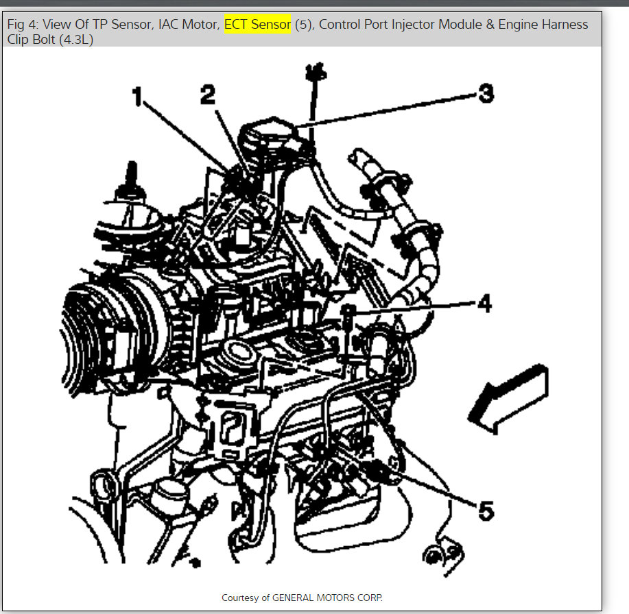

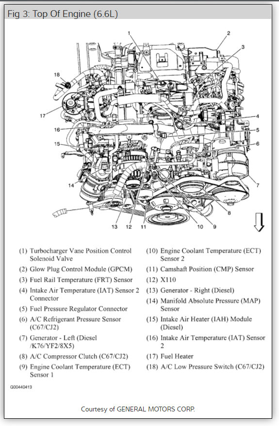

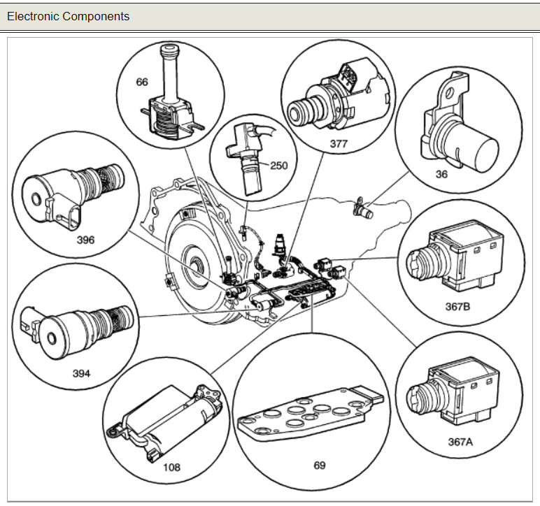

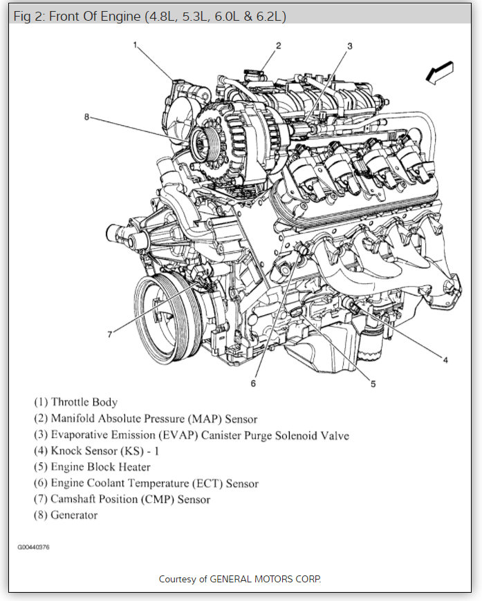

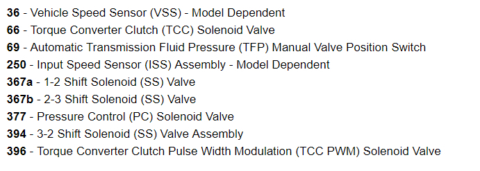

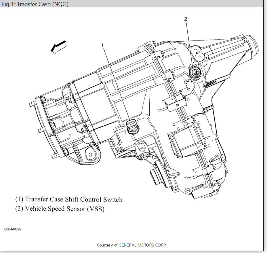

Is there a schematic and labels of all the sensors on the engine and transmission system available for my Vortex engine?

Here are all the sensor location for the engine and transmission that I can find please let us know if you need instruction on how to change or test any of them.
