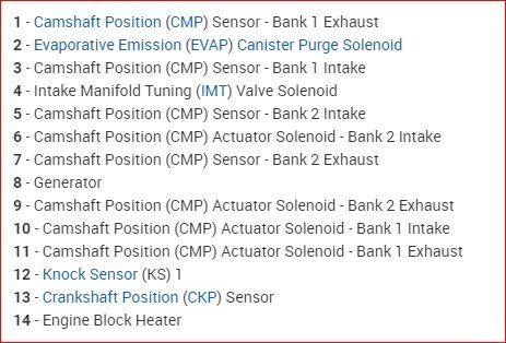

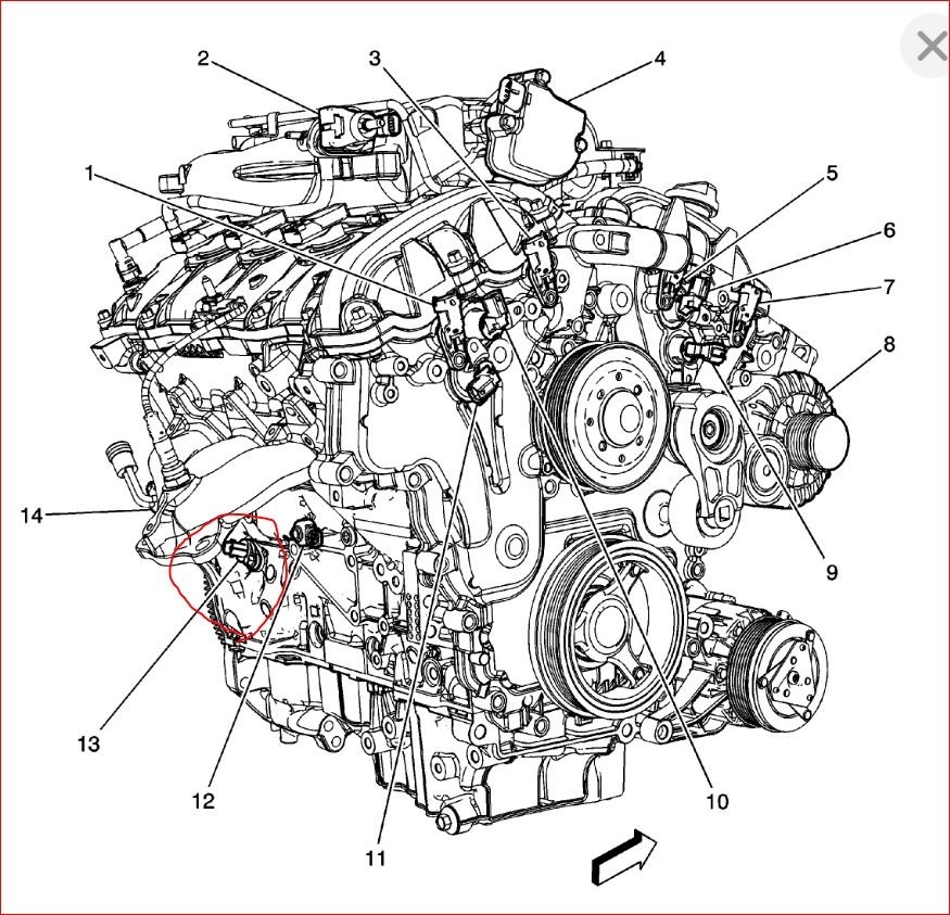

I attached the picture and list. I circled it in red just to try to make it a little easier.
Please let me know if you need anything else. Thanks

Is it on that back of the engine?
May 26, 2019 at 2:03 AM
You engine is what is called a transverse engine which means it is mounted sideways in the engine compartment. So if you are standing at the front of the car, the sensor would be on the back side but technically this would be called the side of the engine or bank 1.
Take a look at the attachment and I circled an arrow at the bottom of the picture. This arrow always points to the front of the vehicle just so you can orient yourself.
Please tell me if you have more questions. Thanks

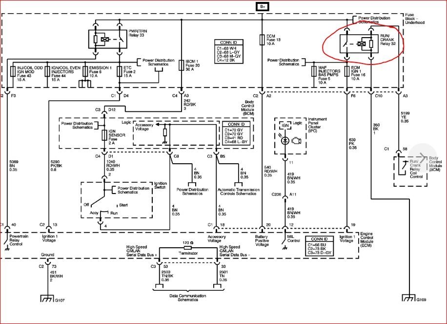

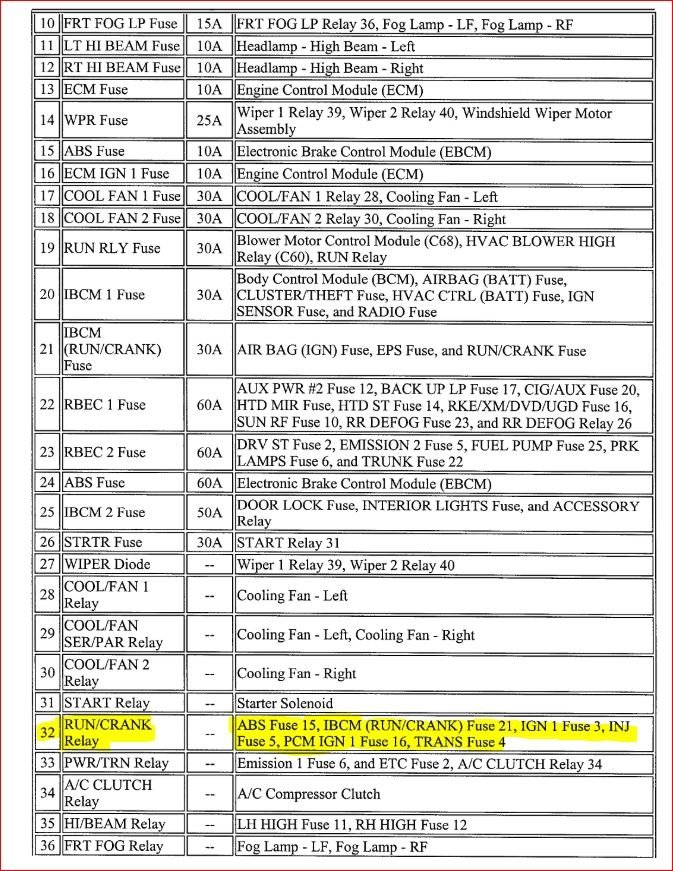

Without knowing the details yet, have you check relay 32? This is the run/crank relay. Also 31 is the starter relay?
Let me know the detail of what you have done so far and about these relays and we can go from there. Thanks
