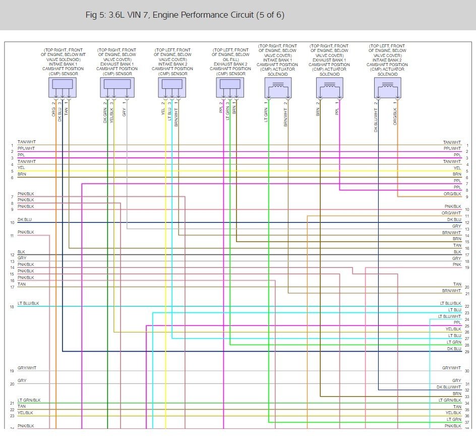

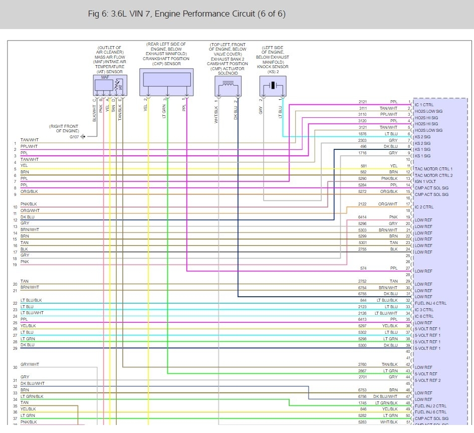

Okay, I have the car listed above. I have code P0017, and P0018 . The car starts up great , and runs great, this car never gave me any issues, my question is , how can I test hall-effect camshaft sensors using a voltmeter?
May 30, 2017 at 2:31 AM
  • 55,770 POSTS

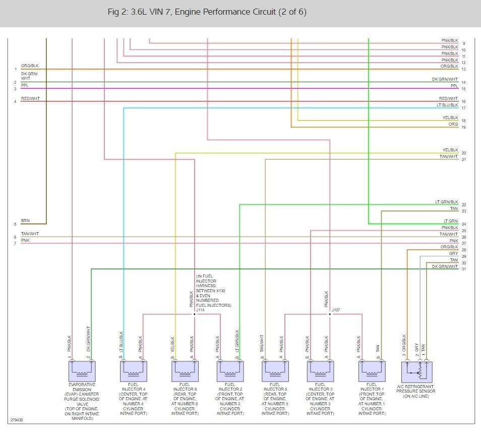

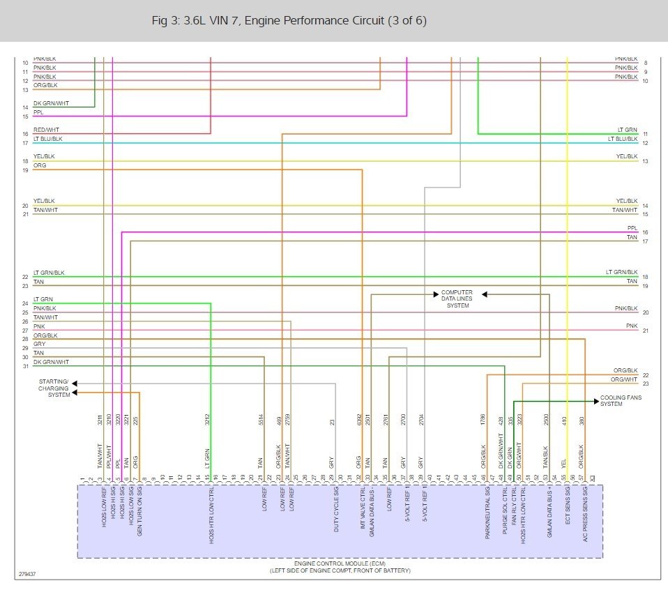

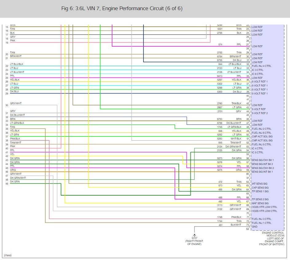

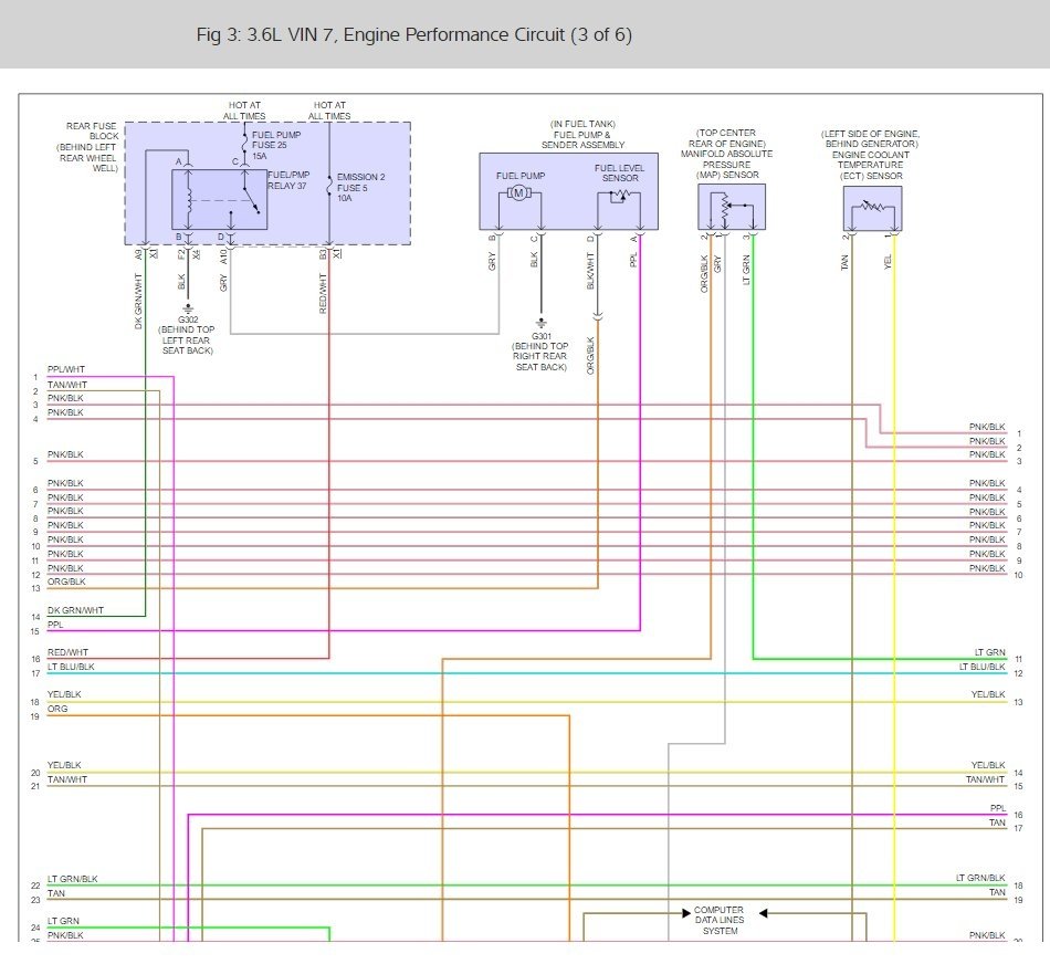

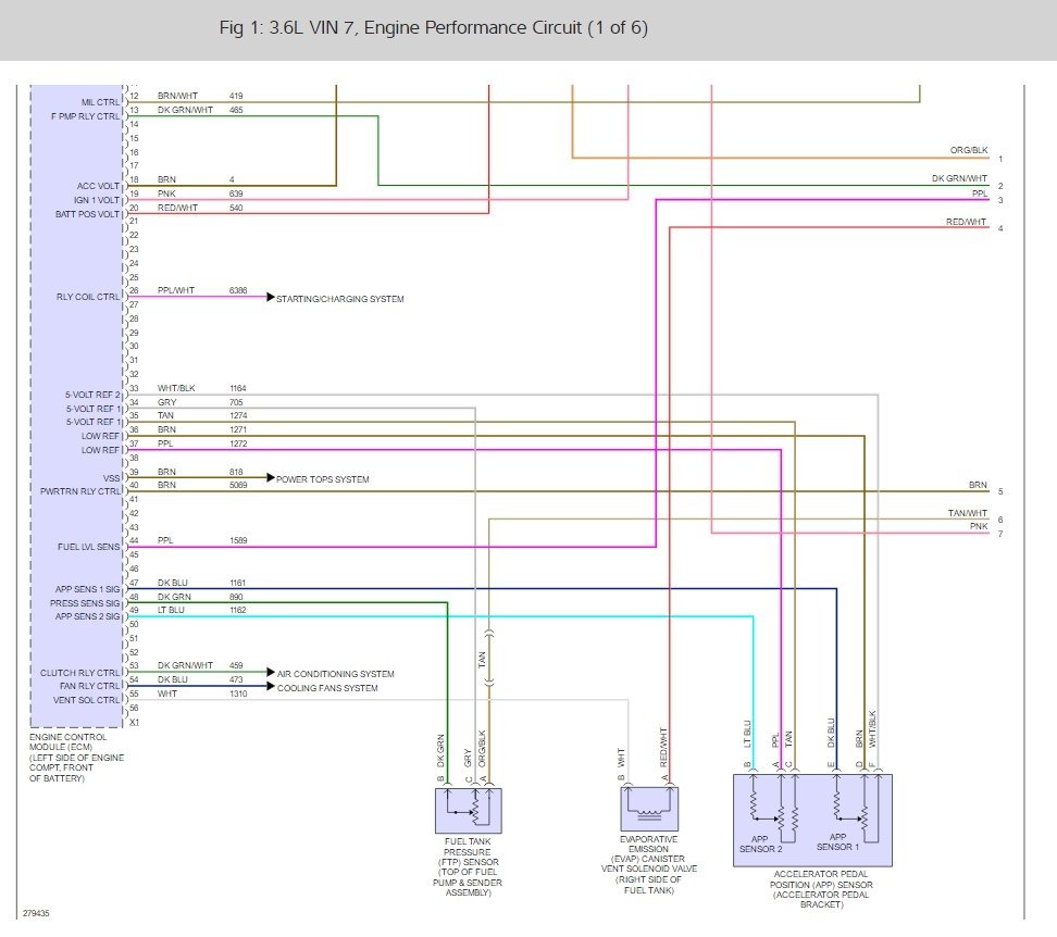

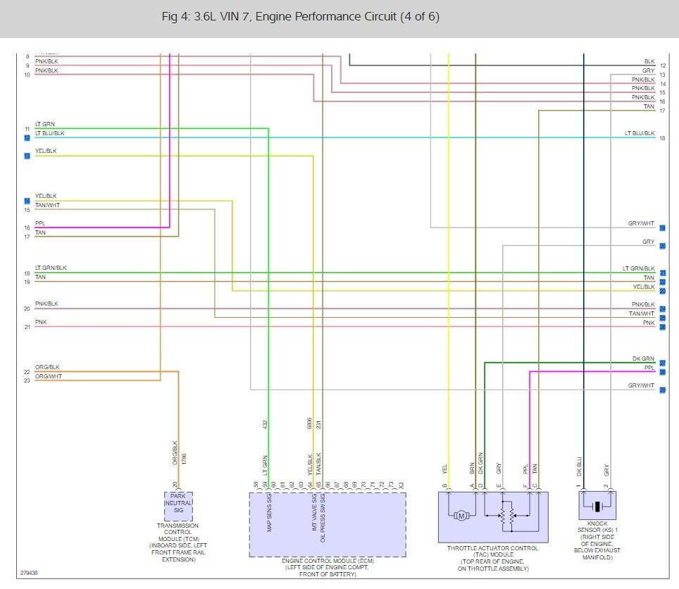

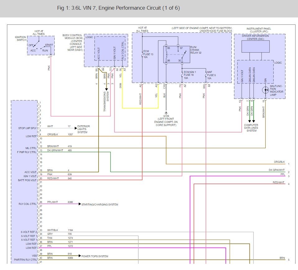

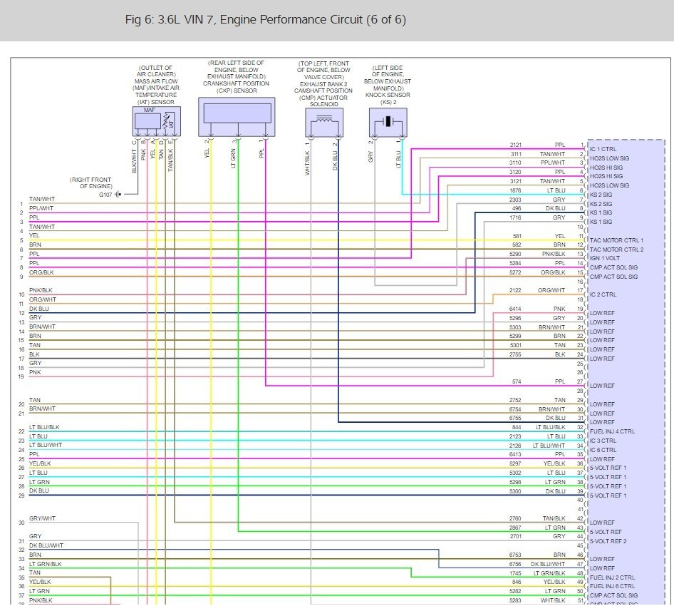

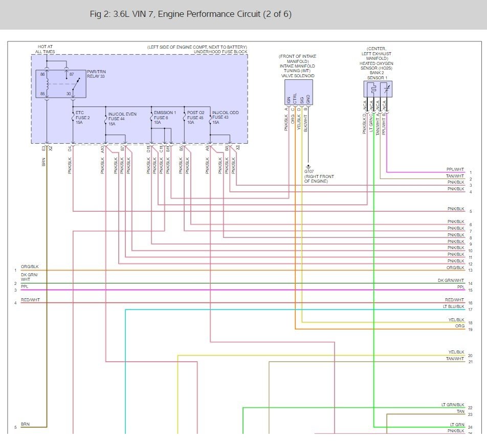

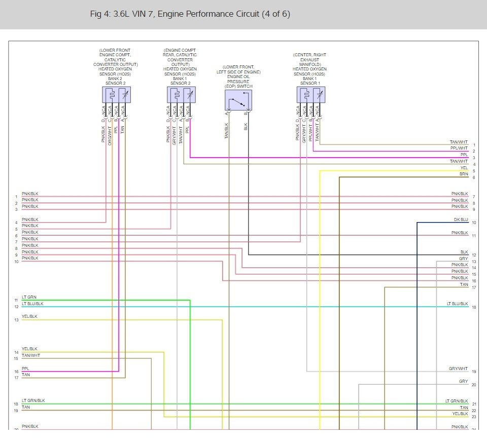

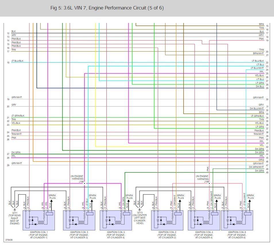

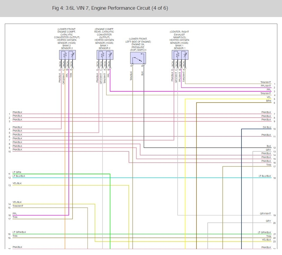

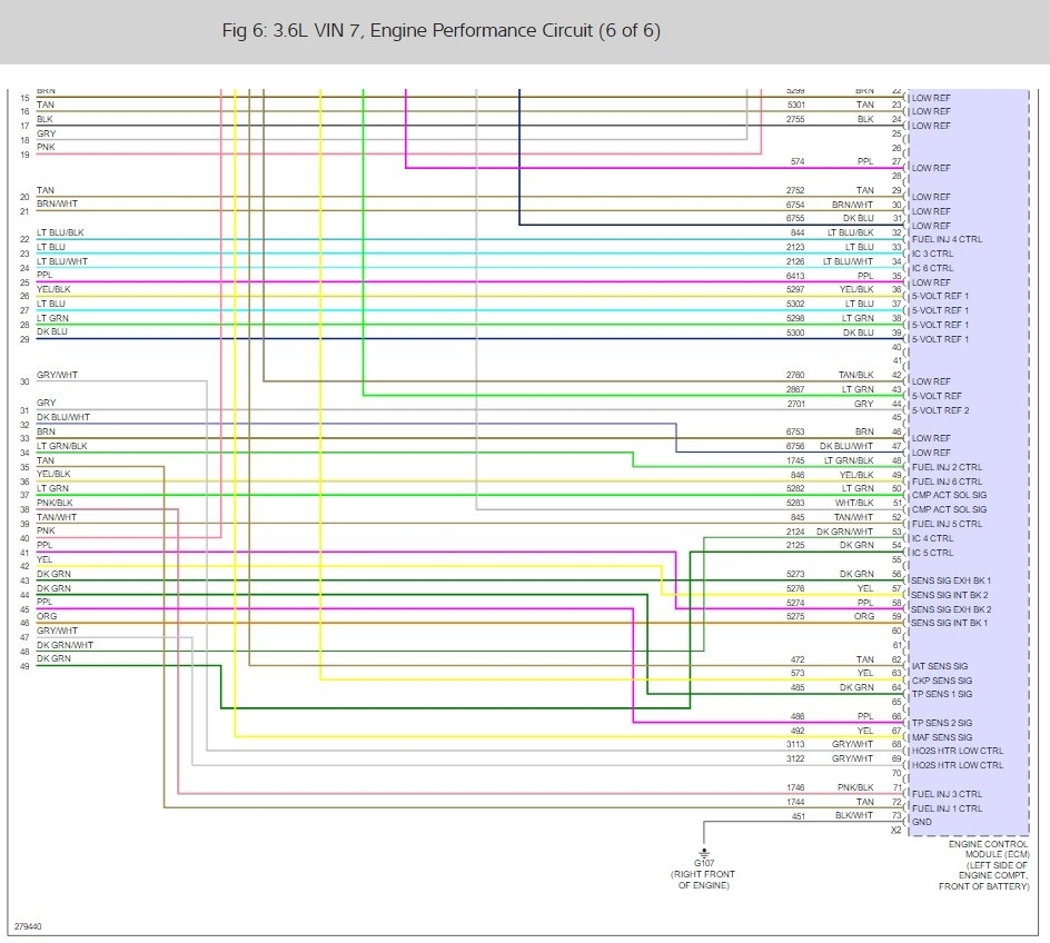

Those codes have to do with the camshaft and crankshaft correlation and are set when the timing chain, guides or camshaft actuators wear out. I have found the engine wiring diagrams (below) for you so you can test for reference volts and signal along with the guide on how to use a voltmeter so you can do some testing.
Please run some tests and get back to us so we can continue helping you.

The problem won't be the sensors. As Ken said this is related to timing chain wear. It causes the crankshaft to be slightly out of time to the camshafts. That lag causes the computer to throw codes. If you have an O-scope you can look at the signals and see they are out of sync. The only repair is new timing components.

They will run fine even with the stretched chains. The computer is measuring the difference between the camshafts tone ring spaces and the crankshaft ring. They will set a code with less than 3 degrees difference between the two. I've done a couple like this and the actual stretch in the chains is VERY small. But when added up in the three chains it's enough to throw things out of whack enough to set these codes. Many vehicles are set up this way now.
One way to verify it's chain stretch would be to pull a valve cover. Put a wrench on the crank and turn the engine backwards and see how far it moves before the cam moves.
The sensors themselves won't set those codes even if they fail. They would set different codes then.

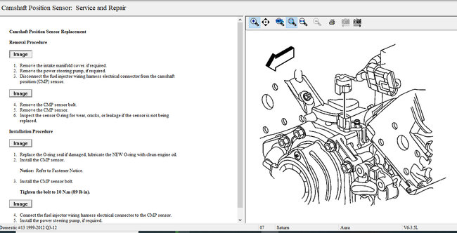

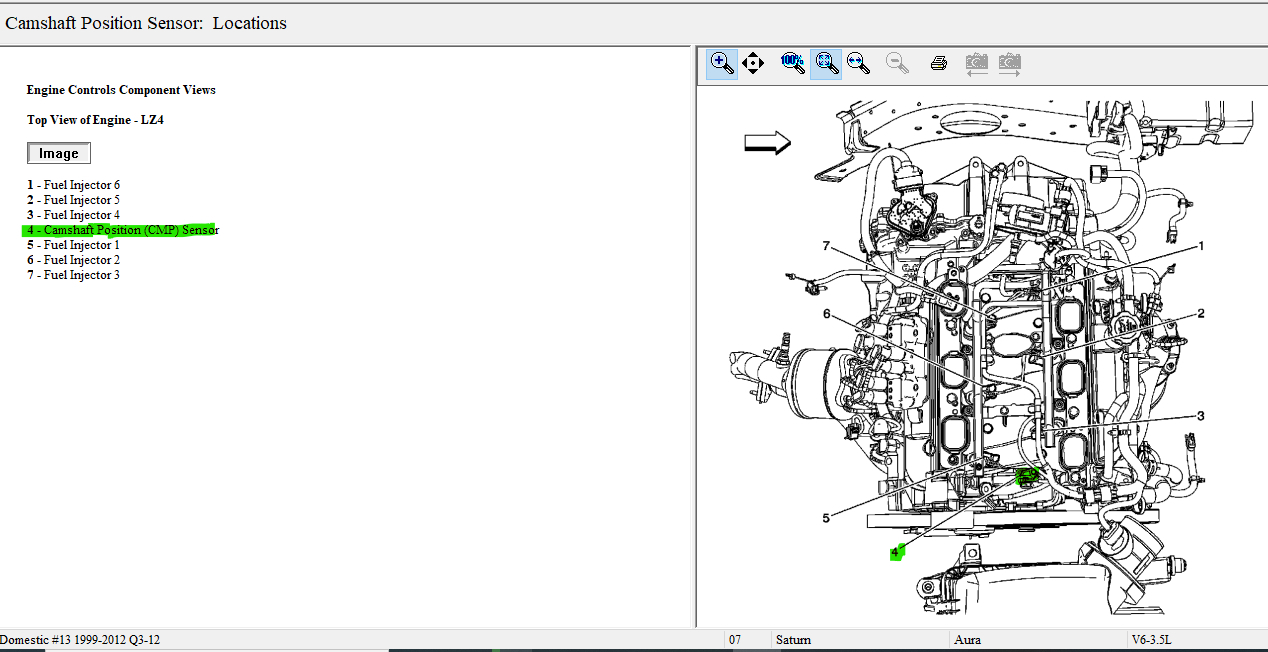

ASHLEY CAIN

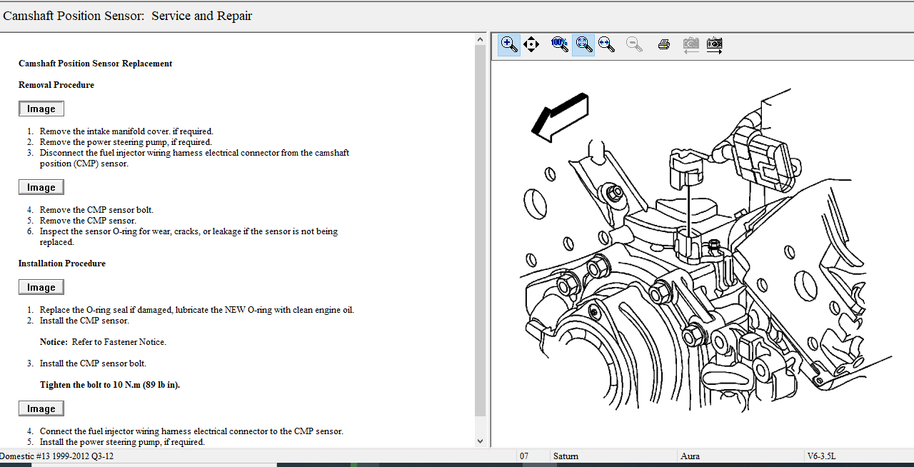

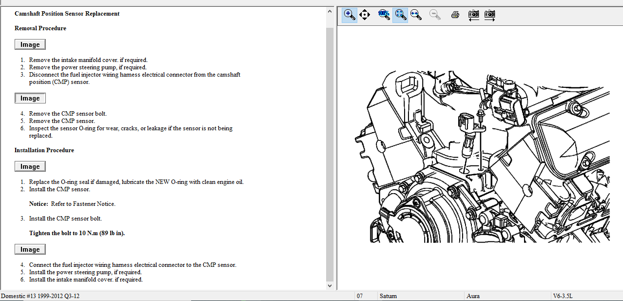

I am trying to replace the sensor but I cannot find the location of the sensor. Someone please help me. I'm sure I'm just overlooking it but it's starting to frustrate me .
Feb 8, 2021 at 9:27 AM (Merged)
SEVAG P
  • 405 POSTS
hello.
check the pictures and the procedure below how to remove and reinstall camshaft sensor for 3.5 L engine.
