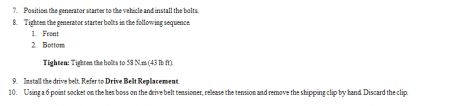

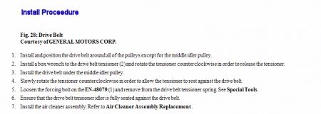

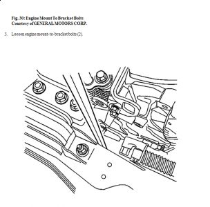

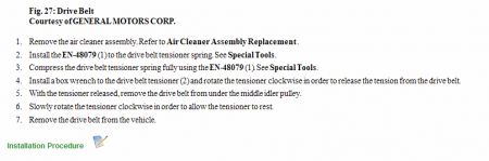

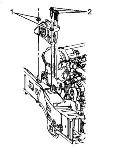

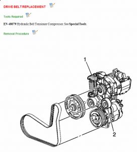

I am trying to tighten the serpentine belt. Can you tell me exactly how to??

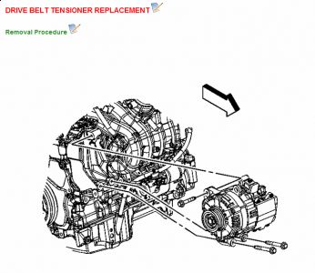

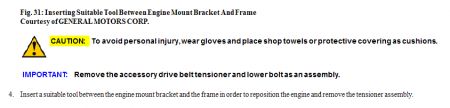

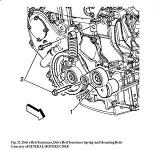

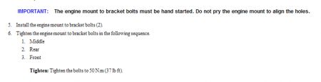

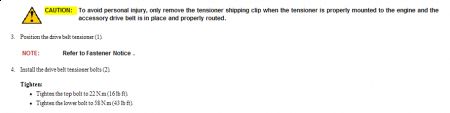

your car has an automatic belt tensioner. If you have a problem with the tension it is more than likely a failed tensioner
Apr 29, 2009 at 7:54 AM
OBXAUTOMEDIC
  • 3,711 POSTS
Hello, Here is the Remove and Install for Belt and Tensioner
