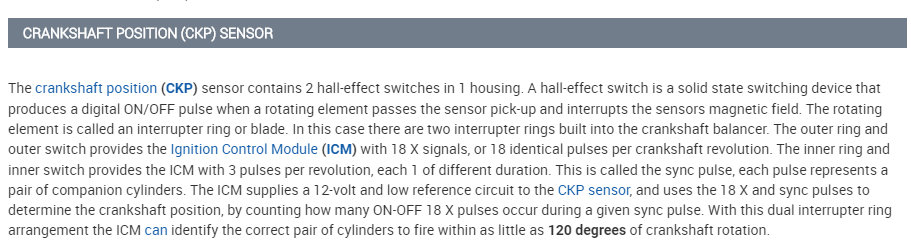

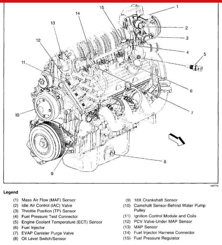

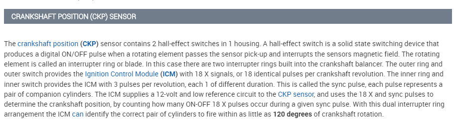

Here is a guide that explains what the symptoms of a crank sensor are:
https://youtu.be/dCjmRL3p4Cs
Unfortunately the service manual that we use does not have step by step instructions but this is pretty straight forward. It is located next to the crank shaft pulley and just unbolts.
In addition there are other sensors that can cause this. Also, it could be a fuel pump.
Let's start with checking for codes and go from there. Hopefully we have a code that will narrow this down for us. Thanks
