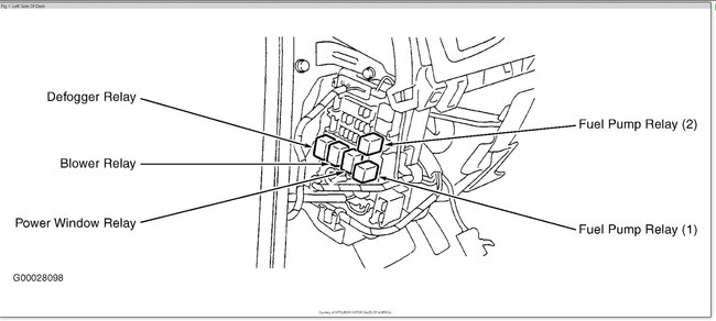

Son drove car from Phoenix Arizona. About eighty miles. Parked car at my house all day. Left the house and got about a block away in car and it shut off. I listened to hear fuel pump and heard nothing. I replaced fuel pump. But I still does not get the two second fuel pump start-up reaction. The fuel pump does pump when cranking engine but engine still does not start. Also, the gas does not come out the return line to the tank. What now?

Sounds like it may be the fuel pump relay not working correctly. Please follow the attached guide on how to test the relay and fuel pump relay wiring diagram to verify this is the issue.
Please run down these guides and diagrams and report back.

I followed the guides and diagrams and it was the relay not working right. $32.00 and it is back on the road.

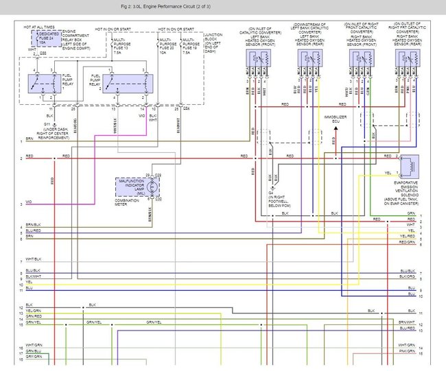

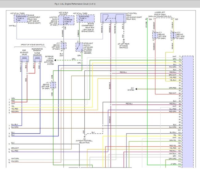

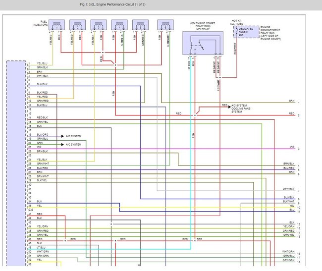

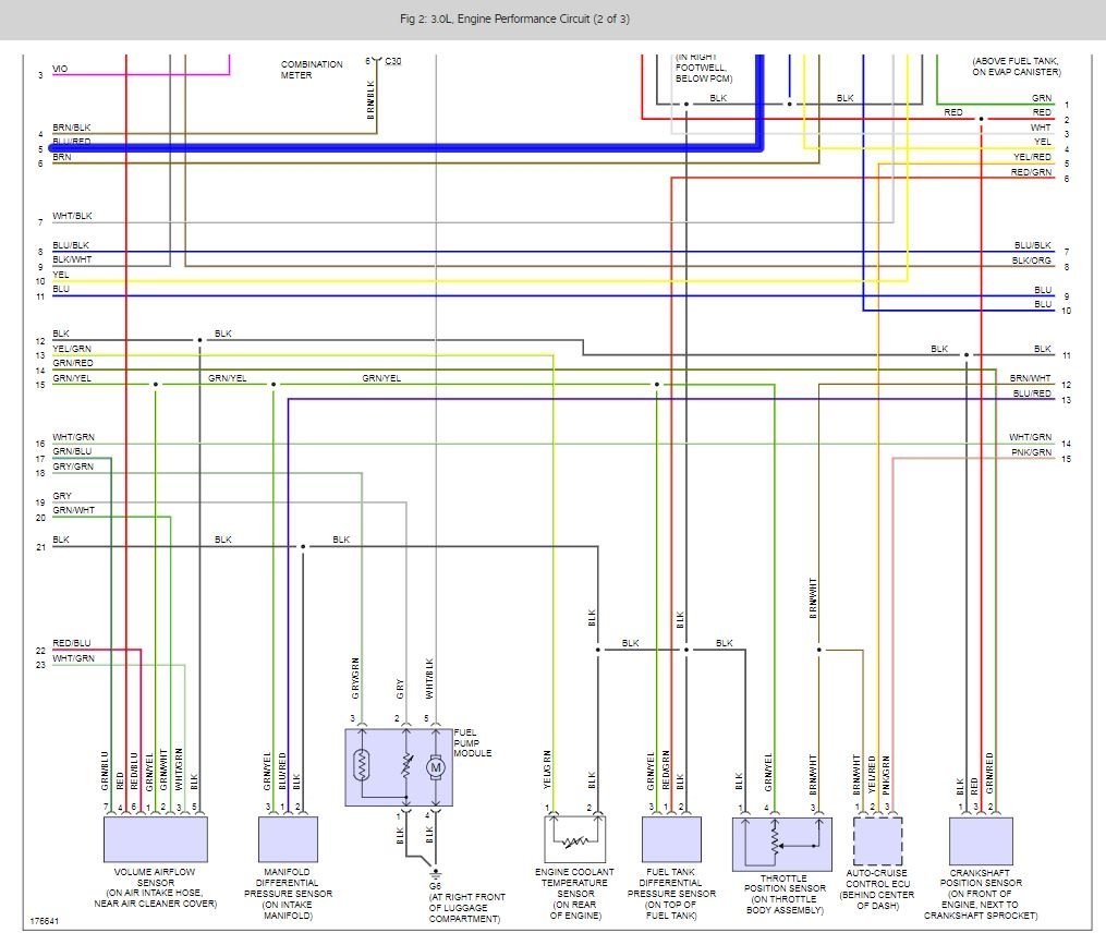

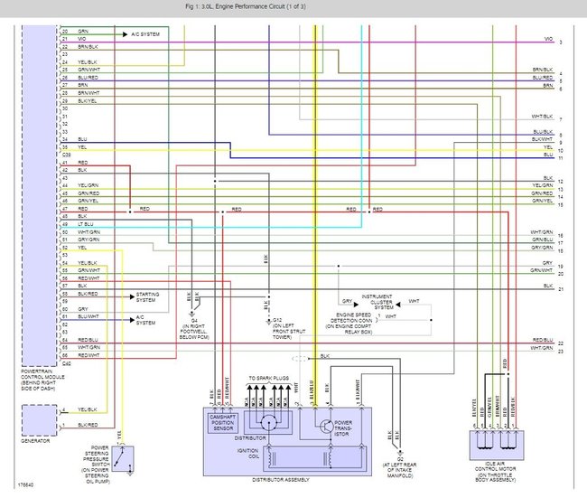

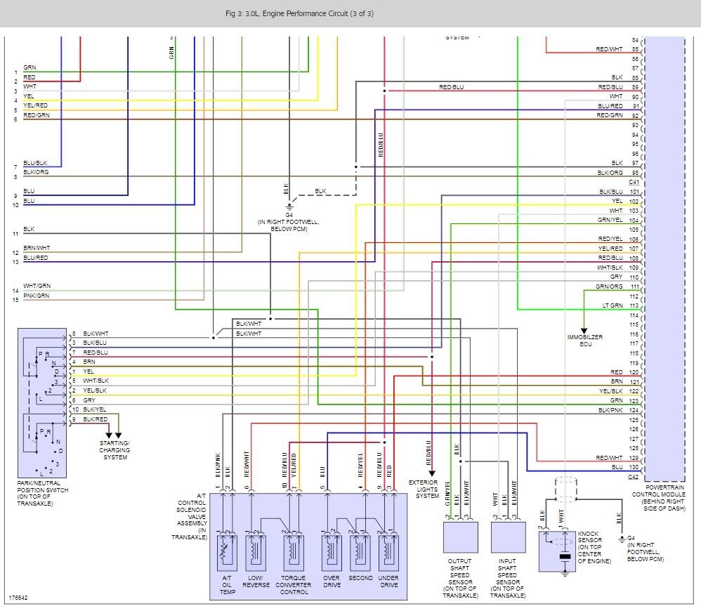

FREEZ
  • 14 POSTS
Hey.. I was wondering if you could probably help out.. I have an 03galant.. Idont know why.. But it wont start.. Has full battery.. I took it in a shop they told me its probably an ecu problem.. But they dont know for sure.. They tried to diagnose the ecu.. But it didnt respond back.. Would you know why?.. Nd he said he looked at it.. Said all the wires nd neutrals were good.. I sent the ecu else where.. Same problem could not fix. The cars been sitting had a fully charged battery tried to start engine tried to roarr but instead died again.. Still wont start.......
Any advice?...
Sep 4, 2018 at 12:05 PM (Merged)
  • 75,988 POSTS
You sure its not an anti-theft issue?
Get a helper disconnect a sparkplug wire or 2 and ground it to the engine atleast 3/16 away from ground-have helper crank engine over-do you have a snapping blue spark? If so-you have a fuel related problem, Do you hear the fuel pump come On when you turn key on? If not check fuel pump fuse and fuel pump relay if okay-check the fuel pressure to rule out the fuel filter/fuel pump/pressure regulator and listen to the injector/s are they pulsing or hook up a noid light. No snapping blue spark continue to troubleshoot the ignition system-power input to the coil/coil packs,coil's resistances,cap and rotor,distributor pick-up coil, ignition control module, cam and crank sensors and computer Note: If it doesn't apply disregard it and keep testing
If both fuel and spark is present-check the valve and ignition timing, this will lead you to problems
with compression and valves opening and closing at the wrong time/broken or jumped timing
belt/chain.
