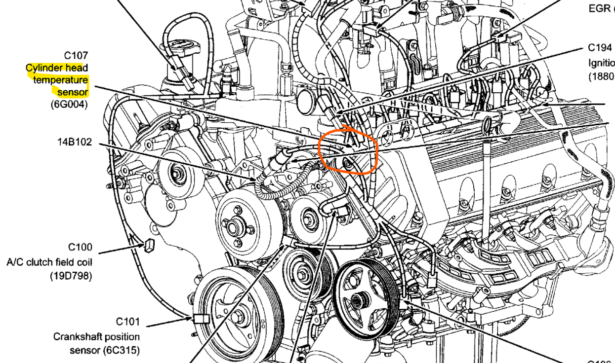

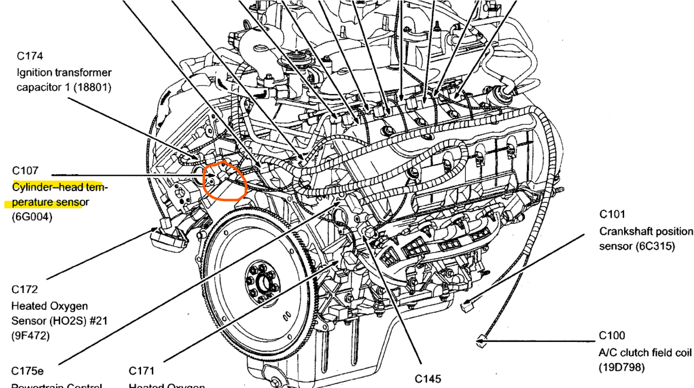

Location of Engine Coolant Temperature Sensor and location of Engine Cylinder Head Temperature Sensor.
Nov 6, 2021 at 12:07 PM
AL514
  • 5,656 POSTS

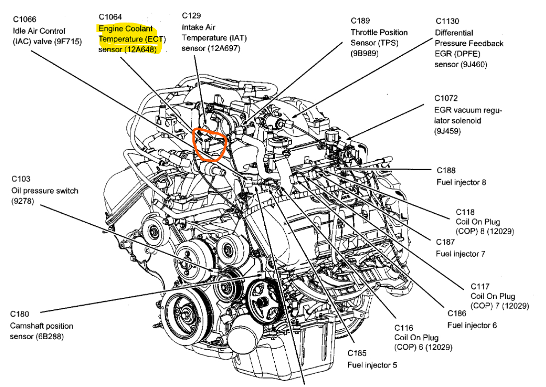

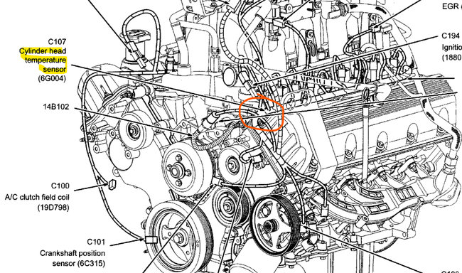

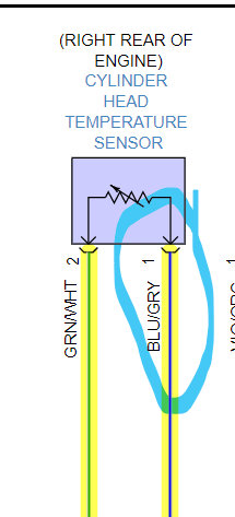

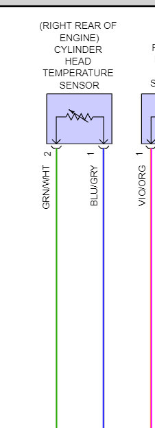

Hello, So Ford has these Coolant Temperature and Cylinder Temperature Sensors listed a bit strange.

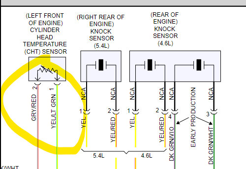

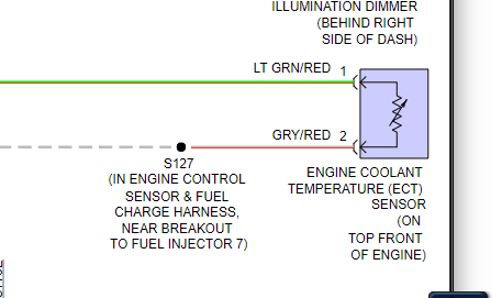

The first two diagrams are for the Coolant Temperature Sensor. You'll be able to find easiest by the wire coloring. It's two wires with light green/red and grey/red wire colors.

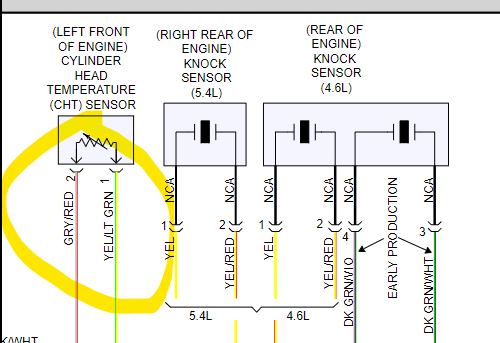

The Cylinder head Temperature sensor you'll also have to go by wire coloring, because it's listed in 2 different places depending on how many valves the engine has, but it's always easiest to find sensors by wire colors. It also two wires, grey/red and yellow/light green. its either on the front of the engine or on the complete opposite side, on the back.

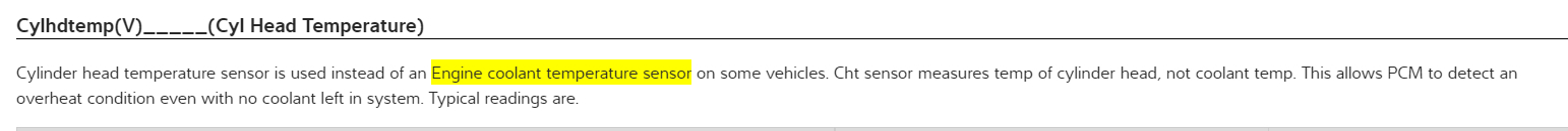

Also, on some vehicles the Cylinder Head Temperature sensor is used instead of a coolant Temperature Sensor. So, it depends on what type of set up your vehicle has.

Well, take a look in those locations for those wire colorings, they're a 2-wire sensor.
It may have both, not every technician knows everything. If you are getting codes for both, the ECM is seeing something. The Ford OEM parts may look different from aftermarket parts from AutoZone. The wiring diagrams are a bit different, and everything is not always straight forward. Make sure your coolant level is full, just never open the radiator when it's hot.

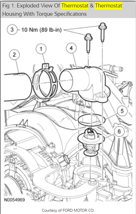

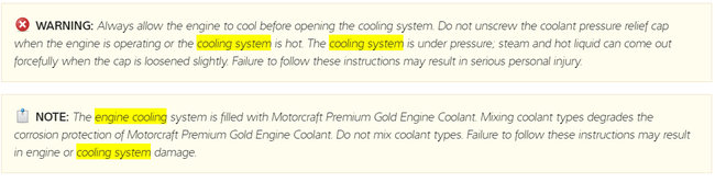

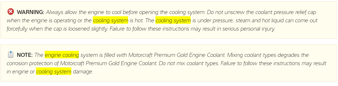

Okay, below I posted a picture of the Thermostat, and it does require Ford coolant, I'm not sure what you have been putting in so far.

It's the 4x4 Limited. And I thought thermostat from beginning but was going by codes. I’ll definitely change that out this week and see if it helps. Thank you so very much for the information.

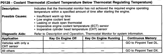

P0128 and P0119.
Nov 14, 2021 at 7:22 AM

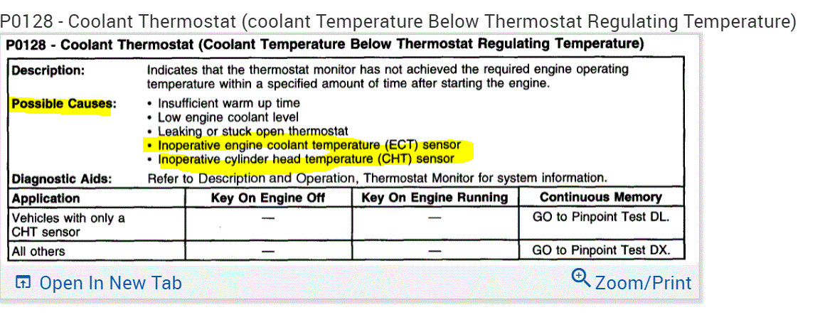

  • 110,241 POSTS
If I hope you guys don't mind if I jump back in with you.

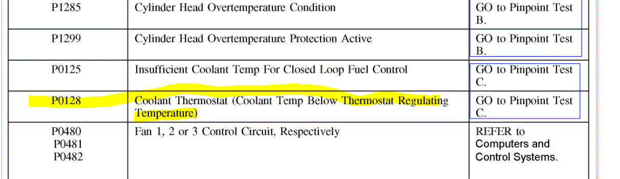

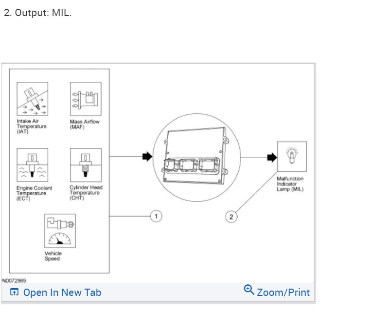

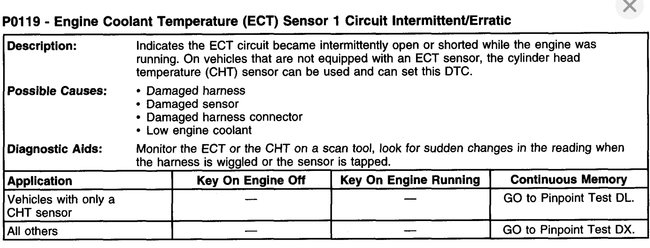

I looked at both of the codes that the vehicle as it is a simple issue. The engine is not reaching operating temperature within a specified amount of time. In other words, it's taking too long to warm up.
In most cases, this is caused by a faulty thermostat or temperature sensor. This is where the confusion comes into play.
Some of these vehicles came with only a cylinder head temperature sensor and others came with both a cylinder head temperature sensor and coolant temperature sensor. The only want to determine which you have is to check for the coolant temperature sensor. If it has one, it will be tucked behind the alternator and mounted in the engine block. However, most only came with a cylinder head temperature sensor, which can set the code P0119. See pic 1 below.
See pic 2 for code P0128. As far as the P0128, here is what I suggest: Using an infrared thermometer for cars, check to see if the engine coolant at the radiator reaches at least 195 degrees F. If it doesn't or takes a long time to do it, replace the thermostat. If it does reach temperature within approximately five minutes, then suspect it is one of the sensors.
Let us know what is found. If it requires the sensor to be replaced, we will then determine which one you have or if you have both.

If does have a CHT sensor, it will either be in the rear of the cylinder head (right bank) or under the intake toward the front left.

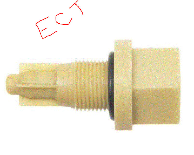

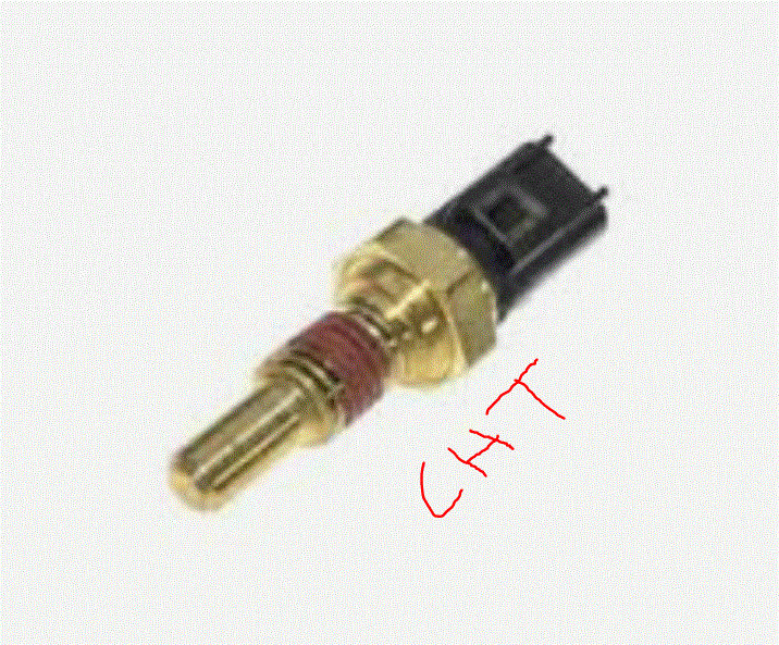

  • 110,241 POSTS
You are very welcome. Listen, we are here to help you any way we can, so please let us know what we can do to help.

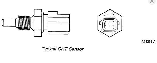

I attached two pics below. The first is the cylinder head temperature sensor and the second is the engine coolant temperature sensor. Maybe the pics will help you identify what was used.

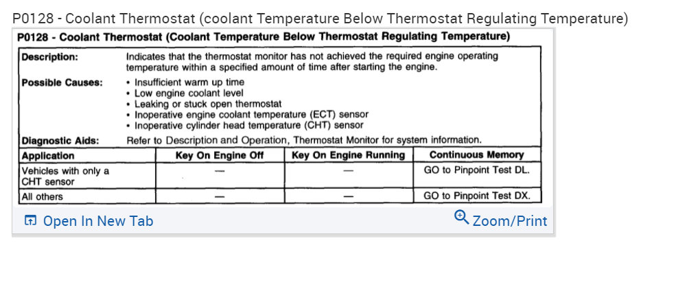

AL514
  • 5,656 POSTS

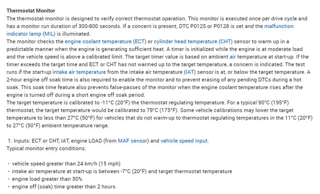

This is the criteria for code setting of P0128. If that 5 volts at the cylinder head temperature sensor is low or missing, Thats a big concern.
Looking on All Data now I do not see a coolant temperature sensor, so i think these codes are setting due to a calibrated range not being met, as you'll see below, there are a few different things the ECM looks at, and if the vehicle doesn't warm up in this time frame, this P0128 will set. So, this may not be a thermostat or Cylinder head Temperature sensor issue. Take a look at the Thermostat Monitor below and you'll get a better idea of what the ECM is expecting to see, and for whatever reason it's not meeting this criteria. So, we have to figure out why it's not warming up in the time allotted, or another sensor may be reading incorrectly.

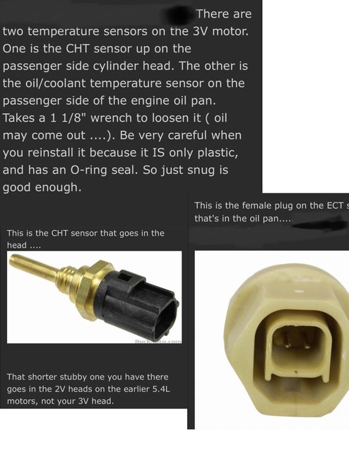

Hi guys, I'm back with a question. It's entirely possible that I put CHT sensor where ECT sensor goes. Could this possibly be the problem?
Nov 17, 2021 at 6:03 AM
AL514
  • 5,656 POSTS
Looking up info right now for you,
This is the Ford part number for the CHT sensor and pic1 9L8Z6G004C
This is the coolant temperature sensor part number 4L3Z12A648AB
They both look similar. I will keep looking for more info

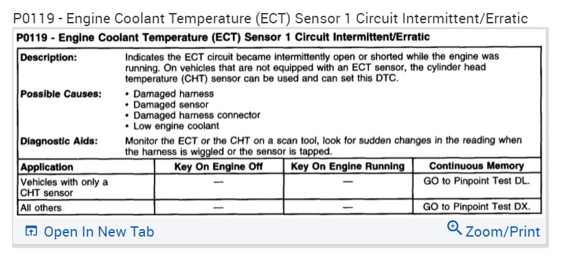

If you look at these codes too, they don't really refer to two different sensors,
The p0119 refers to a circuit problem, and if there's a wiring issue, which means the ECM is getting an incorrect reading, this is leading to the p0128 code. Thats why I was wondering if the CHT had five volts on one wire while unplugged. It doesn't say coolant sensor, its saying that Temp sensor circuit has an issue. I don't think your vehicle has both sensors, i haven't found any diagram that lists both sensors.
I've been looking in numerous places for 3 days now and have not seen one with both sensors. This P0119 says that the circuit intermittently became open or shorted while the vehicle was running. Thats what set this code. So, if there's a contact point where the harness is rubbing threw and touched ground for a second, it will set this code. Engine vibrations cause this type of thing. Checking contact points of the harness is usually how these type errors are found.
I'm reading this can be caused by trapped air in the coolant system as well.
It is also possible that they gave you the wrong part, and you put a ETC sensor in where a CHT sensor goes. Did you go to AutoZone or an aftermarket parts store?

Good evening, do you think the attached info is correct?
Nov 18, 2021 at 7:33 AM
AL514
  • 5,656 POSTS
I have read this too, depending on how many valves the engine has. So it depends on which engine you have. I read there was a 2 or 4 valve engine, and this is talking about the 3 valve engine. So its hard to tell which information is correct. Can you give me the Vin Number of your truck and I can try looking it up by that.

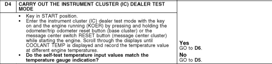

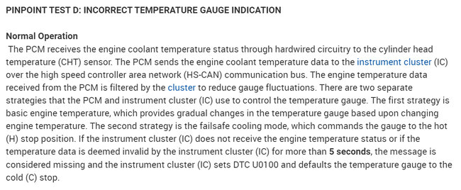

Okay, so I want you to do this test (pic1). The Temp Gauge is not operated by the CHT sensor. The instrument cluster gets its information on the CANbus Network. This means this may be an issue with the Instrument Cluster, a CANbus network that is losing communication temporarily, the reason you may not be getting codes or any other systems, is that at AutoZone or a parts store, they probably can only scan the engine computer. There may be other codes stored in other modules like the Cluster that you're not seeing. Basic cheap scan tools only give you powertrain codes which is why they all start with a "P". The Cluster Module could have "U" codes stored in it which would mean a loss of communication.
Basically, what I'm saying this the Temperature Gauge is controlled by Data on a network, not directly from a sensor. This vehicle needs a full system scan to see if there are any other codes in other modules. A decent shop can do this for you, it won't be free but it may give you a better direction. And not cost $700.00. What if this is an Instrument Cluster failure? Try this first test and see what it tells you. You don't need a Scan tool to do it.

so under a steady cruise, The thing is I don't think your engine is going cold and heating up, I think there's an issue with a wire shorting out somewhere because it doesn't seem that anything has changed since you replaced that sensor and the thermostat.
