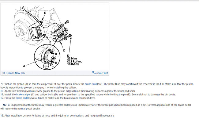

Recently I replaced rear rotors and pads on my vehicle. Almost immediately, the brakes started to seize. After a while they would cool down and decompress, but can't go any farther than a couple of miles before it does the same thing. It's not the calipers or slide pins and I've bled the lines. Also, put in a brand new master cylinder.

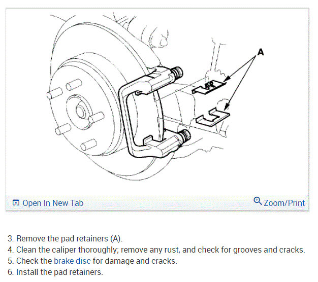

Is there any drag from the brakes when the pedal is released? What I have seen happen is this. Brake fluid will expand when it gets hot. As a result, it can apply more and more pressure on the brakes causing them to lock. When you replaced the pads, did you remove all dirt or rust from the caliper mount where the pads sit? They could be frozen in the mount and causing this. Even if the slide pins are loose, the pad can be frozen in place.

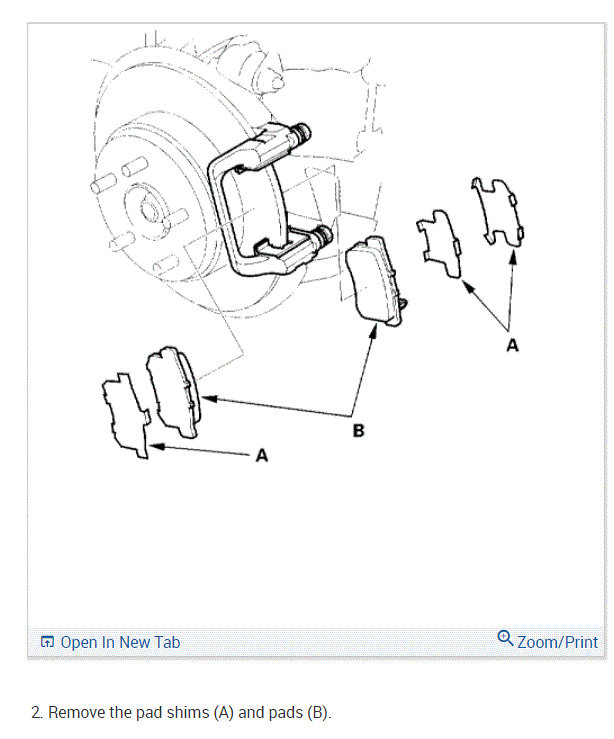

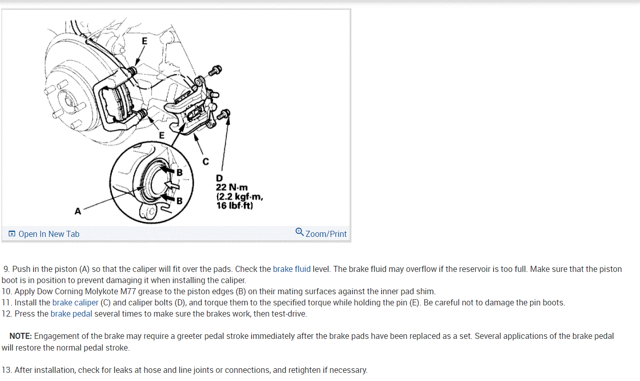

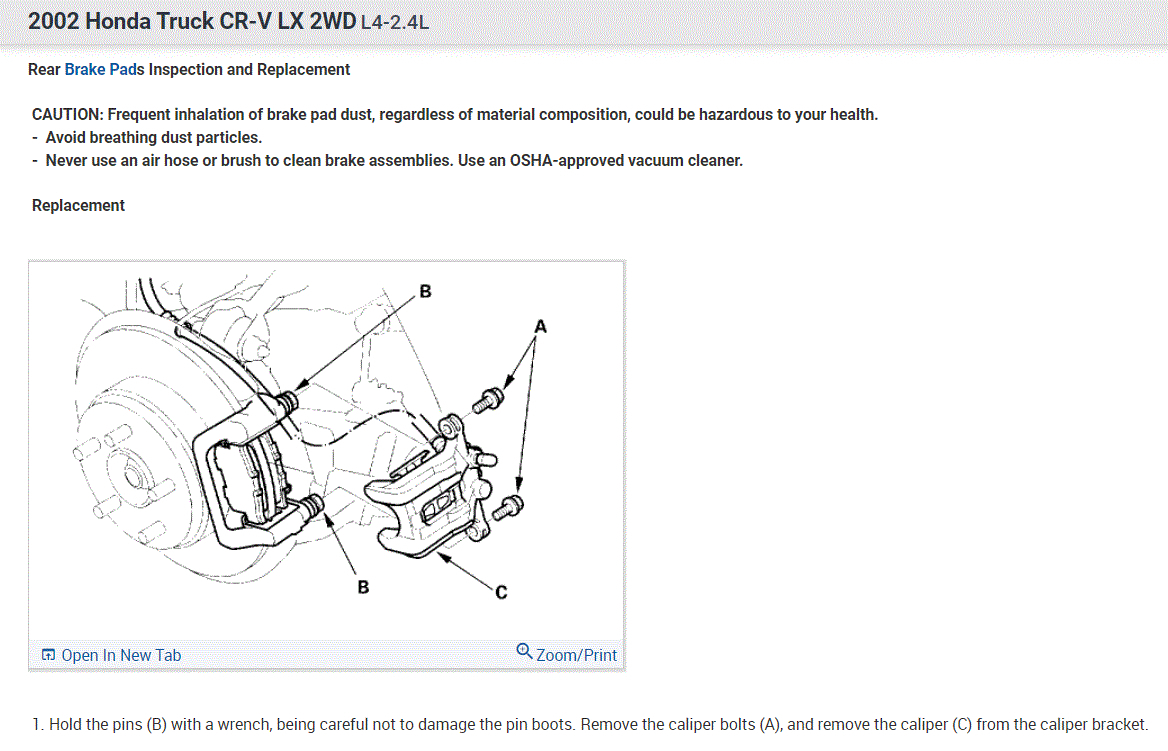

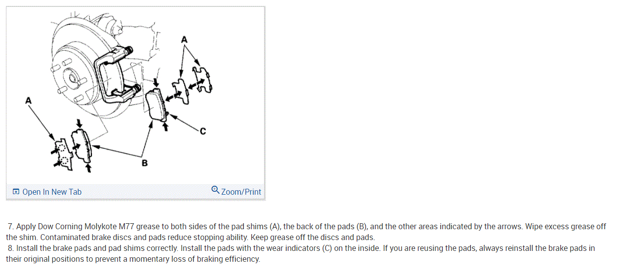

If you look at the attachments below, they include the directions for removal and replacement and inspection of the rear brakes. These are specific to your vehicle. Take a look through them and see if anything helps.
Something is allowing the pads to hang up. Make sure everything is moving freely including the pads.
