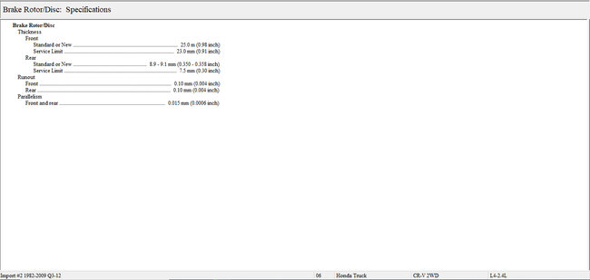

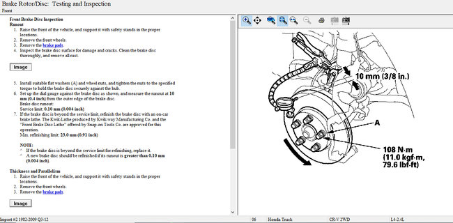

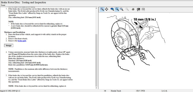

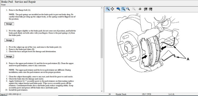

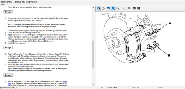

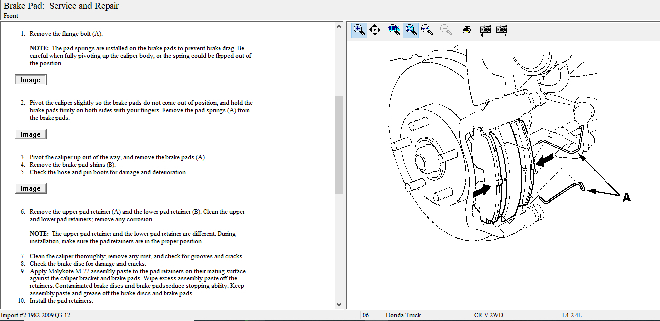

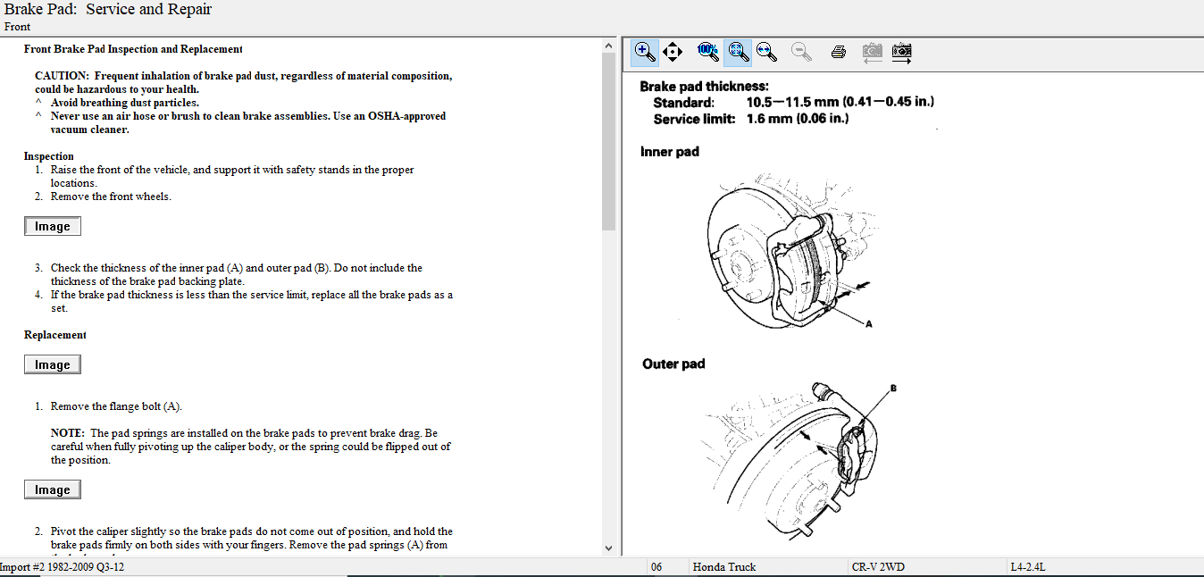

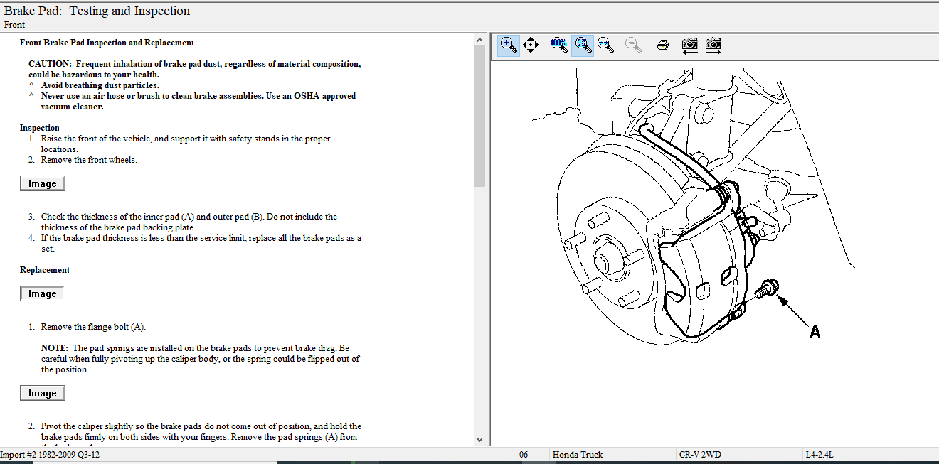

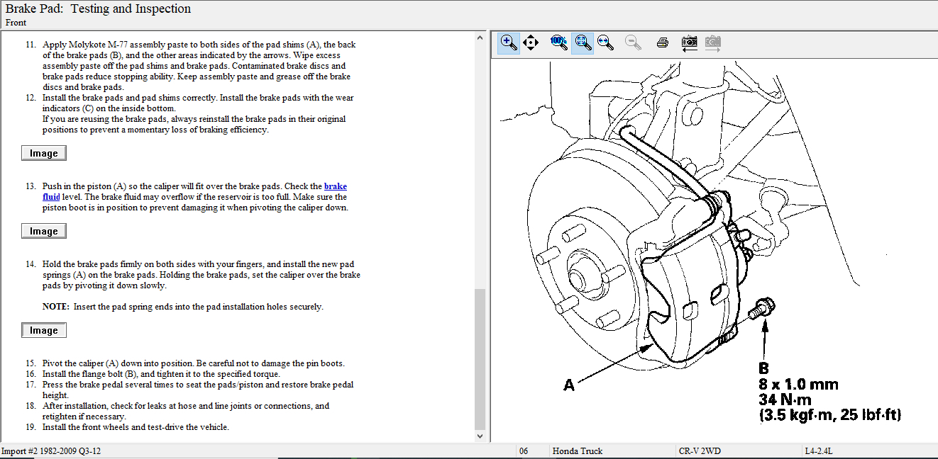

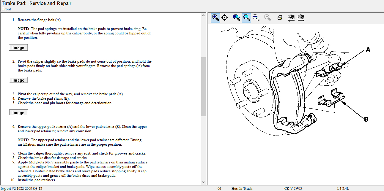

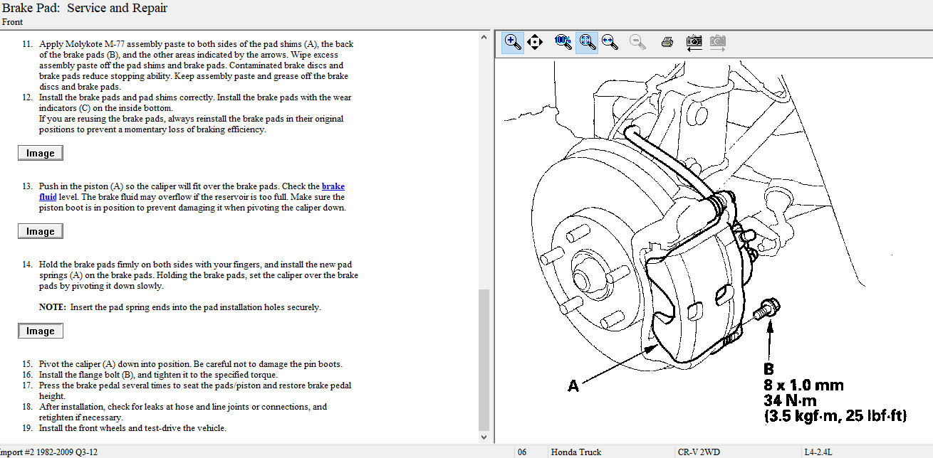

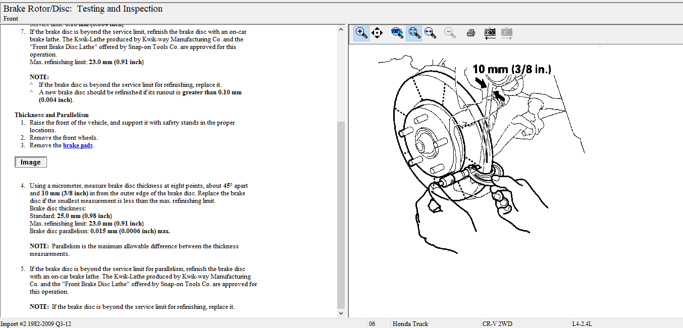

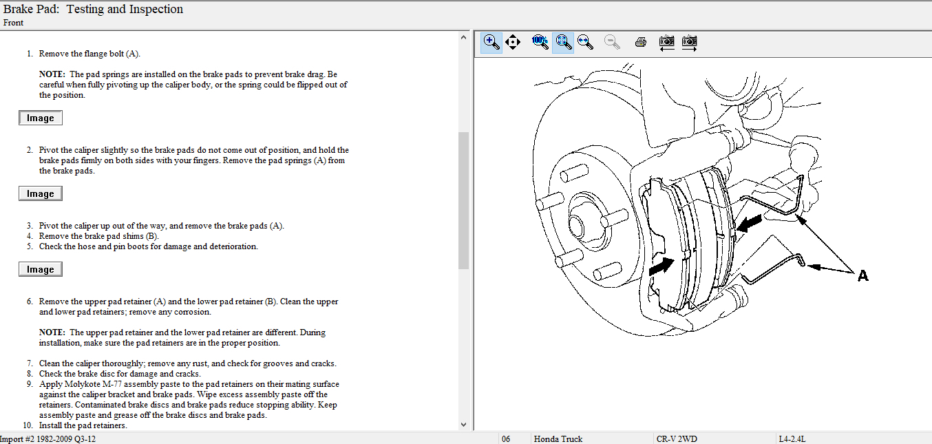

How do you replace the brakes?
Aug 15, 2009 at 3:55 PM
SEVAG P
  • CAR REPAIR CONTRIBUTOR
  • 405 POSTS

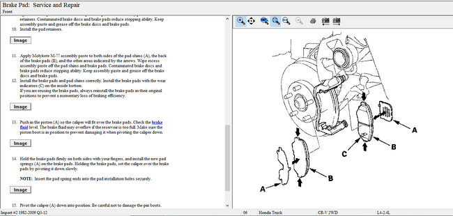

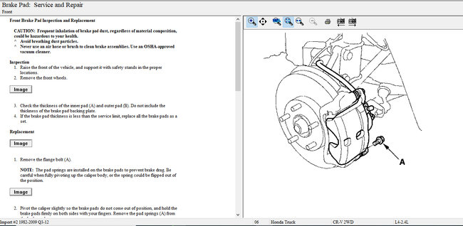

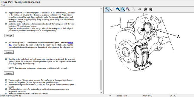

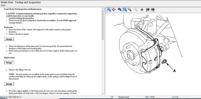

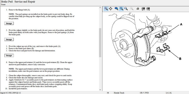

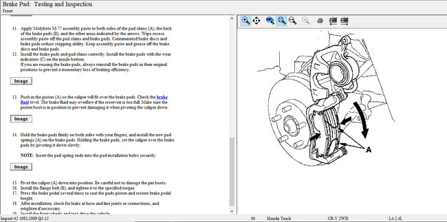

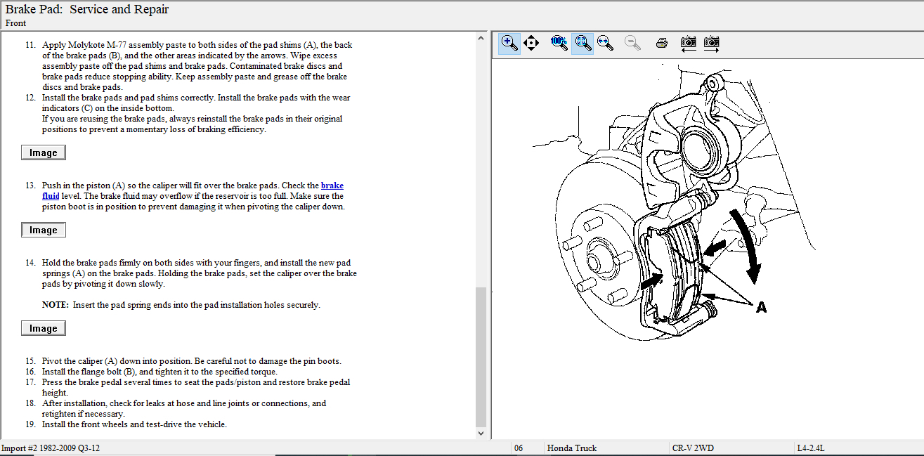

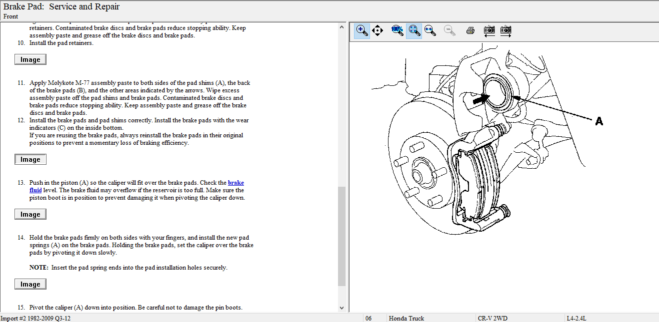

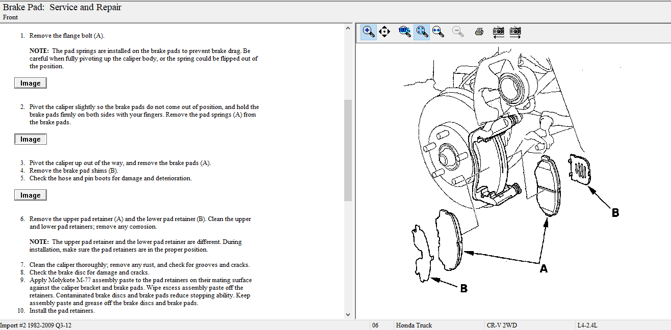

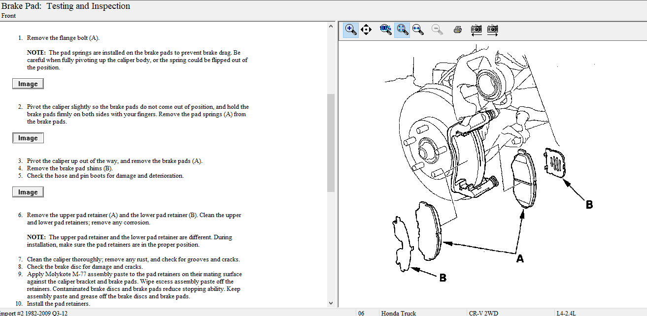

hello,
check the instructions below you can replace it by yourself.
check our guide below how to replace front pads and discs.
check our video for pads and rotors replacement its for CRV later model but can help they have the same concept.
https://youtu.be/XTuDGxH62F8
check diagrams below how to replace and inspect front pads and rotors.
hope these helps.
thank you.
