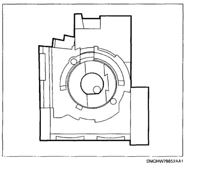

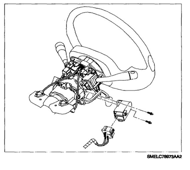

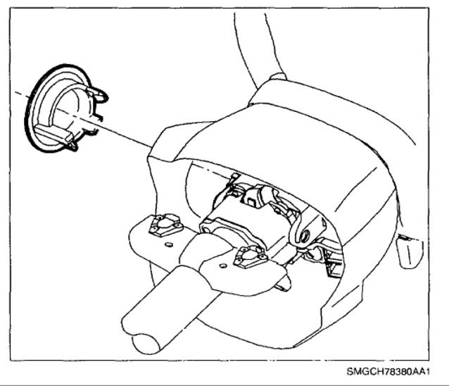

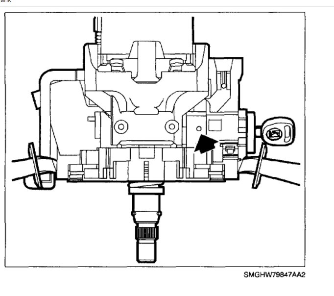

I am helping Saturn owner who gave his car to a bad friend. It was explained that they ripped off ignition tumbler (key-part, mechanical that is). What i saw was the tumbler was totally blown, someone drilled out as much as they could, but still did not know how to take out the lock cylinder. The drilled/totally damaged part of cylinder appears to be away from the electric sensor at the right bottom of the bracket/lock especially if you turn lock clockwise. They were able to turn the lock tumbler but engine won't stay running, shuts off the very second it starts. As many times as one wants. I found the three wires, black, yellow, white cut, instead of taking out the connector from the security sensor/switch. As if they tried to connect in different test ways the wires by hand while crank/started. I took out the tumbler and bought a new generic part. I am puzzled about putting in the new cylinder. (and it still have to be "programmed" by locksmith) since on the part of old, the broken one that faces security there is no damage. What if the new one will do the same? In the lock housing the opening is too narrow to see if there was any end lever with switch or is it electromagnetic? Hard to tell looking, if something wrong at the end of tunnel where security switch actuated.

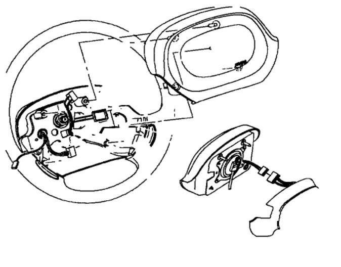

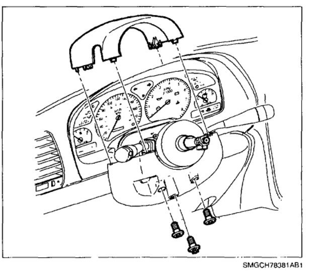

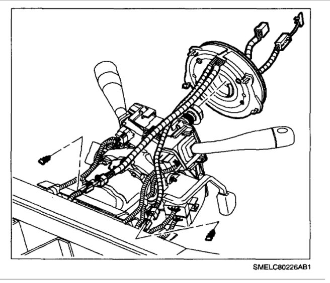

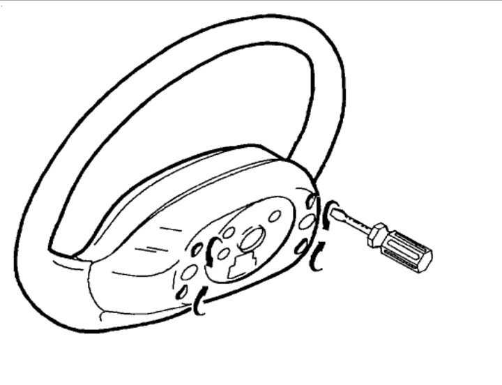

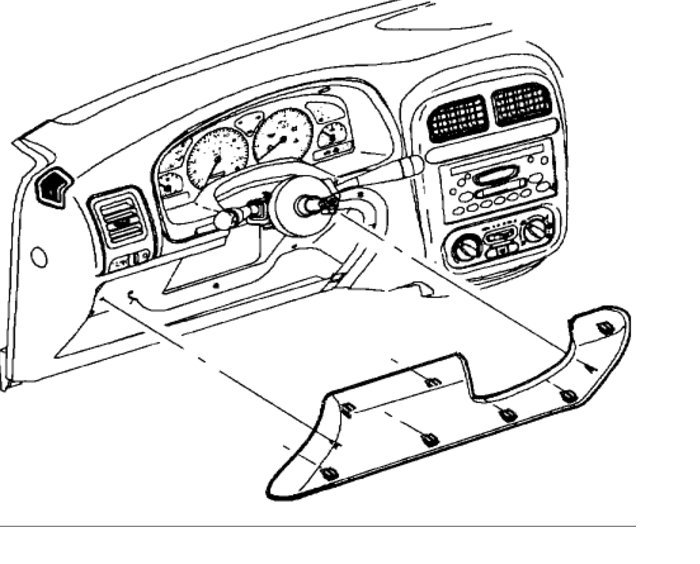

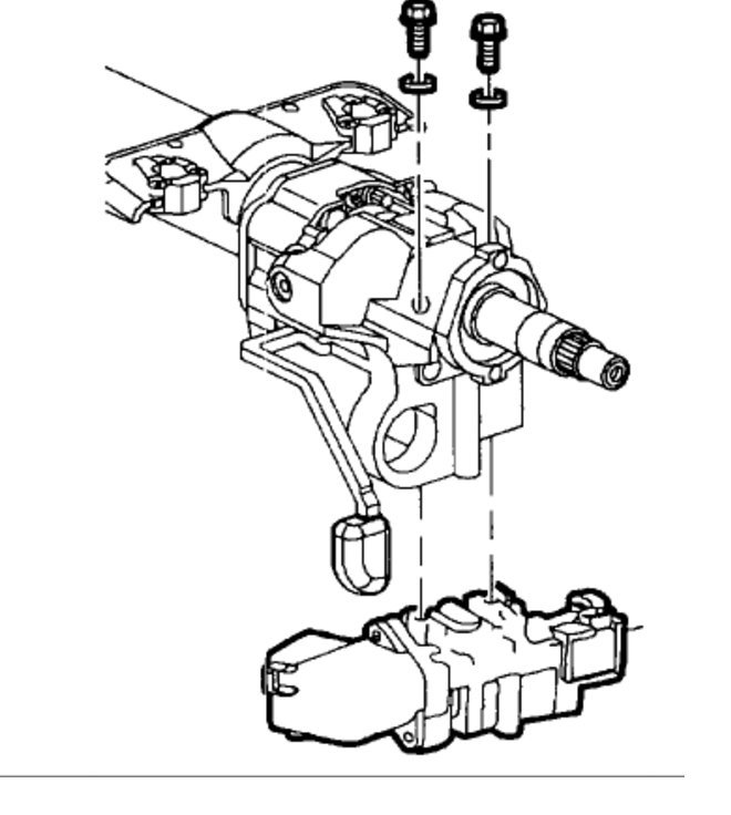

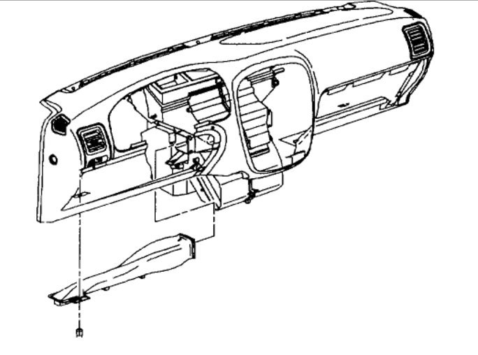

Is the security light flashing? If so the system is enabled. If you are using a new key it must be programmed to the car which the dealer can do if you bring the VIN and proof of ownership. Here are diagrams and instructions on how to replace the ignition tumbler below. Check out the diagrams (below). Please let us know what you find. We are interested to see what it is.

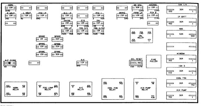

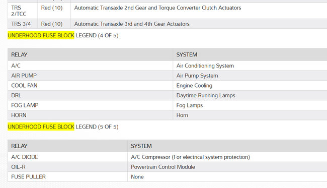

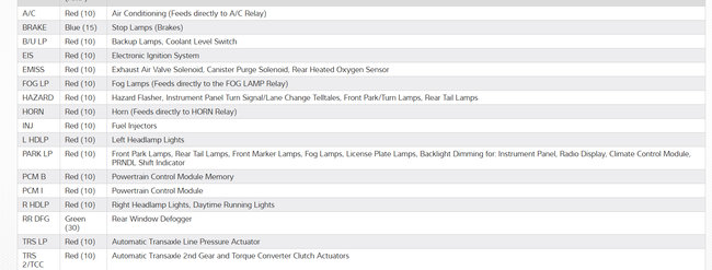

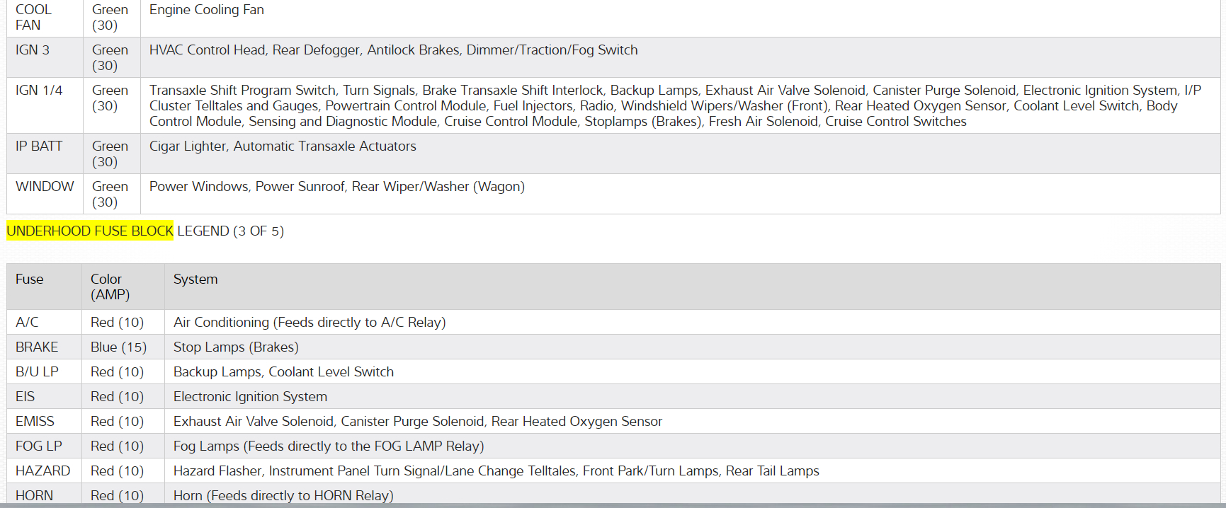

Forgot to mention. I put a working SnapOn (older) scanner on OBDII jack and screen don't light, no communication. No visible wires broken there or strange... tried to see what can I do about replacing computers.
May 11, 2019 at 2:48 PM

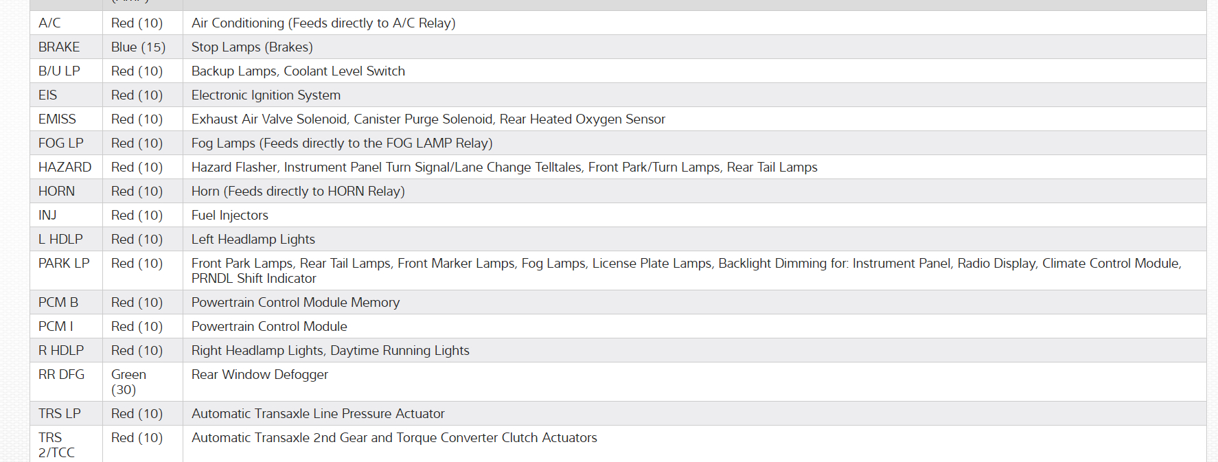

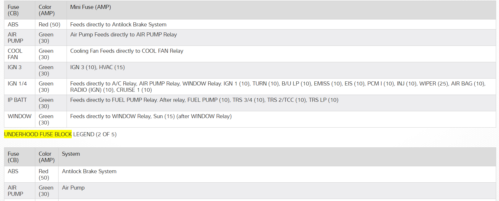

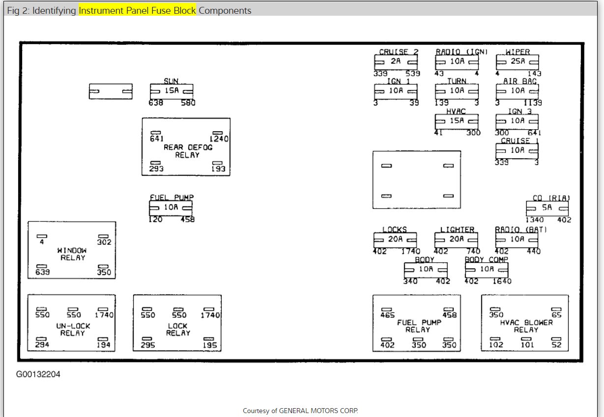

  • 55,399 POSTS

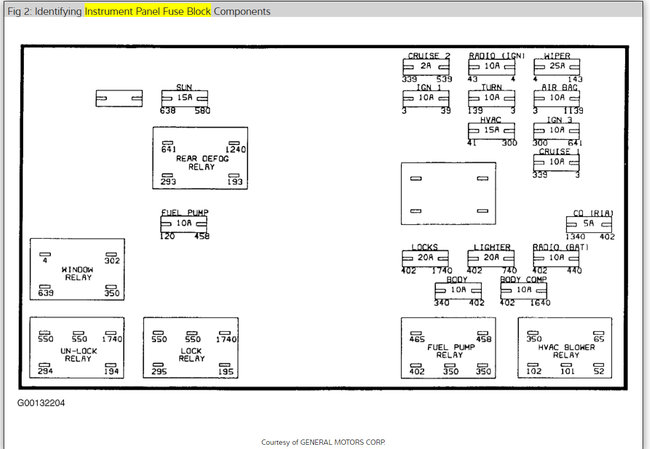

The no communication is what bothers me, lets check the body fuse under the hood for power. Here is the fuse location and a guide to help you check with the wiring diagrams for the ALDL connector so you can see how it works
