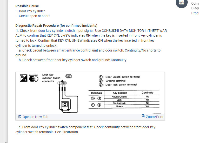

car ran then engine head lights fade engine pops back and shut off. Security system?

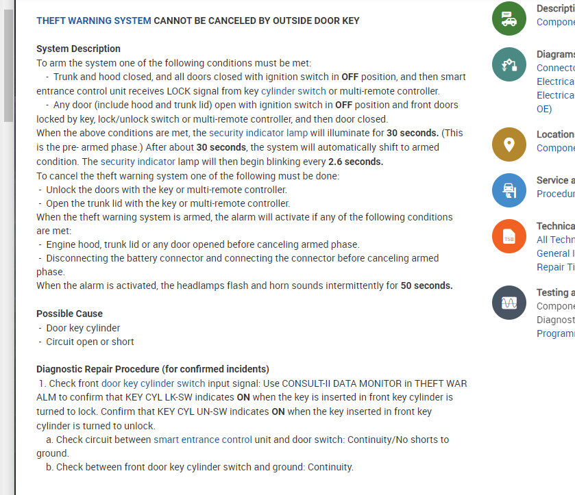

Is there a reason that you are thinking this is a security issue? Is the light staying on or flashing?
I would suggest we start with checking for codes and see what is there.
Also, if this is a security issue then this guide will help with the basics to find out if we can just shut it off:
https://www.2carpros.com/articles/how-to-reset-a-security-system

Thanks for the prompt response. i did change the alternator and battery the security lights comes on and then starts flashing engine turns over but doesn't start.

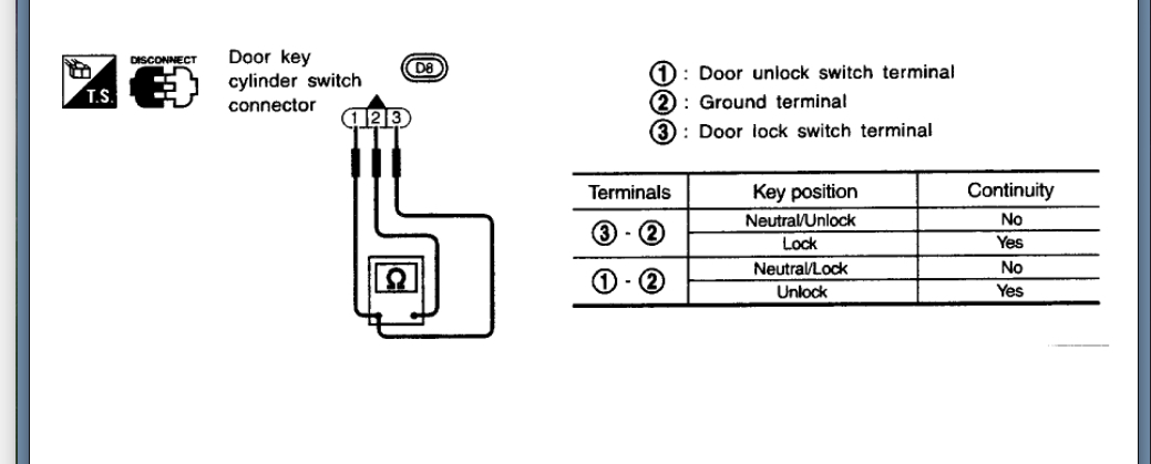

Okay. if the theft system is on or flashing then that is preventing the start.
I assume you are using the remote to unlock it and it does not work? What about unlocking the door with the key? If that doesn't work then we may just have an issue with the door circuit so here is testing. However, I would start with checking for codes because if there is an issue with the system it should have a code.
Let us know what you find with this and we can go from there. Thanks
