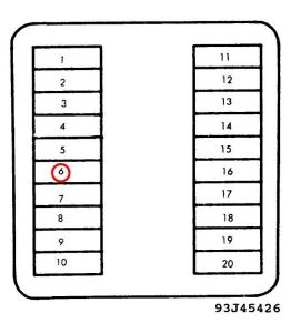

https://www.2carpros.com/forum/automotive_pictures/55316_86maximafuse_2.jpg
Try checking fuse #6 (circled)
Fuse & Circuit Breaker Identification

6 - 15 Amp - Right Headlight, Theft Warning System (1987-198)

The passenger side low beam is not working, high beam works fine.
I replaced the light bulb, fuse, socket.

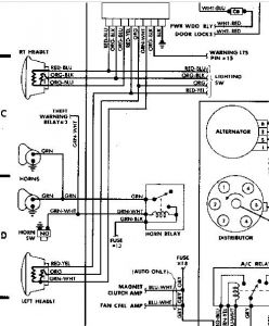

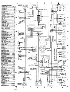

https://www.2carpros.com/forum/automotive_pictures/55316_86maximawiring_1.jpg
https://www.2carpros.com/forum/automotive_pictures/55316_86maximawiring_2.jpg
Remove the new headlight socket. Use a volt meter, with the headlight switched on, probe orange/black (+) and orange/blue (-). If you have no power, the problem may be in the headlight switch or the headlight sensor.

I replaced the switch at the steering column and the
headlight works fine. Thank you.
