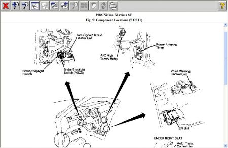

My 1986 Maxima signal lights and hazzard lights do not blink. They will light up but not blink.
Please tell me where to locate the blinking module? A diagram will be appreciated.

They you go-its under the dash on the steering column post-see below and have a nice day
