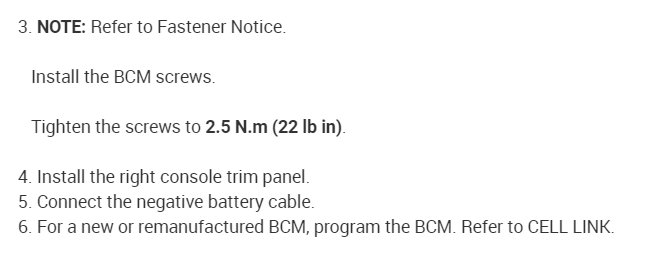

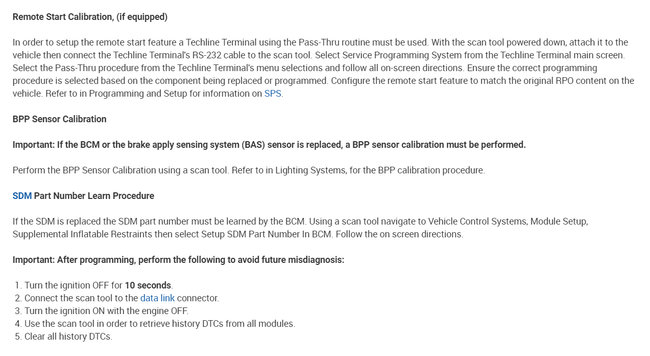

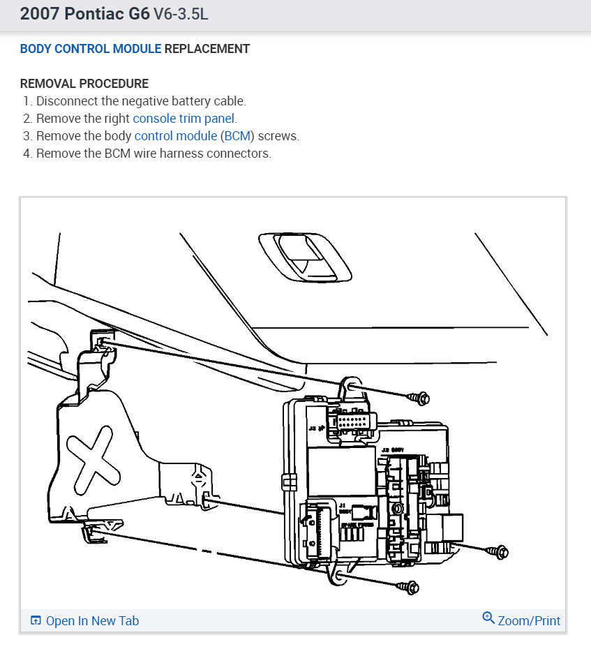

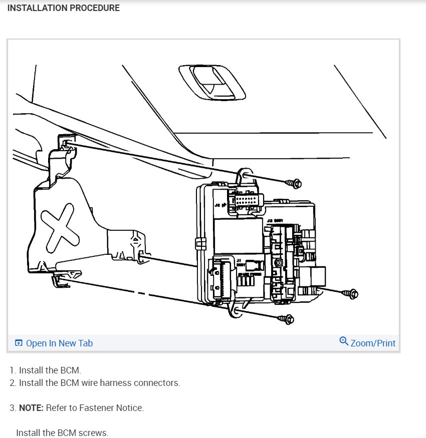

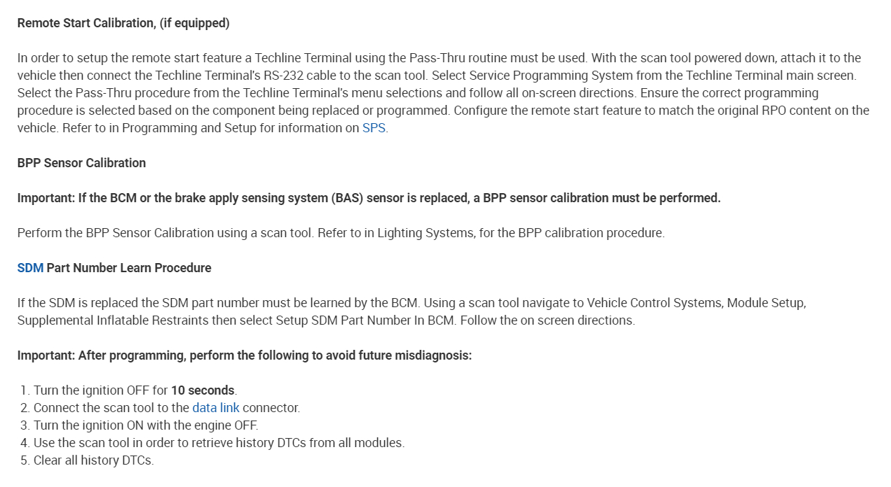

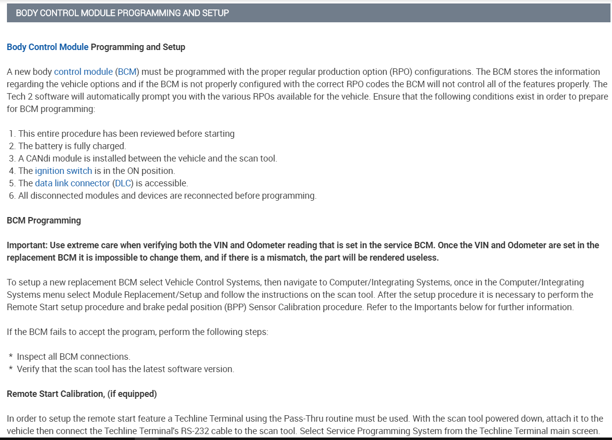

It sounds like the BCM is going out which controls the security and communicates with the BCM through the CAN. To confirm lets do a can scan by following this video. Also I have included how to replace the BCM in the diagrams below.
https://youtu.be/InIlnsjOVFA
