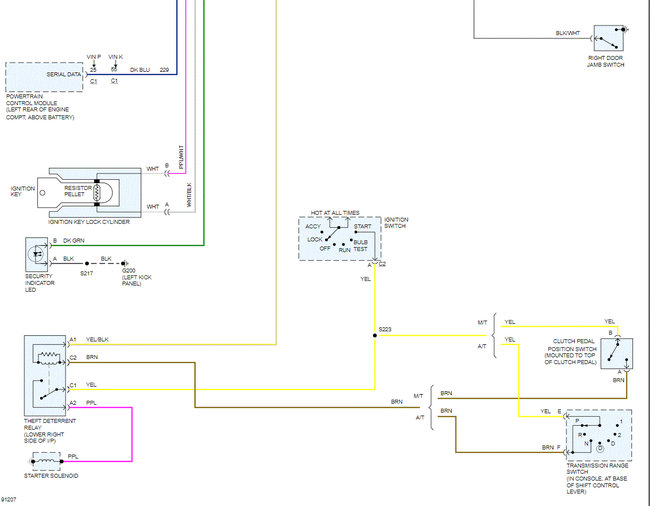

My car listed above base model the security light started coming on when i tried to start it. My research has showed me all different things. I just need to know what to replace and what to do because it's our only car and we have 6 kiddos.

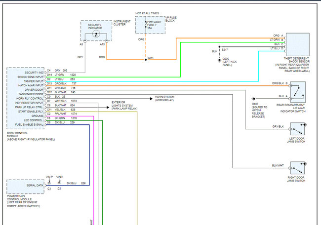

I attached the wiring schematic below for the anti-theft system. I thought you may want to see it as a reference. I had to cut it in half to make it readable, but I did overlap them so you can follow from one to the next.
There is a resistor in the key that may have gone bad or the system may require reprogramming. That will basically require the use of a scan tool and new keys to program.
