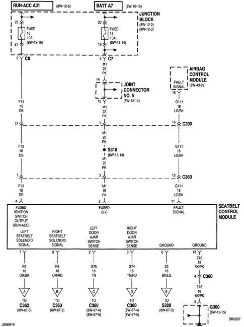

Both seat belts will not release. I checked the wiring to the seat belt control module and found no current (*or voltage) across the pink and green/black. I did not get anything across the fuse sets either. I am thinking that I might not be getting power to the fuse. Is there a relay that sends this? Thanks. John
Nov 4, 2017 at 8:09 AM
STEVE W.
  • 15,295 POSTS
You should have twelve volts on the pink wire all the time and twelve volts on the dark blue wire with the ignition on. The green/black is the signal wire from the airbag module and should not be probed as you could trigger the belt tension-ers.
Fuses twelve and sixteen power it.
Fuse sixteen comes from the ignition switch and is powered through the same circuit that powers the radio and wipers.
Fuse twelve is fed from the battery through Fuse one (50 amp) in the PDC.
If you have no power at either fuse and the radio works and the radio retains memory and clock, the issue is inside the PDC.

Hi, Steve. I found I was using a poor ground, so I went to the battery like you said. Fuses 12 and 16 in the fuse block are good, after all. Fuse 1 in the PDC appears fine. Wipers and radio work. But, still no power to the pink wire at the seat belt control module using this battery ground. I do not see any obvious breaks in the wiring from under the seat and under the carpet floor cover, but kind of hard to follow it up into the fuse block. Any final thoughts on this? Thanks again for all your help. John
Nov 7, 2017 at 7:24 AM
STEVE W.
  • 15,295 POSTS
Check to see if you have power at pin 16 in the OBDII connector, it is powered on the same circuit. It should have 12 volts with the key on. If it does but the seat belt module still doesn't you have a break in the wiring from the junction 5 connection to the module. You could just run a new pink wire to bypass the current one.
