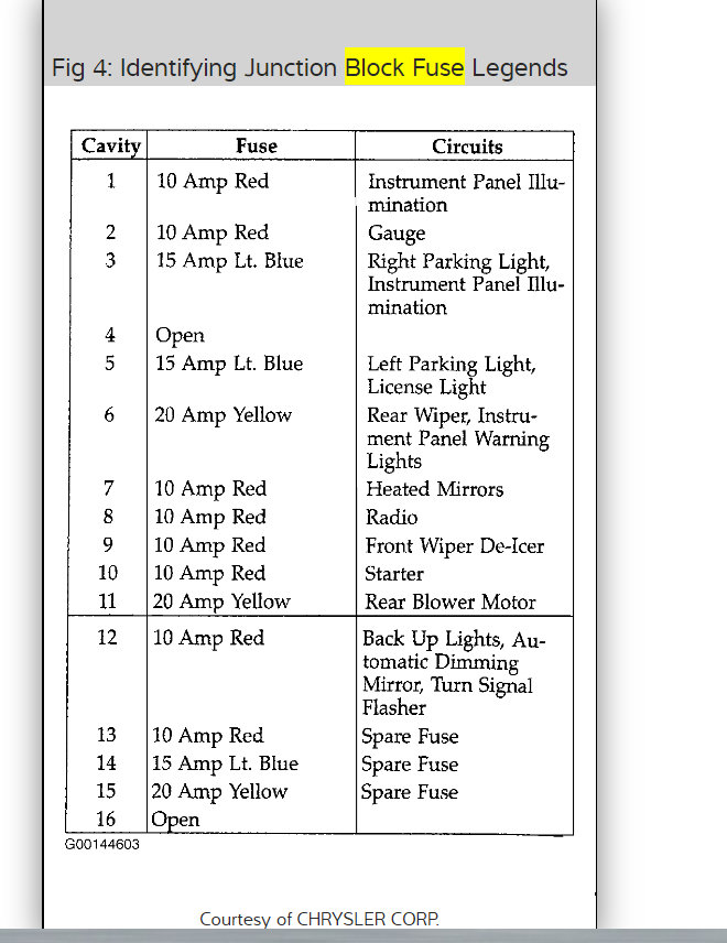

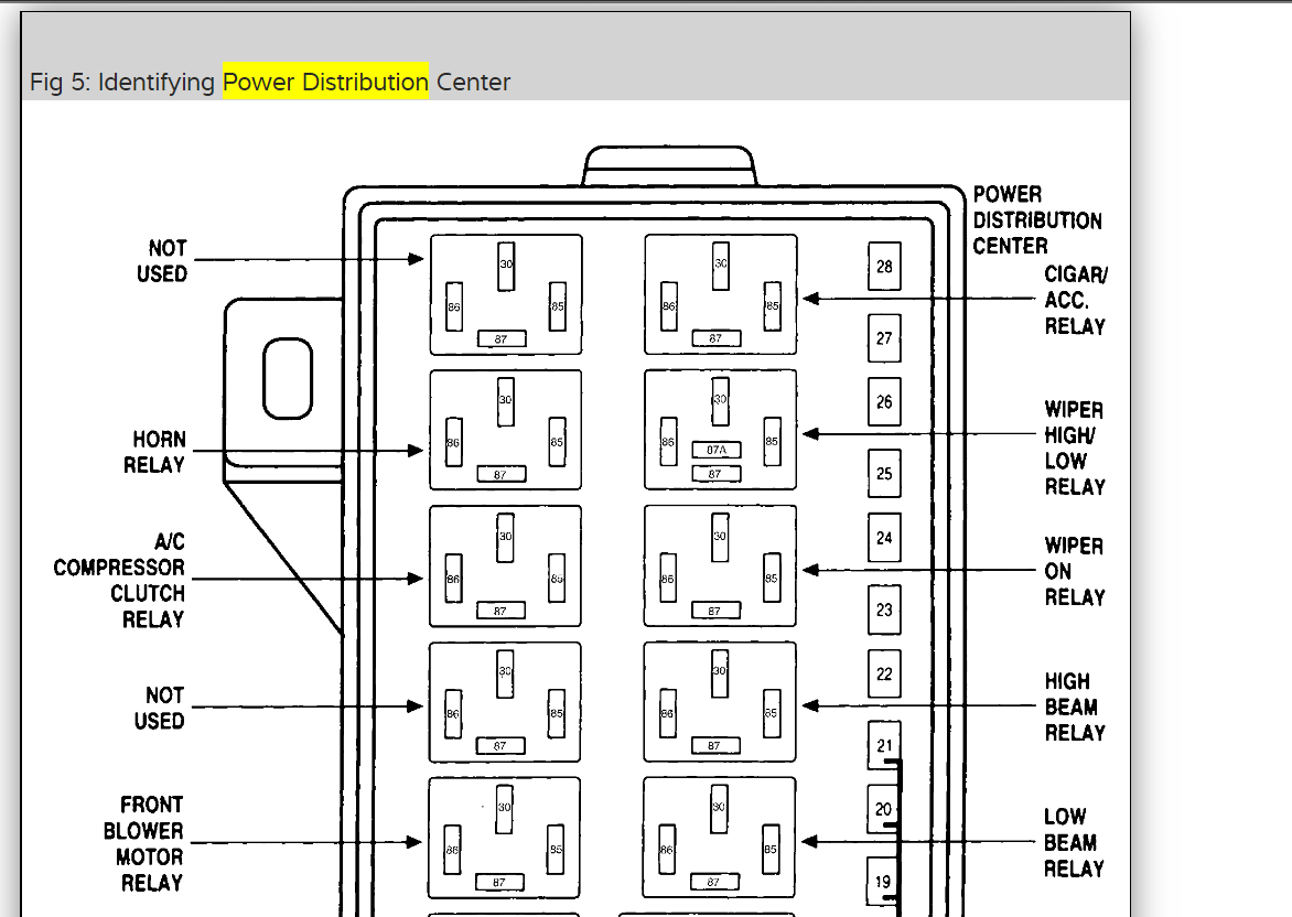

Schematic of junction control box
1998 CHRYSLER TOWN AND COUNTRY
153,000 MILES • 3.8L • 6 CYL • 2WD • AUTOMATIC
SAM BROWN

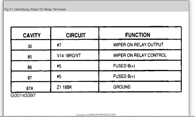

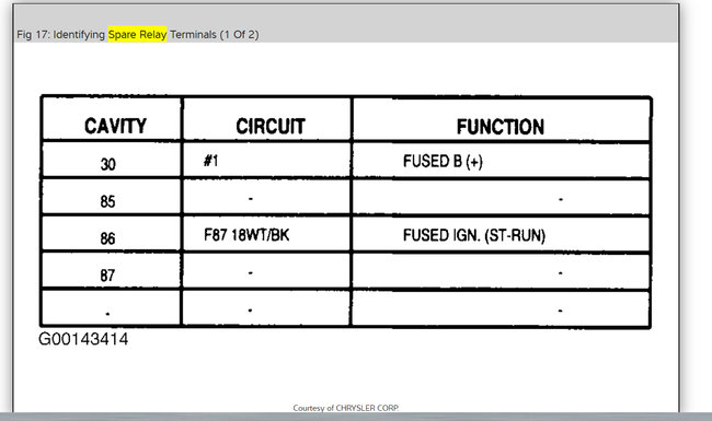

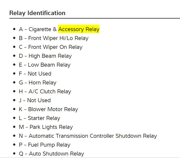

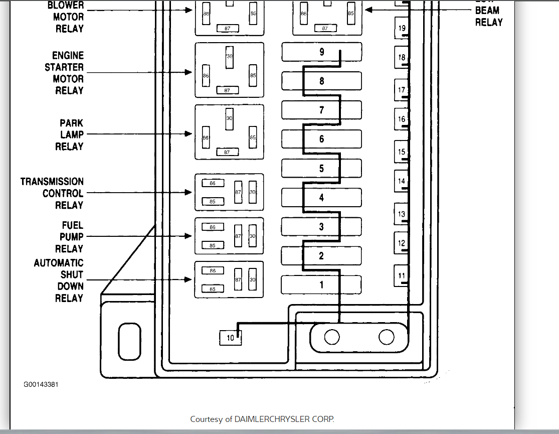

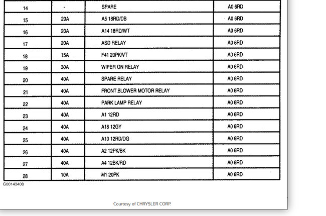

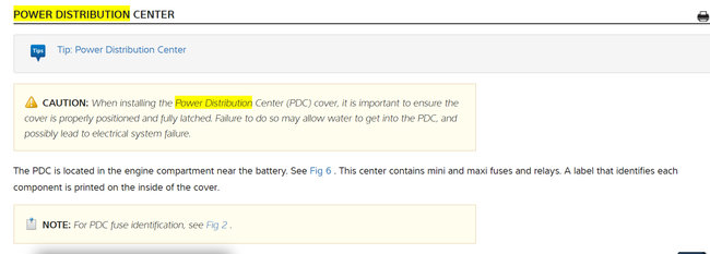

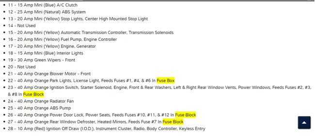

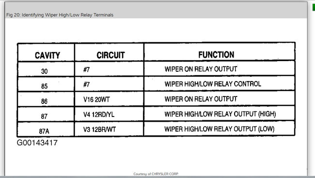

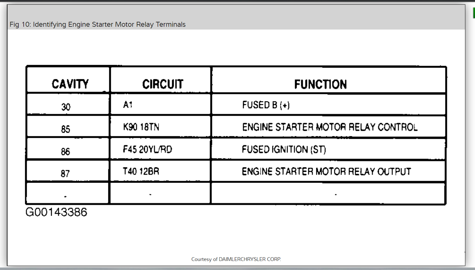

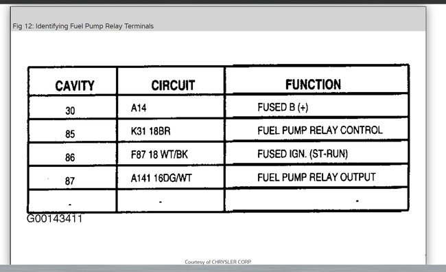

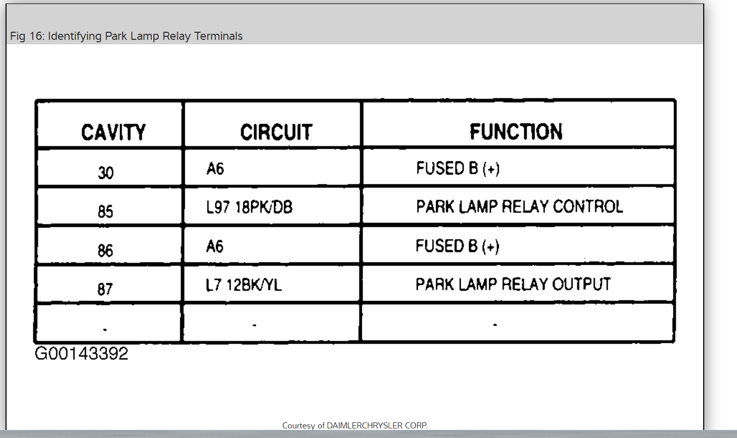

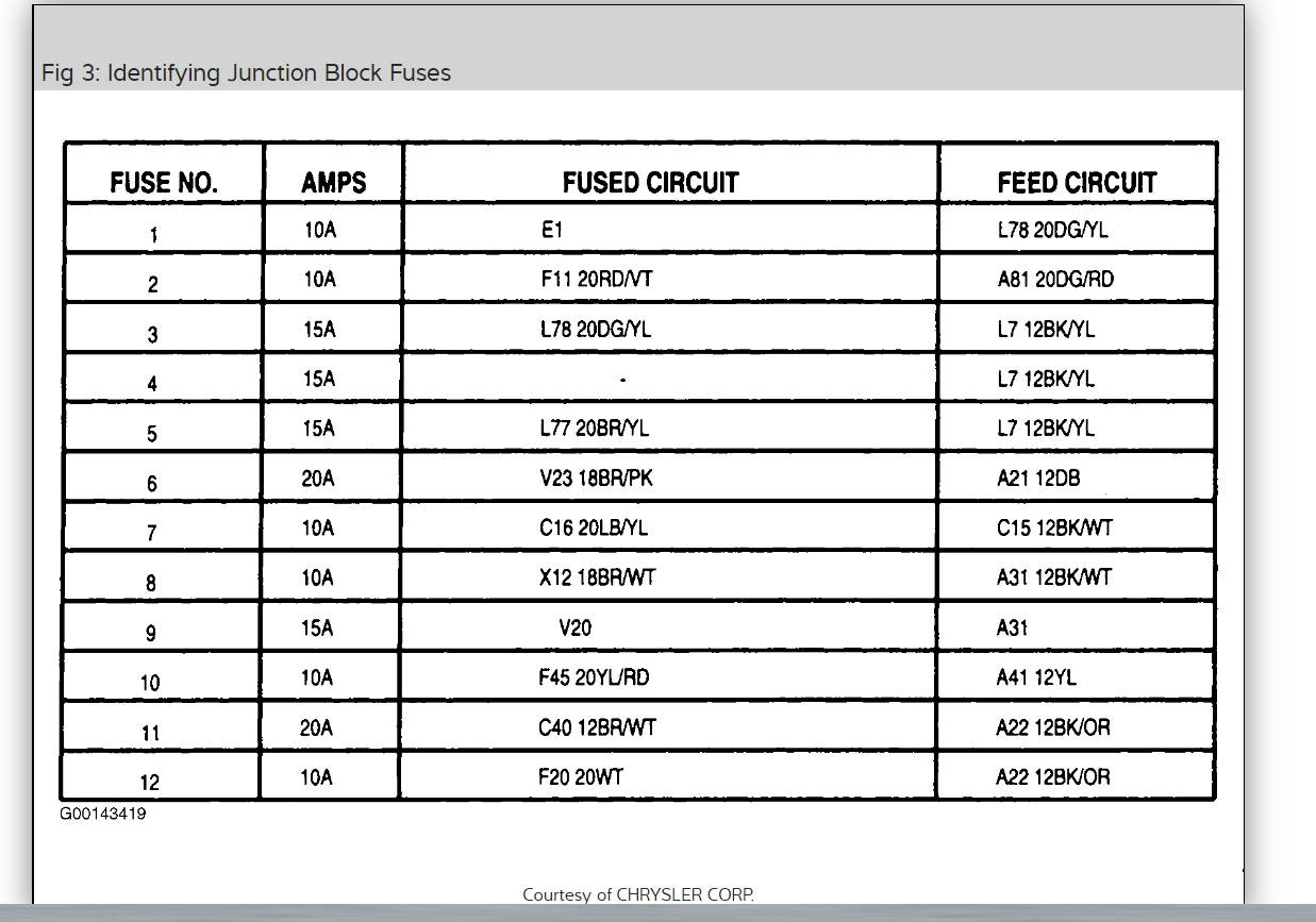

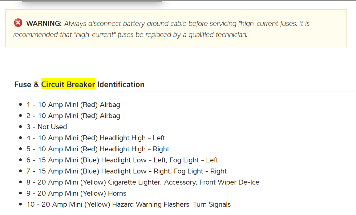

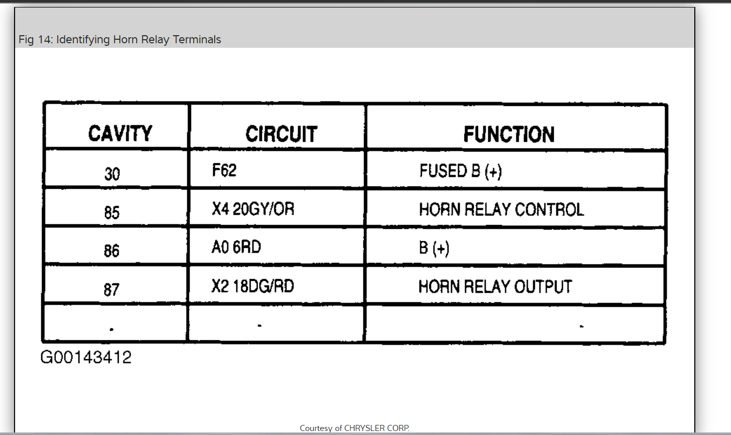

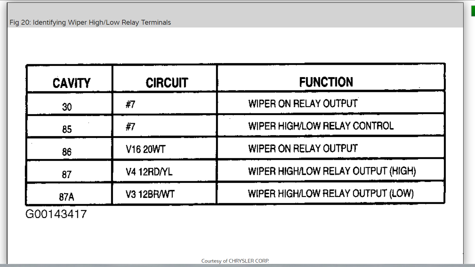

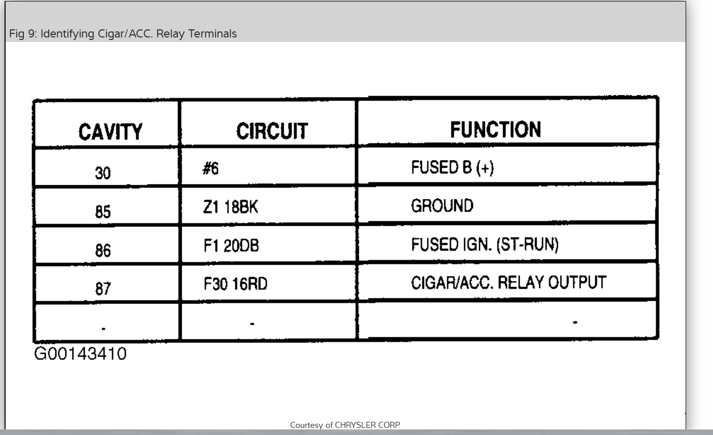

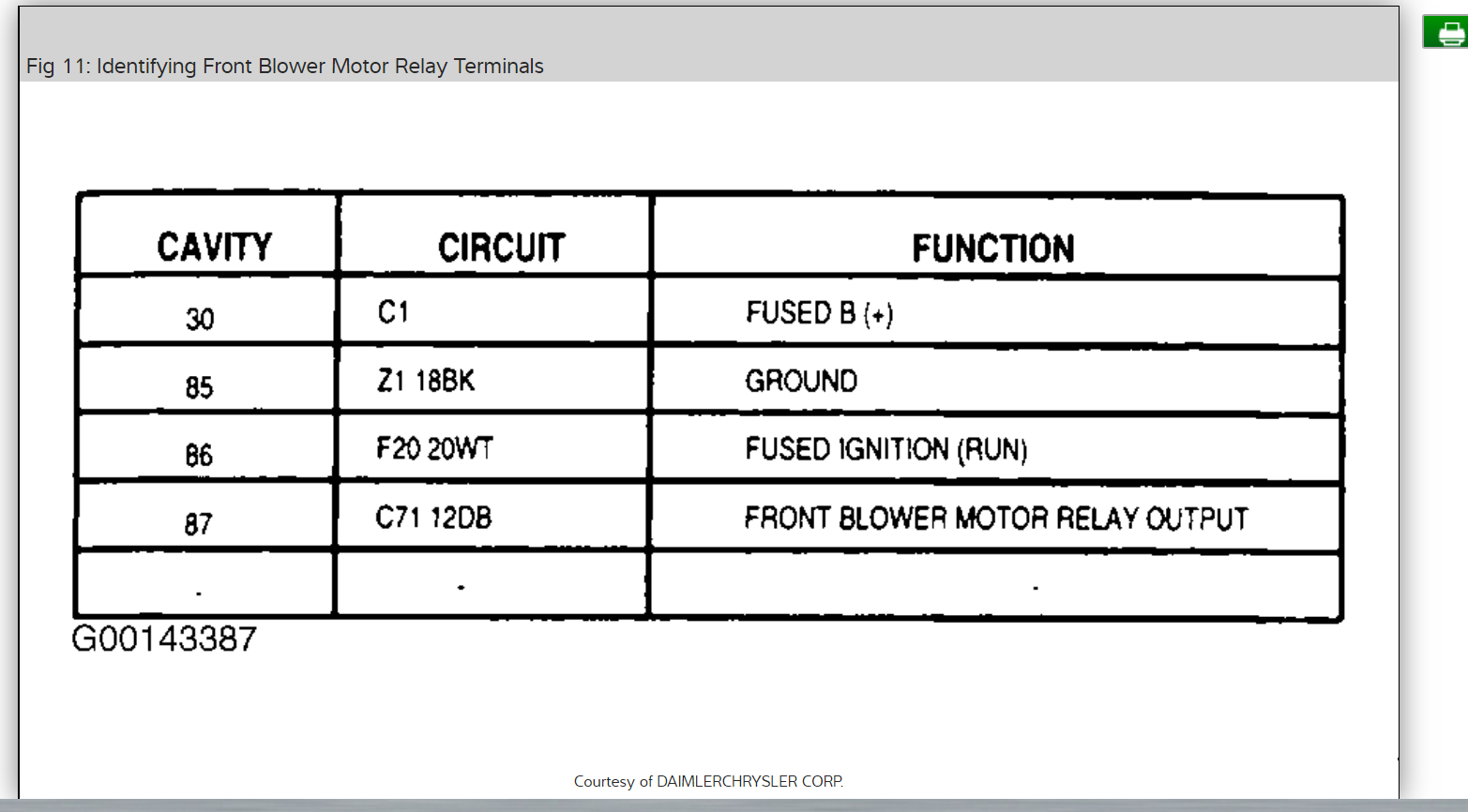

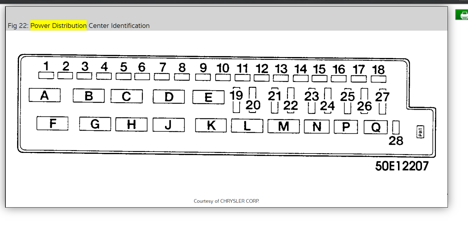

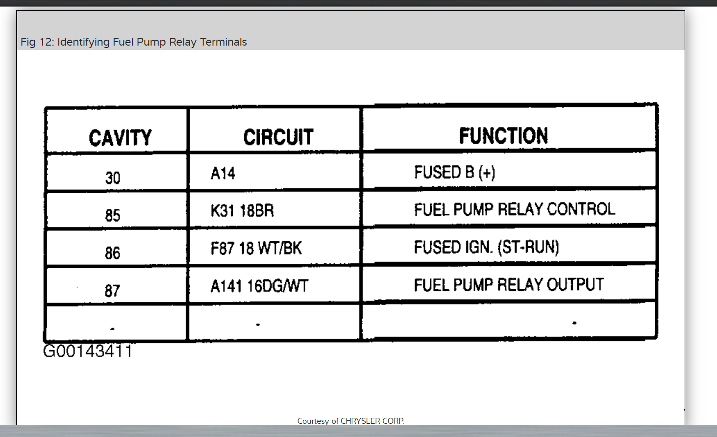

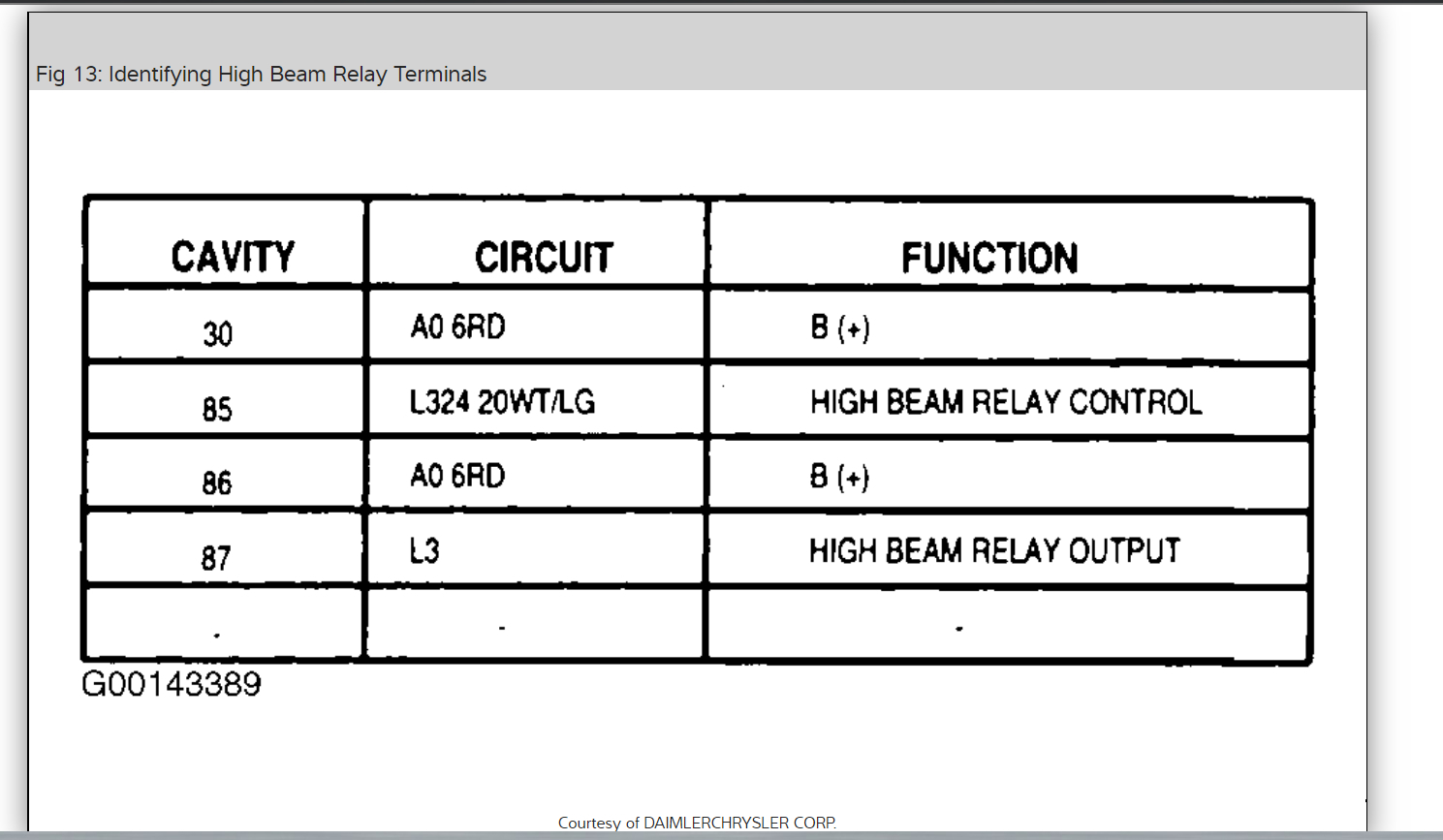

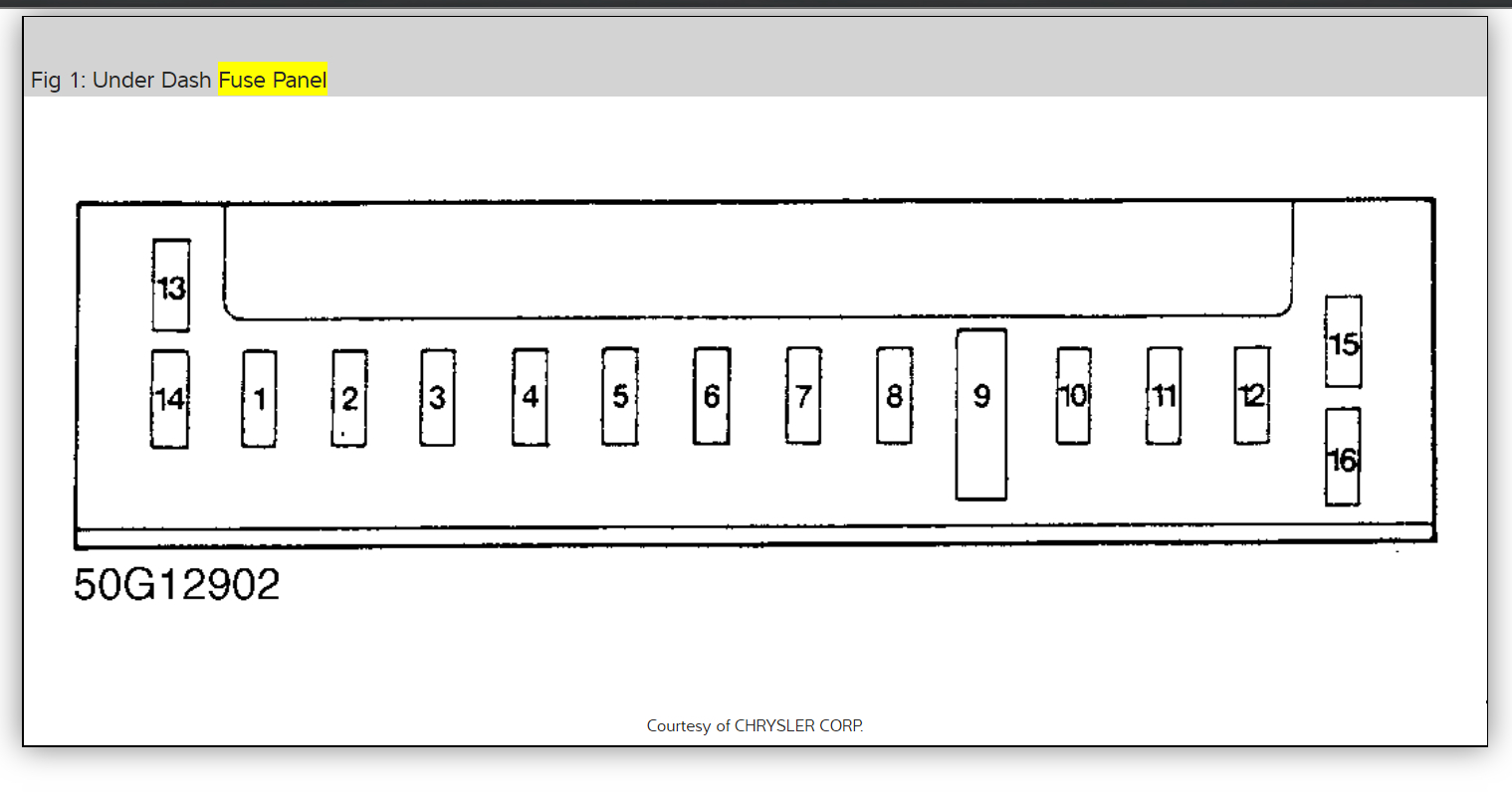

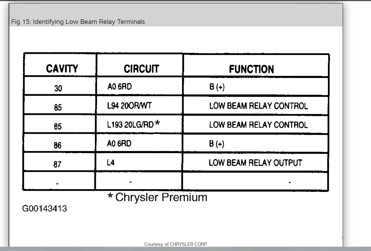

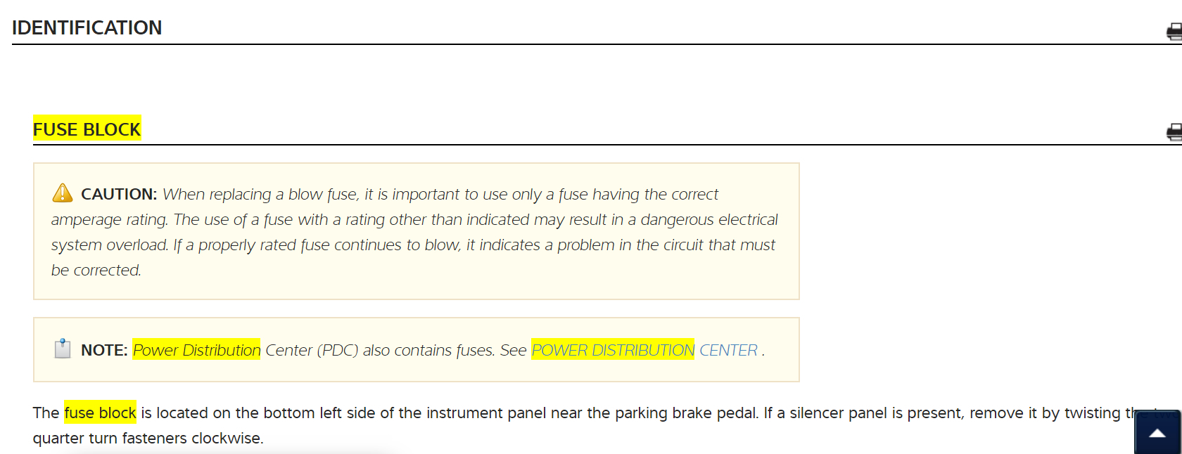

Power door lock triggers every minute or so, even when car is turned off, and drains the battery over time. Suspect bad door lock relay, but do not have a schematic of the junction control box. Need same with notations that identify the use of each of the PTC's, relays and fuses in the box to be able to continue with my DIY troubleshooting.
Jul 5, 2019 at 4:05 AM
SCGRANTURISMO
  • 4,897 POSTS

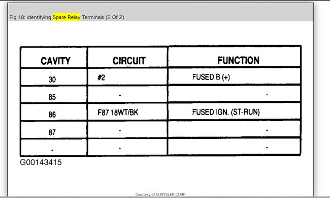

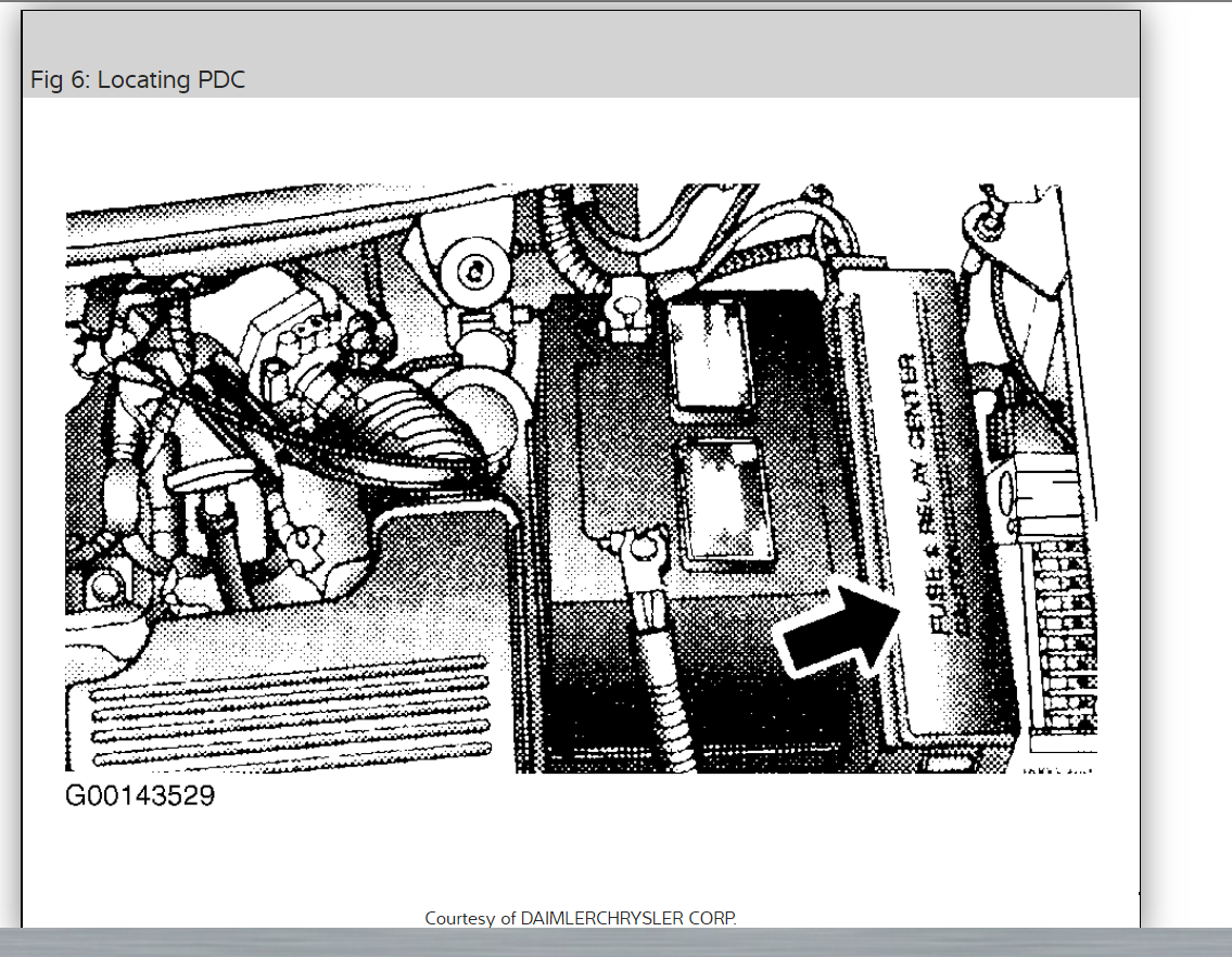

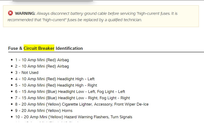

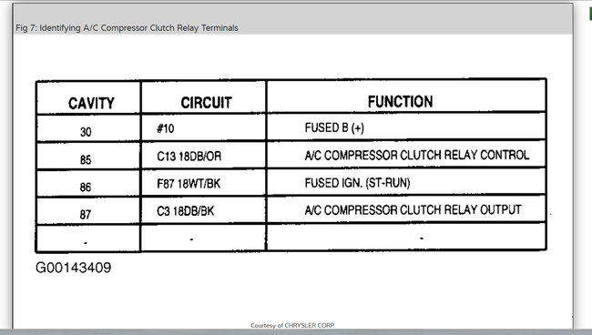

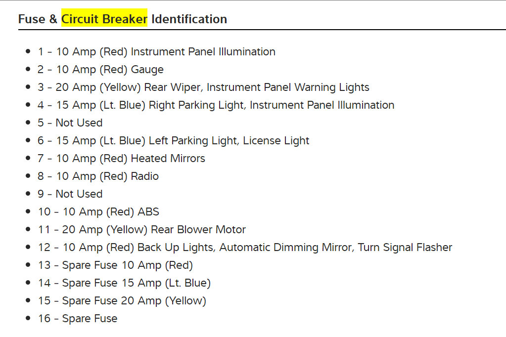

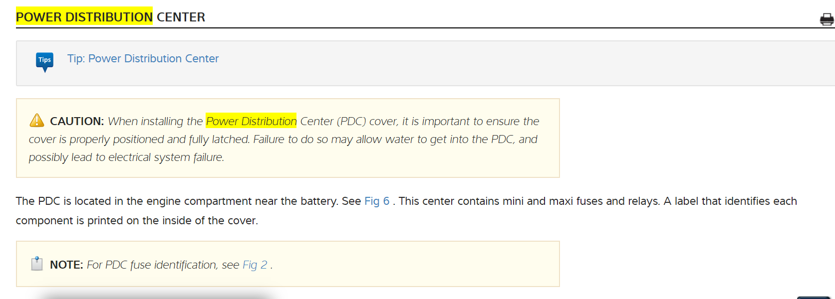

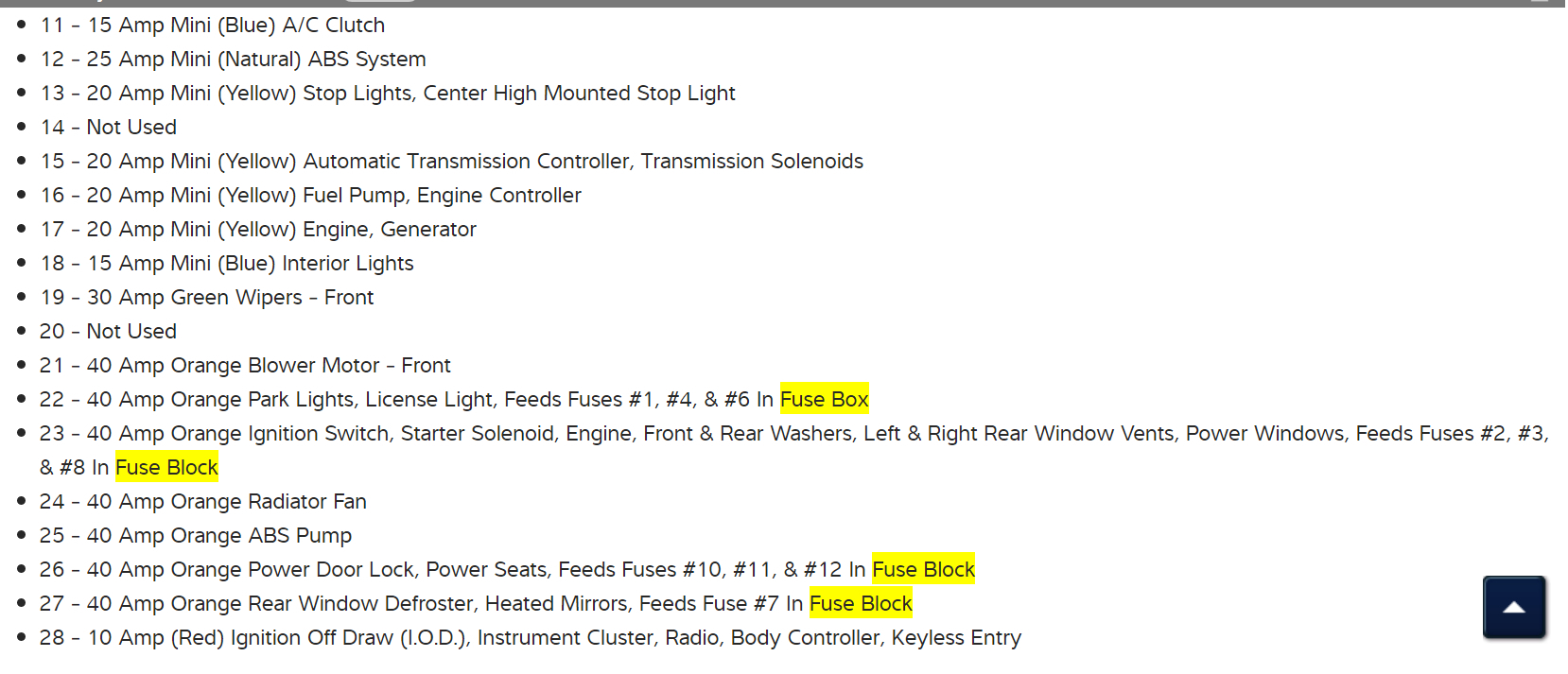

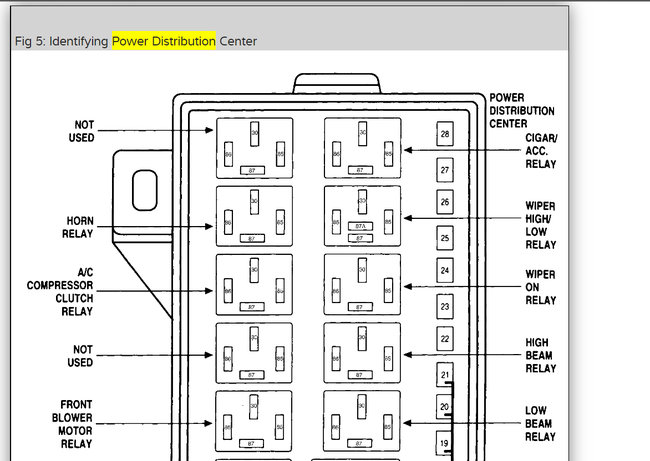

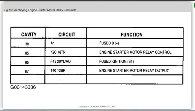

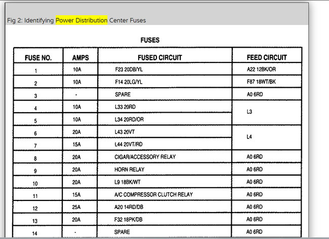

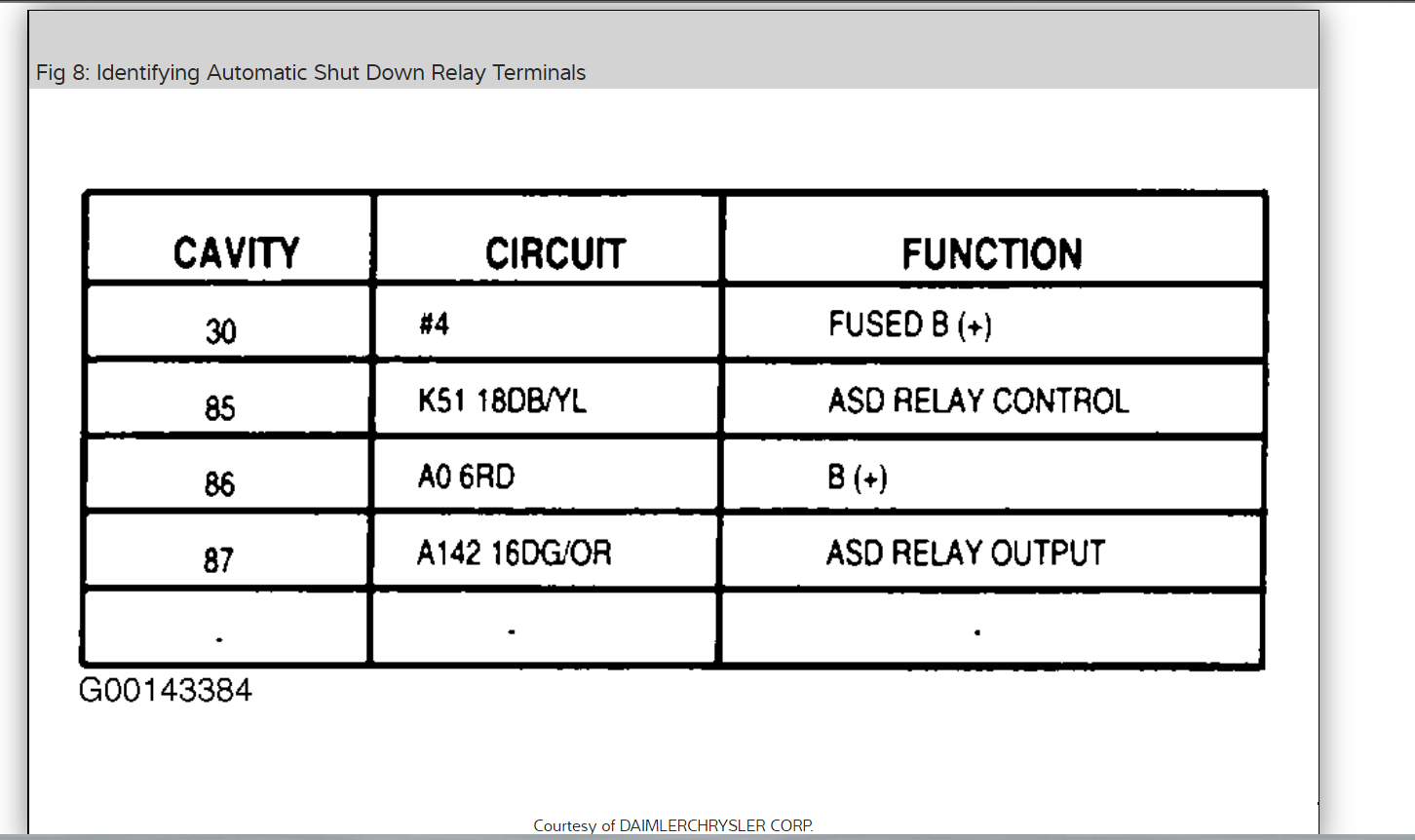

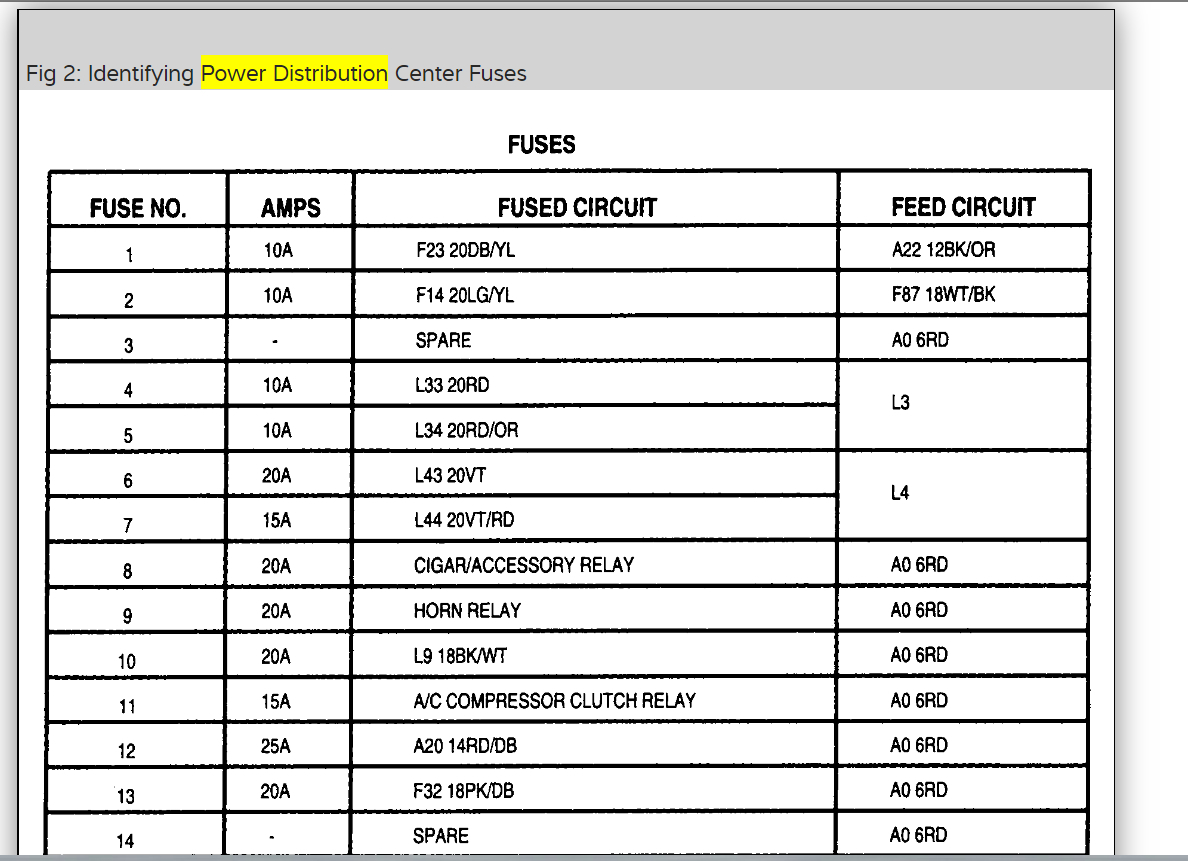

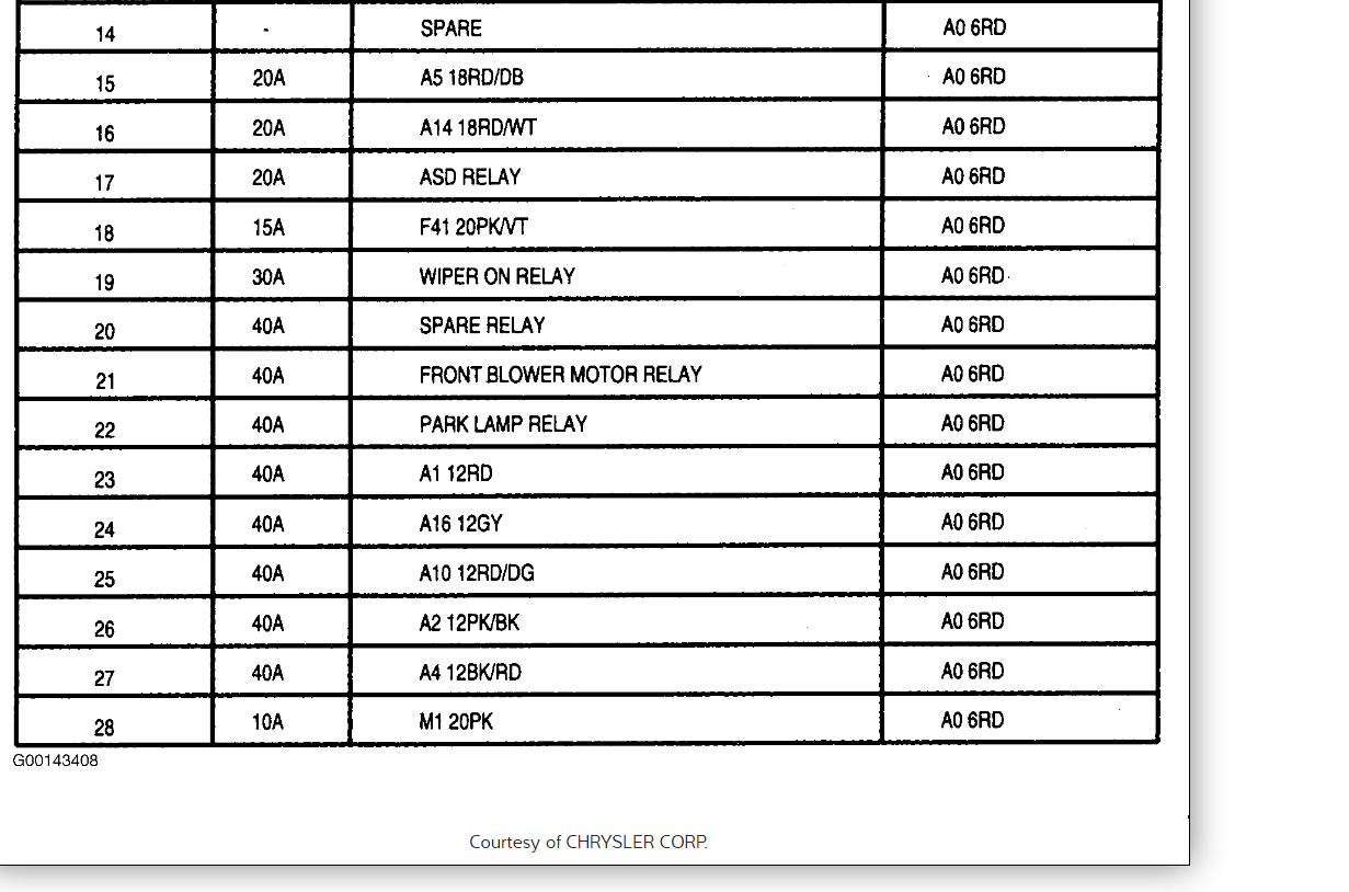

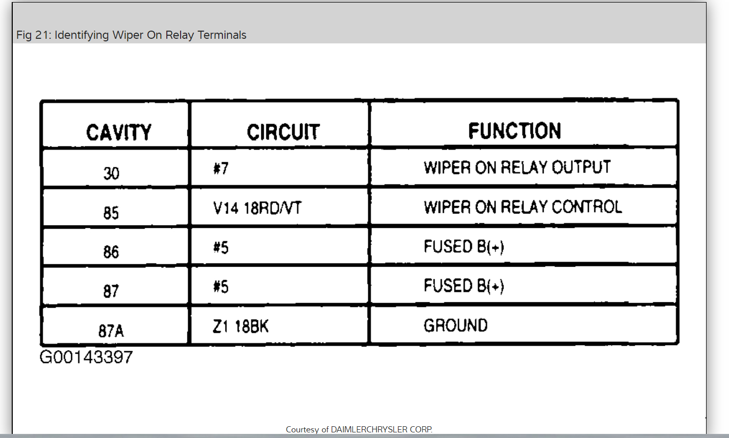

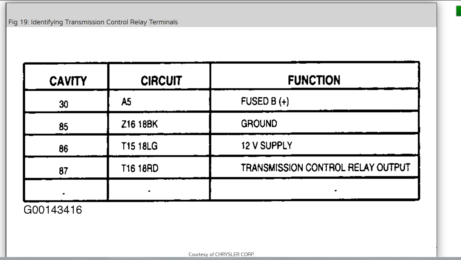

I have included the information that you requested in the diagrams down below. Please get back to us with how things are progressing, or if you have have any other vehicle related questions, please feel free to ask.
Thanks,
Alex
2CarPros
