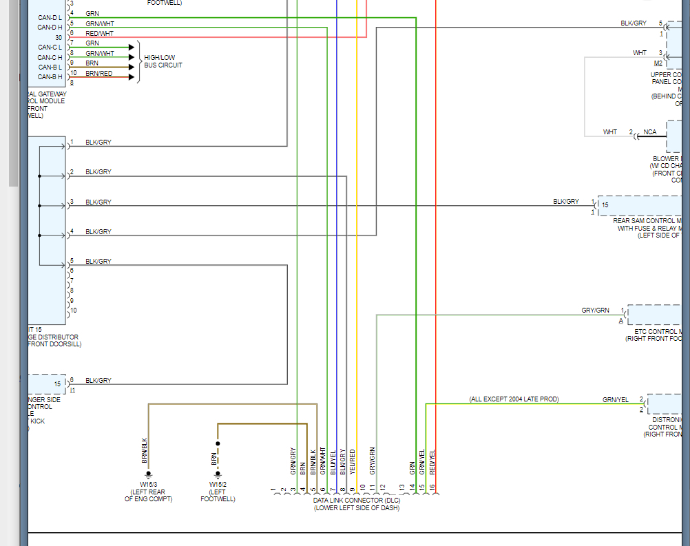

Car starts with a jump then will start. Alternator/starter warning, Brake warning,, Bad display warning.

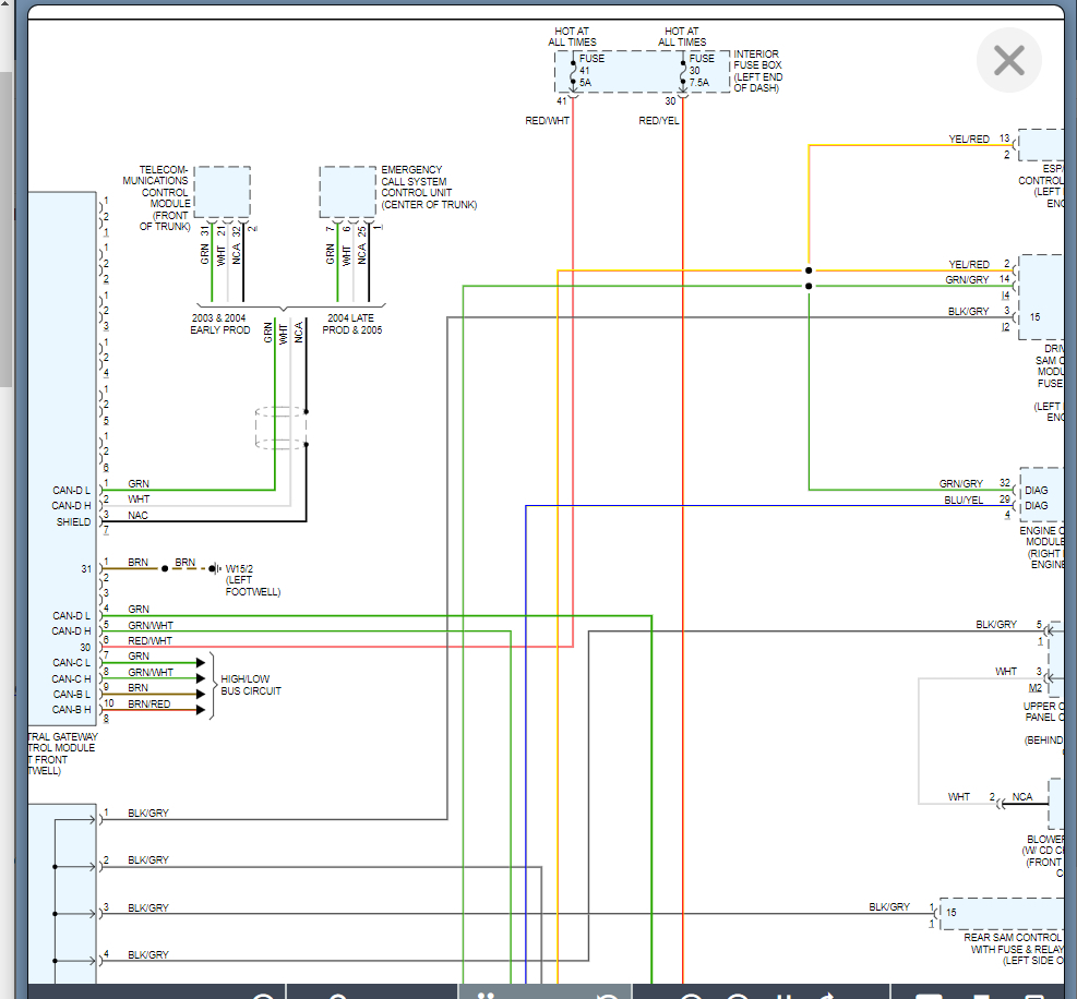

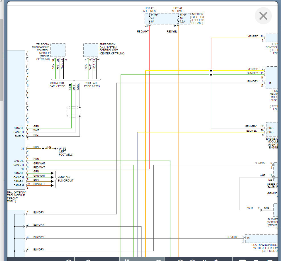

If you have a brake warning light that indicates an issue with the braking system which could just be low fluid or a faulty level sensor, or something different. There are not always codes with this light but based on the fact that you cannot communicate with the ECU, I am thinking there is more to this story.
Did you just buy this vehicle and it have these different issues or did this all of a sudden just start?
We need to start with checking for power at the DLC and make sure the fuses are okay. I proved the wiring diagram below but here are a couple guides that will help with this in case you need it:
Lastly, has this specific scan tool ever worked on this car prior? Basically we run into a lot of people that have a scan tool that will just not work with the vehicle that they purchase and so they assume the vehicle is the issue when it is a compatibility issue.
