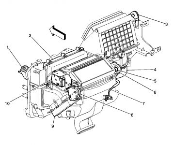

The fan blower works, but it doesn't produce heat.

It sounds like the blend door actuator isn't working right. If you feel comfortable enough and have a digital multi meter I can walk you throught the tests to make sure. Let me know what you would like to do and we will go from there.

Ok first you need to check the temperature door cable to make sure it is connected and not bend or bound up here is a pic of the heater system hope this helps let me know what you find and we go to the next step. The cable is number 7
https://images.2carpros.com/forum/automotive_pictures/249564_Graphic3_3.jpg
Feb 4, 2009 at 1:21 PM
GOODWILLTOALL
  • 13 POSTS
The temp door cable is secure and doesn't appear to be bent or bound up

Ok if you refer back to were the pic is you will see number 4 this is the blower motor. It looks rather easy to remove so unplug it and remove it now the door should be cable operated so there is no need to have the car runnig. Reach up in the hole and make sure nothing is in there that may have dropped down through the vents and then use the temp control and move it from cool to warm and see if the door opens and shuts all the way. Let me know what you find and we will go from there.

Ok if I understand you correctly you just romoved the air filter for the engine. The heater box is inside the car behind the glove box. So if you look under the dash behind the glove box you should see the blower motor looking down at you. If you look at the pic I send and will include again it is number 4. Let me know how it goes.
Feb 11, 2009 at 1:46 AM
GOODWILLTOALL
  • 13 POSTS
Hi Guys,
O.K. back on track...I unplugged the blwr mtr and removed it. reached up into the space and didn't find anything blocking. However, I moved the temp control knob back and forth and didn't see any difference up into the void. Although, sometimes when I move the temp knob I hear a faint thud in that area, but not all the time.

Ok that thud is the door shutting now you need to look at the cable and such as you move the temp control and see if anything is binding as you move it. When you do not hear that thud means that the door didn't move now the question is why. From what I can find on your system is sounds like the temp control module is not working correctly. This module controls the operation of the temp the door and such. Now when you put it to heat and you hear that thud then start the car and let get to operating temp does it blow warm or hot air then? If so then the Module is you problem. Get back to me with what you find.

I'm back. Took the SUV in, a mechanic said the heater hose(top one) was warm but the bottom one wasn't, He wants to replace the thermostat for $300. He didn't have a heater codes diagnostic tool. That didn't help I then replaced the temperature blend door actuator and it works great now. sorry for the run around I should have just done that to begin with.
