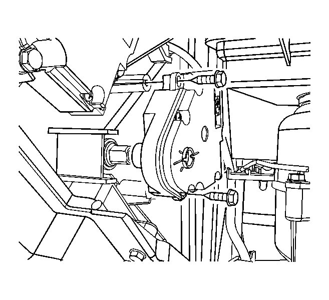

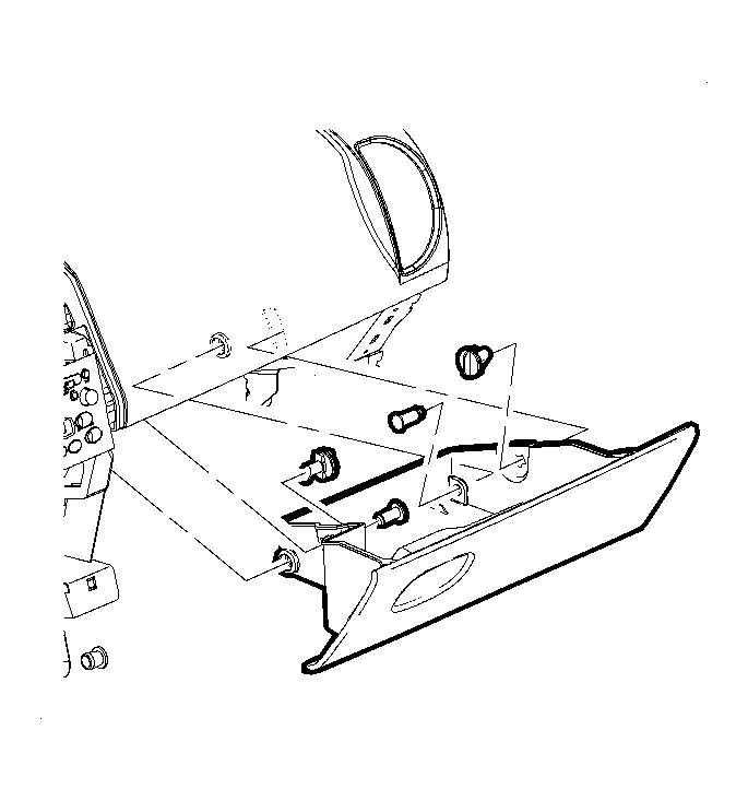

If the blend door actuator is the problem it is a simple item to change on that vehicle. Open the glove box, empty it out. At the bottom there are two pins that come out and the upper stop. Then you can reach in and see the blend door actuator on the side of the HVAC case. Disconnect the electrical connector and remove the two screws. Installation of the replacement is to just reverse the process. Much easier than bypassing anything and no mess.

Wow I never thought it would be that easy Steve! The last one I dealt with required the entire dash to come out. Of course that is assuming that the actuator is the problem, which it probably is.
