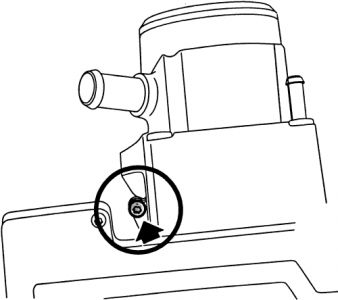

I had just replaced my spark plugs in my 2002 Saturn Vue and at first didnt know where they were. They are under the intake located in the top of the valve covers. To remove the inake you first take the air cleaner off then you will need a torx socket a T30 (male type) and it must be a 1/4" drive and you'll need a 6" 1/4" drive extension to remove the intake bolts there is 5 on the inner side of the intake down (inside of the holes) & one on the outside of the intake (by the throttle body) to be removed. there is no need to disconnect anything else, I just proped the inake up with a screwdriver while removing the coils (which are plugged directly into the plugs) then simply remove the plugs with a 5/8 spark plug socket and replace. plug your coils back in then put intake back on.

https://images.2carpros.com/forum/automotive_pictures/451479_bolt_outside_of_intake_1.jpg

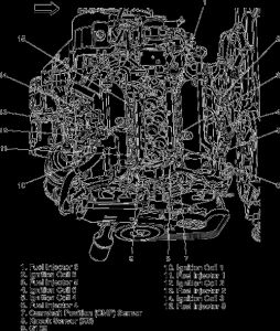

P) Once these 6 screws are loosed from the intake manifold you should be able to lift off the intake manifold (set it somewhere but be EXTREMELY CAREFUL TO NOT DROP CRUD DOWN YOU'RE ENGINE - I placed a rag over top of the cylinders in order to keep them clean from debris) and get at the 2 spark plug coil packs (one towards the front bumper and one near the windshield). There are only two screws holding each coil pack onto the engine and 1 electrical connection... undo these three and pull off the coil pack squarely (try not to teeter-totter it too much so you don't break the gasket) The two coils look like this:
P) there are 3 spark plugs underneath each coil pack (6 spark plugs total) You'll need a spark plug socket for your wrench in order to unscrew these and get them out... I believe mine was a 3/8 inch socket... you should be able to verify the diameter of the necessary socket at the store when you buy your 6 spark plugs.
