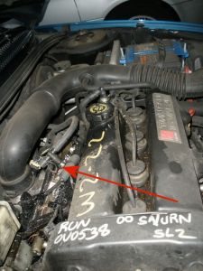

When I tried to start the car this evening, it did not start (typical problem, except it usual starts after a few hours, this time it sat about 12 hours). However, there's a new development: this time, gas leaked from beneath the engine area (please see attached photo. Photo taken from front right corner of car, feet in the background are standing next to driver door). When the key was turned I could hear the gas leaking. It took a few seconds for the gas to reach the bottom of the car and drip to the ground.

Let's fix the gas leak first I don't want to see you blow up. Can you see where the gas is coming from?You should be wearing safety glasses while looking for it gas really hurt's in your eye's.

Hose with a T fitting on top of the engine. See attached photo.

So is the plastic supply line leaking or the line it attaches too on the engine?
Sunday, August 1st, 2010 AT 12:16 AM
STEVER2003
Just the line that attaches it to the engine.
Sunday, August 1st, 2010 AT 9:48 AM
SATURNTECH9
  • 30,869 POSTS
So the one that comes off the tank? Or the one that the one that comes off the tank Attaches too?Can you why it's leaking?
