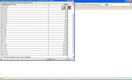

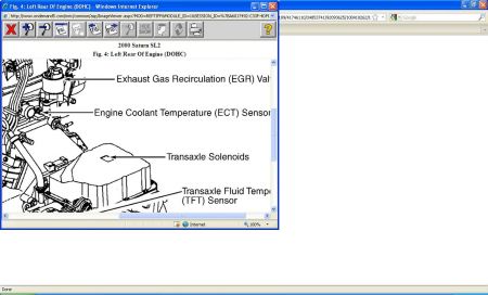

Yesterday I had the cruise set on 70. The car slowly sped up by itself, and when it hit about 77, i heard a click and the car slowd down. I pushed resume and it set at 60. I sped back up to 70 and pushed set, and heard a loud noise in front of me, the car instantly slowed down and started driving odd, and i smelled an odd smell. A couple hours later when i started it, it would not stay running unless i gave it gas, and it tried to die at stop signs. today, same thing.

Go to a auto part's store like auto zone and have them scan your car for code's if you have any let me know what the number's are.

my dad has a scan tool and no codes come up

https://images.2carpros.com/forum/automotive_pictures/416332_1998_SL2_coolant_temp_sensor_test_part1_1.jpg
https://images.2carpros.com/forum/automotive_pictures/416332_1998_SL2_coolant_temp_sensor_test_part2_1.jpg
Use the diagram to find the coolant temp sensor and use a ohm's meter and the chart for resistance to test it.Let me know what you find.
