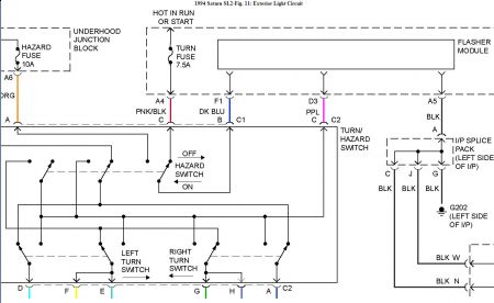

Four way flashers will not work. Turn signals fine. All Lights seem to work okay. Turning on 4 way disables turn signals. 4 way and turn signal share same flasher module. Replaced module... Still have buzzing from module. Could it be that there is an incorrect type bulb in the system? If yes can you tell me bulb numbers for front and back? I do not have owners manual.
Thanks for your help.

Not sure what a "Certified Mechanic" is going to tell you if they are working...but.... On the bulbs, Front ones should be 3157 and the rears should be 1156, from the info I have. I think this is a bad switch that you have going. The bulbs are just outputs. We have had luck in "reviving" a switch by rapidly turning on and off the hazard button. Not always, but nothing to lose.
https://images.2carpros.com/forum/automotive_pictures/30961_sat_3.jpg
