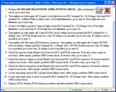

I do not have an ohlms meter. I just rented a diagnostic tool and it will not connect to the computer. So I am startng to wonder if the guy that worked on my car completely f'd the wiring harness. >_>

So since ur car has been worked on it hasn't started?Does the code reader u rented have a battery in it or does it power up off the car?If it powers up off the car does it power up?Check all ur fuses inside and outside let me know what u find.

That is correct it ran great before hand. It is powered off of the car and works, but will not connect to the car. Just says error will not connect.

Thats normal for those fuses to not have power there for a automatic transmission anyways even if u had a automatic transmission they still wouldnt have power till the pcm commaned those gears.lets go with ur code cant talk to ur pcm here is a trouble tree for u to follow for a car that u cant talk to the pcm let me know what u find.
http://www.2carpros.com/forum/automotive_pictures/416332_1996_no_com_with_pcm_1.jpg
