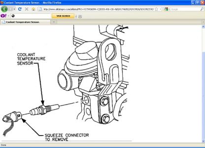

SATURNTECH9
  • 30,869 POSTS
Your on the wrong end not by the spark plug's you want where the go on the coil's take two of those wire's off that are right next to each other and have someone crank it when it doesn't start and see if spark jump's from post to post.Also from the sound's of it i would suspect you have a bad coolant temp sensor there only 10 they go bad all the time make sure you get a brass tipped one the plastic tipped one's crack.There is two of them you want the bottom one with the two wire's going to it.All you have to do is squeeze the connector to release it.Also inspect the connector if it's corroded then replace the connector too.Make sure the engine is cold you will loose some coolant.
https://www.2carpros.com/forum/automotive_pictures/416332_1993_sc2_coolant_temp_sensor_1.jpg
