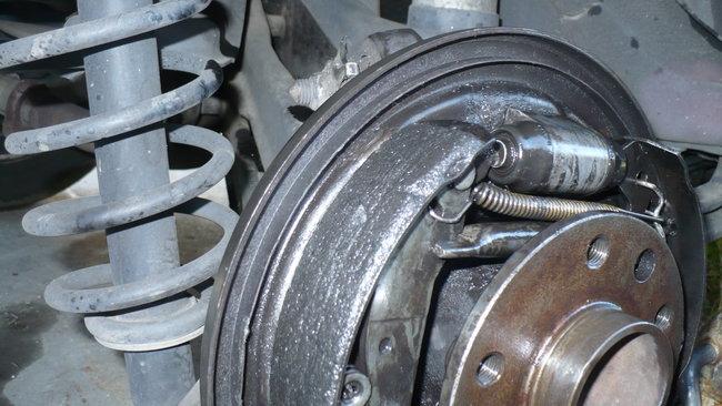

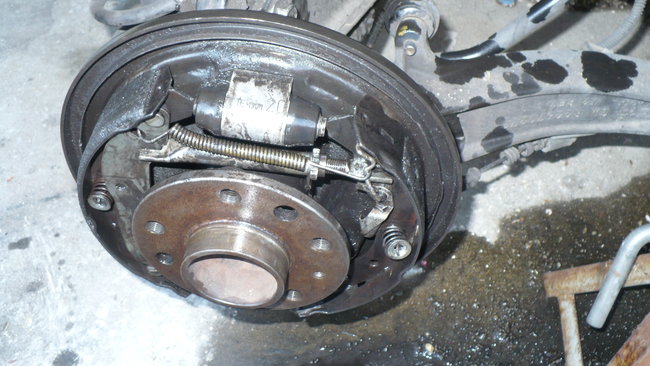

When I press the brake, with the drum on, the front piston pops out and leaks. I observed the tendency for the front shoe to get behind the piston but that did not happen this time. I also checked that the bottom of the shoes are fitted inside the plate at the bottom.
I replaced the cylinder with a known good one and the same results.
I successfully did this job a few months ago but must have left too much drag because the shoes on that side burned up. The soes are also nearly worn out and the drum is terrible.
I have new drums on the way and shoes to install but I don't want to use them until I get to the bottom of this problem, otherwise I will contaminate another set of shoes.
I am of course cursing Saturn for not providing slots in the pistons to securely hold the shoes, but that gives me no solution..
I know it was working fine until the original shoes wore down. There was no trouble other than grinding.
Anyone suffered through this can help me? I have worked on it for two whole days, trying everything but new shoes.
Notice, in the pictures the adjuster piece is not engaged as it should be, but this is not the problem.

The travel on the pistons are designed to hit the end of their travel when the shoes are at their minimum. So when you run all the brake material off the shoe and then the metal on the shoe wears away the drum the travel increases because the drum diameter has gotten bigger. Make sense? Because the diameter got bigger the piston falls out.
You should be fine when you replace the drums and shoes.

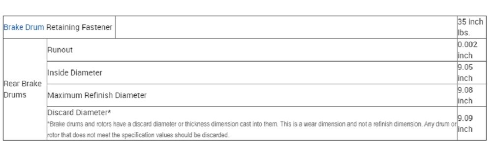

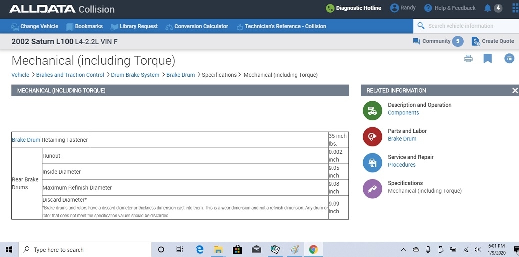

The first thing to suspect is the drum is worn beyond the legal limit, especially if it was grinding. There is always a published maximum diameter the drum can be machined to, and another slightly larger diameter it can be allowed to wear to. Those are called the "machine to" spec. and the "discard" spec. You'll need a special drum micrometer to measure them accurately. Don't waste your money on buying one. Every auto parts store that offers drum and rotor machining will have one and they will check your drums for free. No reputable mechanic will machine a drum or rotor beyond the machine-to spec to try to save it. That can leave them open to a lawsuit or liability issues. For that reason, all independent repair shops that offer brake service will have this gauge too.
The second chart below is just a blown-up copy to make it easier to read. While it isn't listed this way, drums and rotors are measured to the thousandth of an inch. Yours started out at 9.050" when they were new, and they can be machined to 9.080", which is only 0.015" per side. That is a fairly standard amount although many larger drums can be machined quite a bit more. Your drums can be allowed to wear another 0.010" to a total of 9.090". Once they get bigger in diameter than that, the shoes' diameter will prevent them from making full contact until the center of the lining wears down a lot. That leaves you with a front-to-rear brake balance considerably different than what was carefully designed in.
It takes a lot more wear on the drum to allow a piston to pop out of the wheel cylinder. A better suspect is the shoe frame is moving out far enough to let it drop down into the "labyrinth seal". That's the curved groove around the outer edge of the backing plate. The drum has a matching groove. When those are assembled, they form somewhat of a seal that prevents water from splashing in.
Look at where the piston is sitting in relation to the shoe. If the piston is away from the backing plate, meaning you can see it in front of the end of the shoe it's supposed to push on, the shoe has dropped into the groove and is allowing the piston to bypass it. If the piston is behind the shoe, the better suspects are worn shoe hold-down hardware or weak shoe return springs. All of those springs and hardware are available as a complete kit for the entire axle.

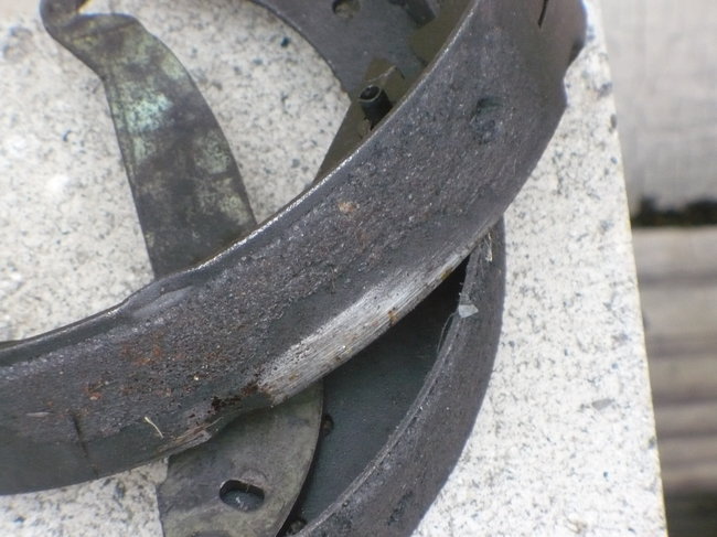

Your comment about the old shoes burning up concerns me. There's two things I would be looking for. The first is if a parking brake cable is stuck in the partially-applied position. Given the age of the vehicle, if you live in a northern climate like I do where they throw a pound of salt on an ounce of snow, rusted cables are pretty much a certainty unless they've been replaced previously. A stuck cable will also prevent the self-adjuster from operating. Over time, instead of adjusting closer to the drum, the shoes will have to move out with a longer stroke to reach the drum. With sufficient wheel cylinder wear, that can allow the piston to twist enough for the shoe to slip off the end. Once that happens, there's nothing to hold the piston from being pumped out when you press the brake pedal.

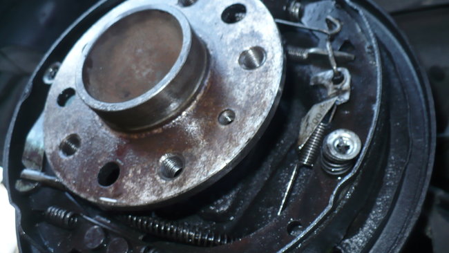

Tell me if I have this correct. It is a passenger side wheel. What I want to know is exactly how the self- adjuster works. It seems to dial the star wheel downwards to expand the drums But I am confused about this. Does it turn the star wheel down or up? If up, then no wonder I can't adjust it right. If up, then I must have the wrong side adjuster. I know that it is what was there originally because I did one side at a time. But maybe somehow it was set up with the wrong side adjuster yet worked.
Also, the adjuster does not reach the star wheel in all positions. Maybe because of she/drum wear, my self adjuster is out of range. Maybe by ignoring this and adjusting until tight, then loosening it until the wheel spins free, I will then have it so the piston does not pop out and the brakes "work" --if non adjusting. Only then will I have the confidence to put in the new drums and shoes when they arrive. I will also be able to drive the car in the meantime.
In addition to the correct direction of operation of the adjuster wheel, (down stroke or up stroke?) another clue that would help me is where the self-adjuster trigger is supposed to be in range of the star wheel when working with new shoes and new drums? -If I can see that I will know I am on course.

Next, Both adjusters work if you are under the car looking at the dust plate you want to rotate it top to bottom or in a down motion to tighten them. I personally do not recommend putting the drums on and adjusting them as it is too easy to over adjust them. If you adjust them and slide the drum on after it is much safer. To do it this way you want to keep adjusting them a bit at a time and keep sliding the drum on to check them. Keep doing it until the shoes drag on the drum as you put it on and once it all the way on you should feel it dragging just a bit if you rotate the drum. If the drum goes on stuff and then spins freely once on then you only need 2 to 3 clicks of adjustment from the back. you will have to do this when a groove is worn in the drum on the next set of shoes. With a new drum no back adjustment is required as there is no lip on the drum. You generally want to do it this way all the time anyway cause its much faster to spin the adjuster with your fingers than to do it from the back.
If the lever does not reach the adjuster then the adjuster is in backwards.

The old front shoe, which I will also photograph is in two months worn down to metal and after soaking with brake fluid, the brake spring tool dug a hole in it it is so weak and porous. I guess that without asbestos the engineers are up against it. Great car! (S.O.B.s).
