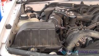

Fan does not come on sometimes but I hit a bump or slam the door or shut the hood and it comes back on.
Once I just hit the air filter compartment under the hood and it began to work. I can go down the high way turn on the ac then open or crack a window it will start to come on.

sounds like u have a loose connection to the blower motor or maybe a open terminal if u unplug the blower motor u can look at the terminals and see if they look tightor have a gap which would mean u would have to bend it back in place try wiggling the connector around to see if it comes on.also u could have a bad motor and when u hit it it comes on temporally.make sure u have power and ground to the terminal side when the switch is on.let me know what u find.
