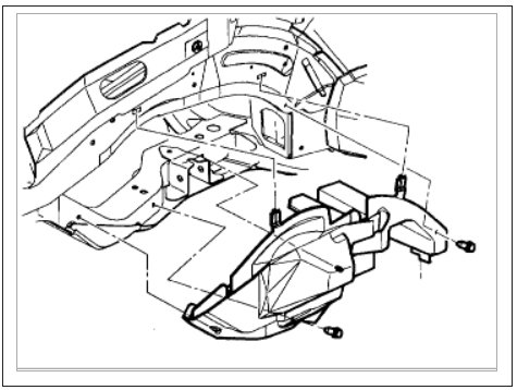

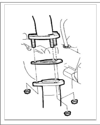

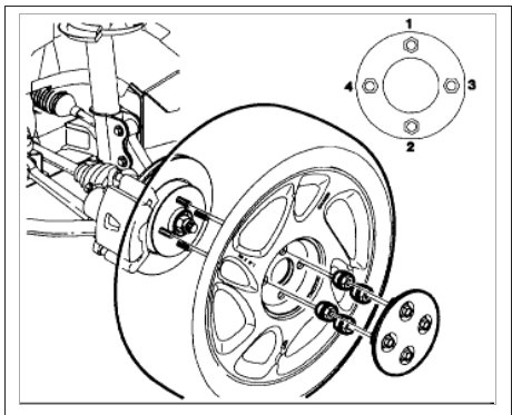

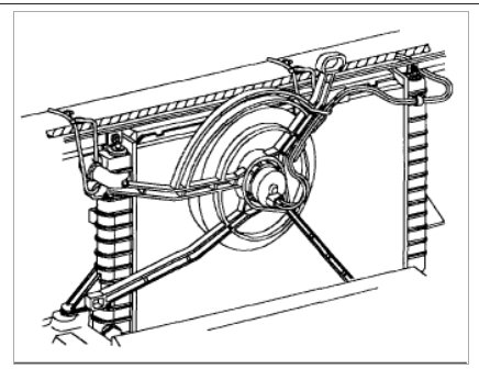

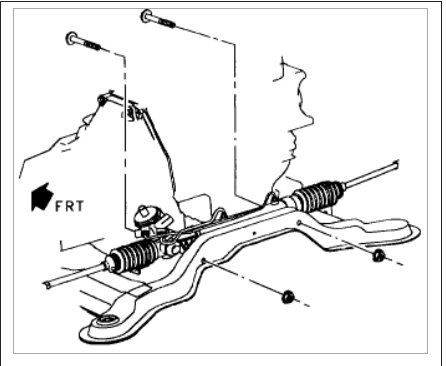

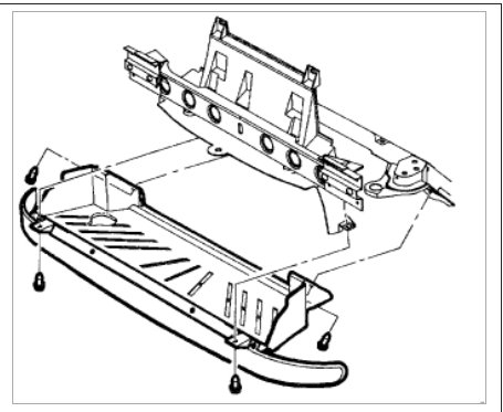

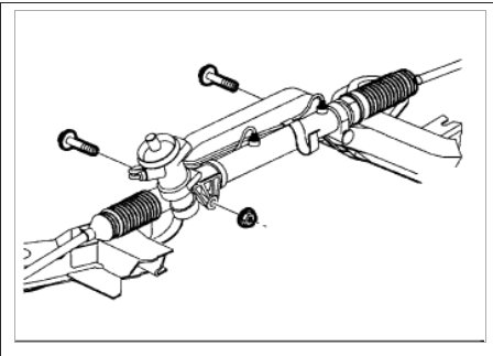

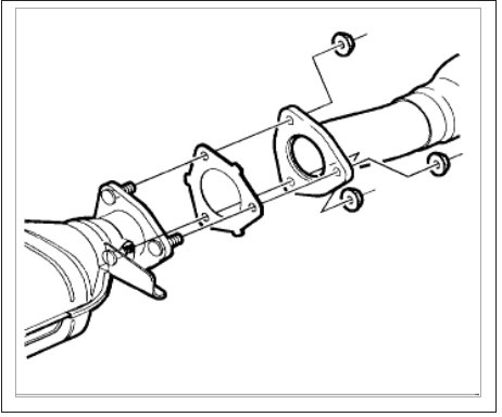

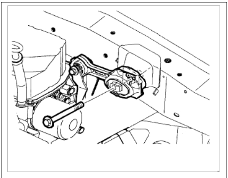

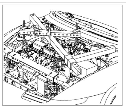

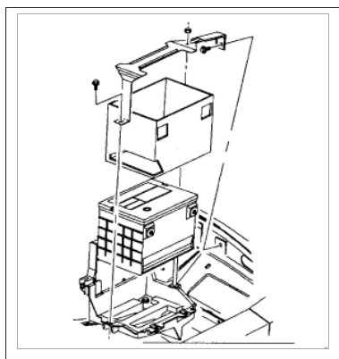

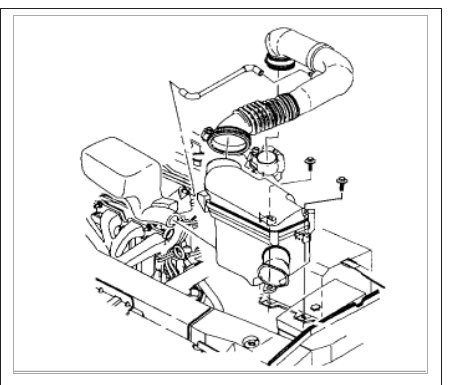

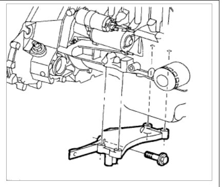

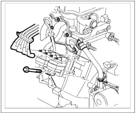

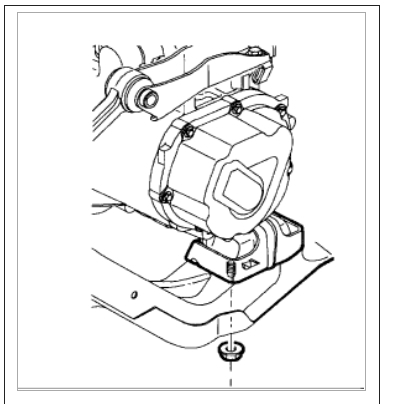

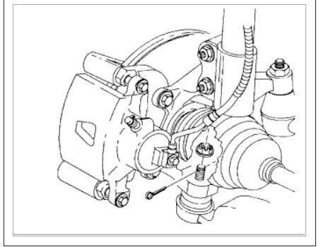

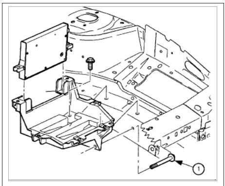

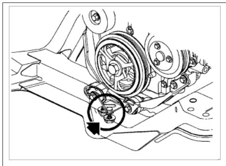

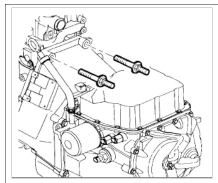

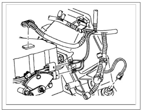

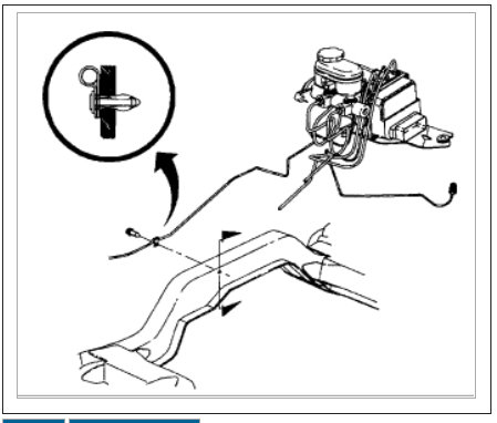

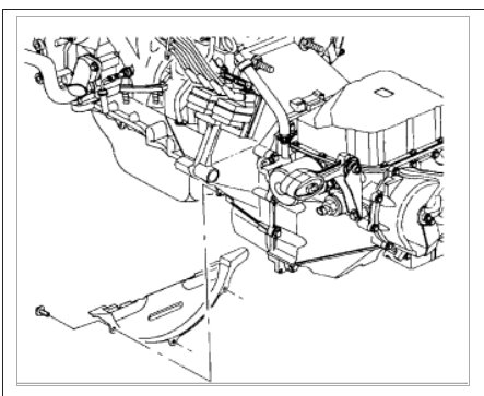

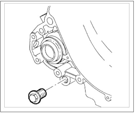

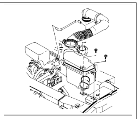

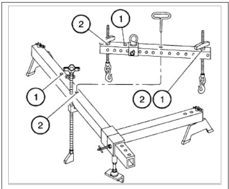

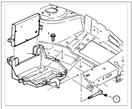

It sounds like you lost the reverse clutch pack seal which will fail to build pressure. You will need a used or rebuilt unit here is how to remove the transmission.
Mar 14, 2018 at 5:18 AM
Suggested Repair
The reverse clutch pack seal has likely failed and cannot build pressure. Replace the transmission with a used or rebuilt unit.
