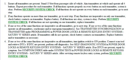

I have a 2001 SL1 Saturn,49089, 4 cylinder. The Security sysytem/ Remote Keyless Entry will not open or lock any of the doors. When I start the car ,I can hear some clicking sounds. How do we repair this?

If the remote doesn't operate the locks, but the key starts the engine, the dealer will have to set up the remotes again! This is what you can do at home...
https://images.2carpros.com/forum/automotive_pictures/62217_Keyless_trans_copy_1.jpg
https://images.2carpros.com/forum/automotive_pictures/62217_30961_mitchell_2_34.jpg
